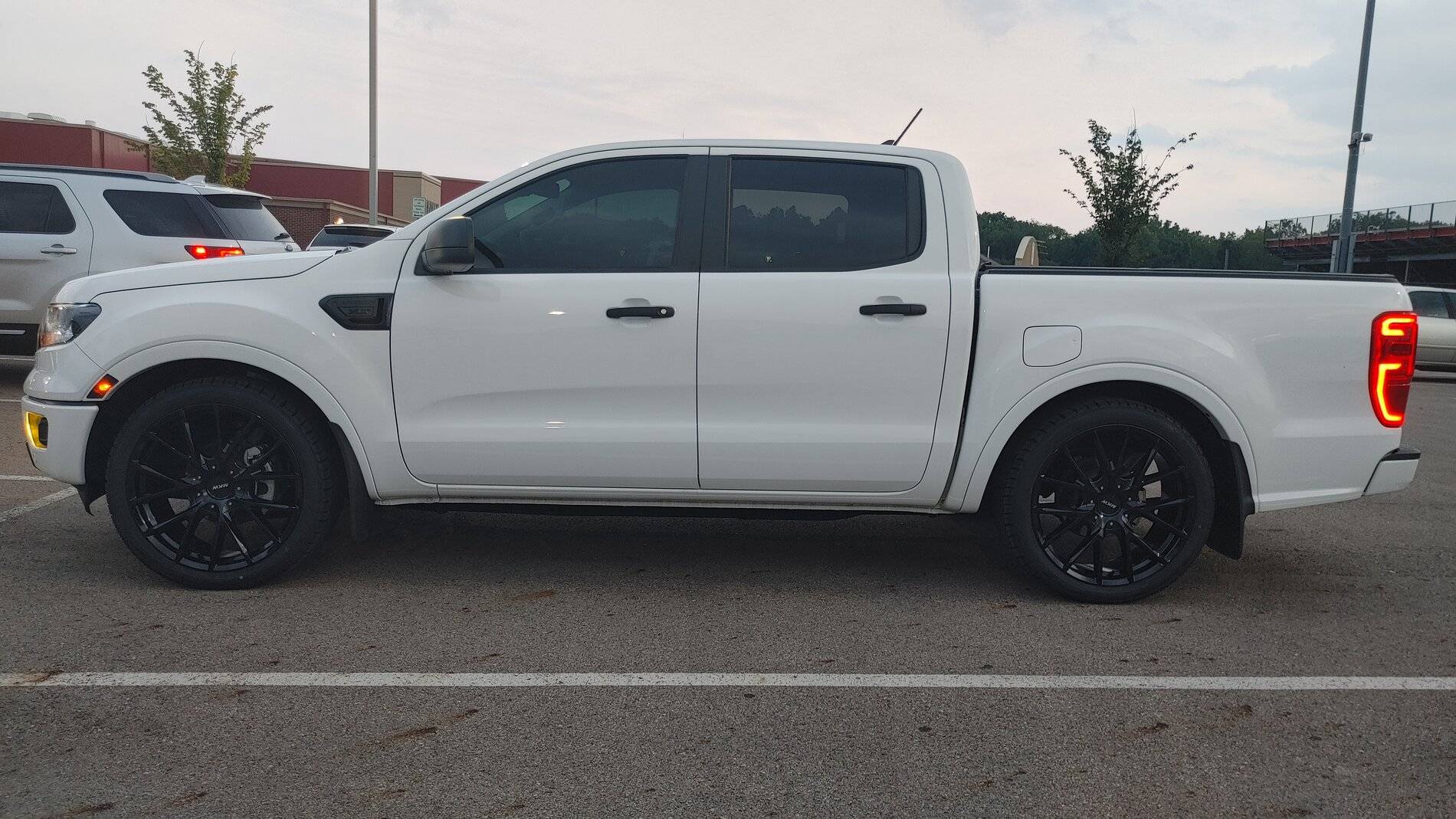

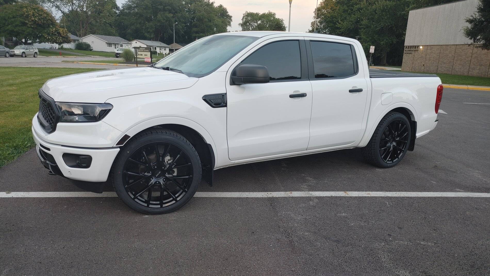

I did the belltech kit on 4x4 and 22s
I assume that's the maxed out 2"/4" drop, which from what I've been hearing is more like 2.75"/6"? What size tires are you running? I plan to use 20x9 wheels, but I do like that gap between your tires and fender lips :)

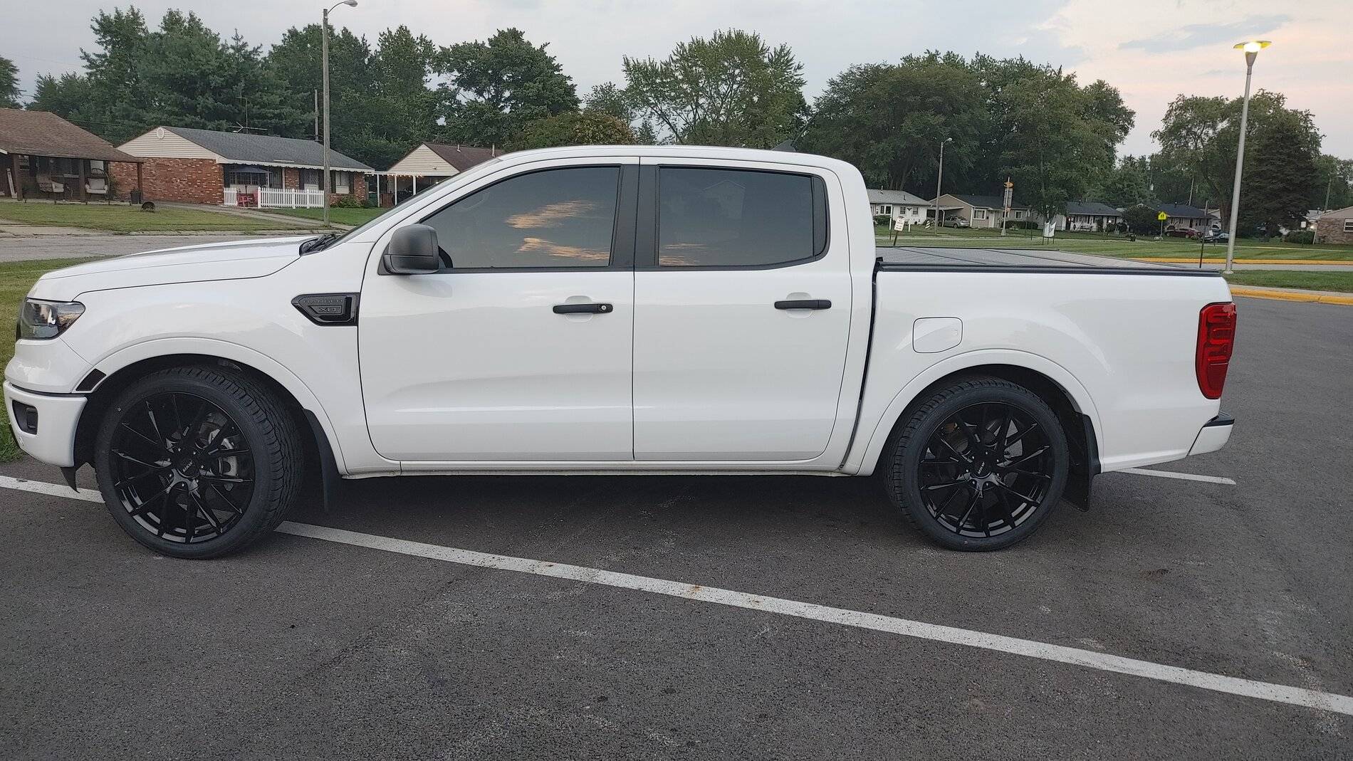

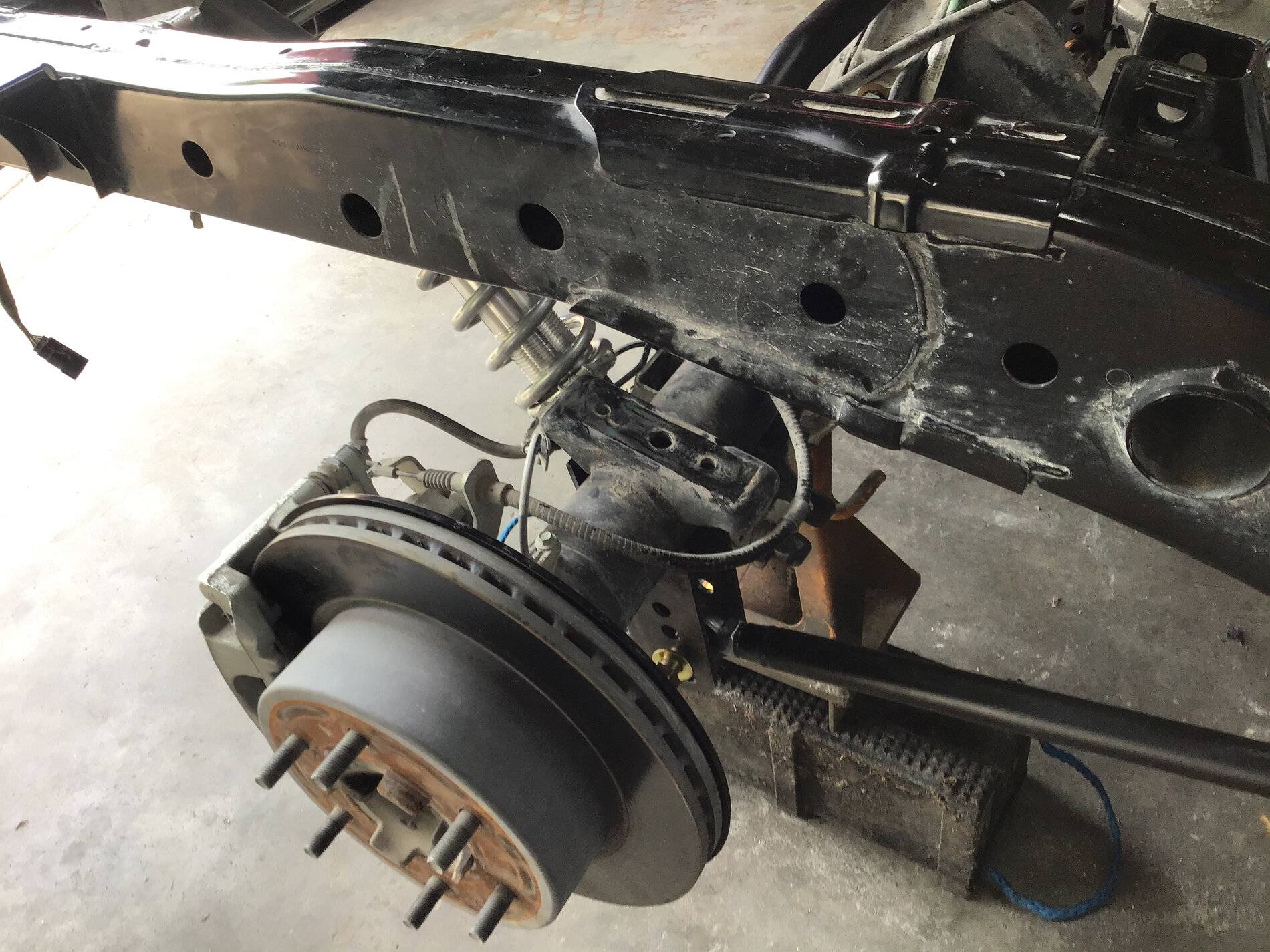

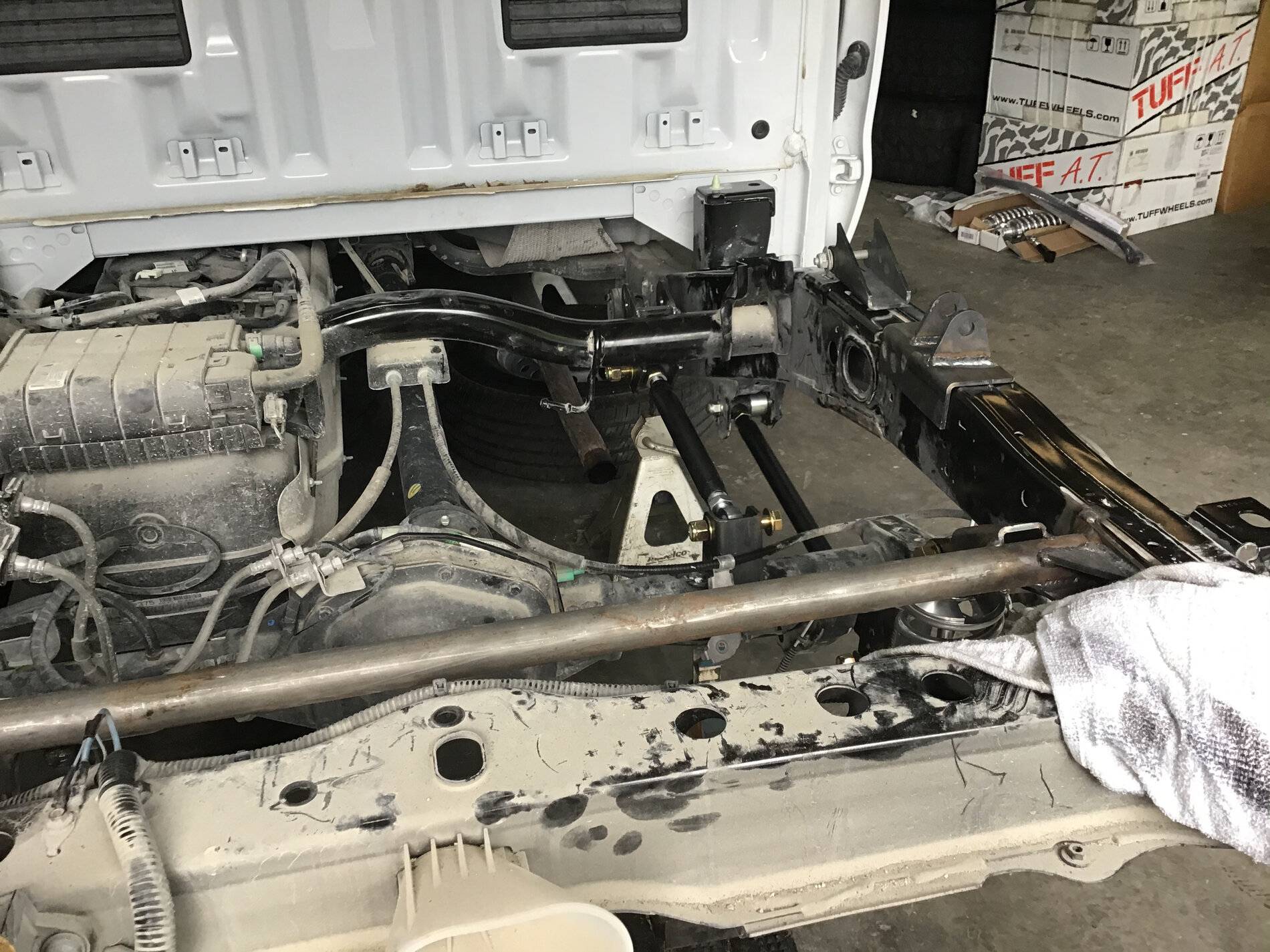

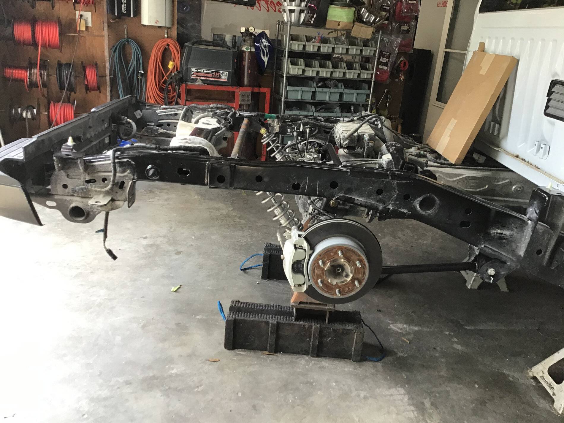

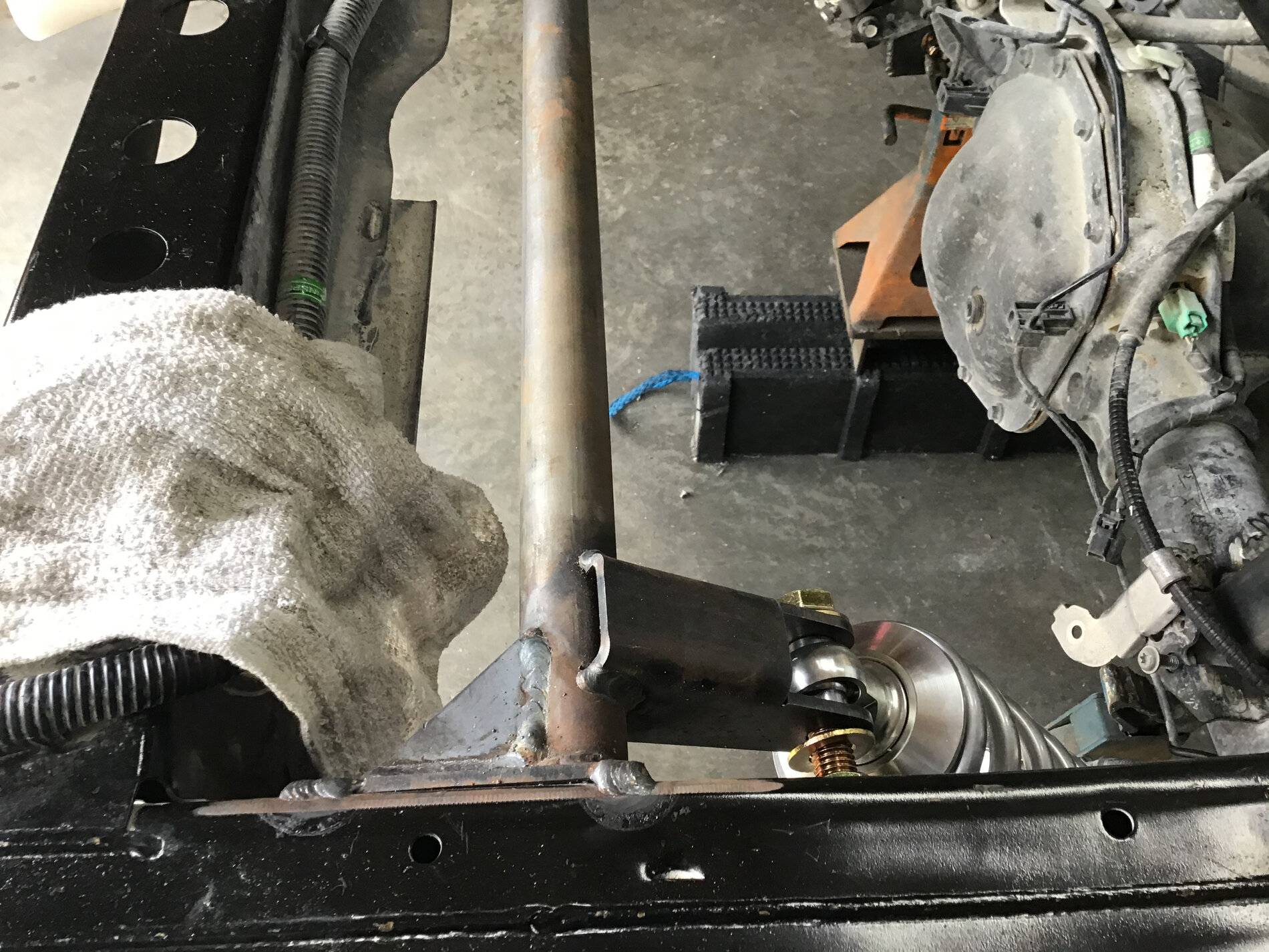

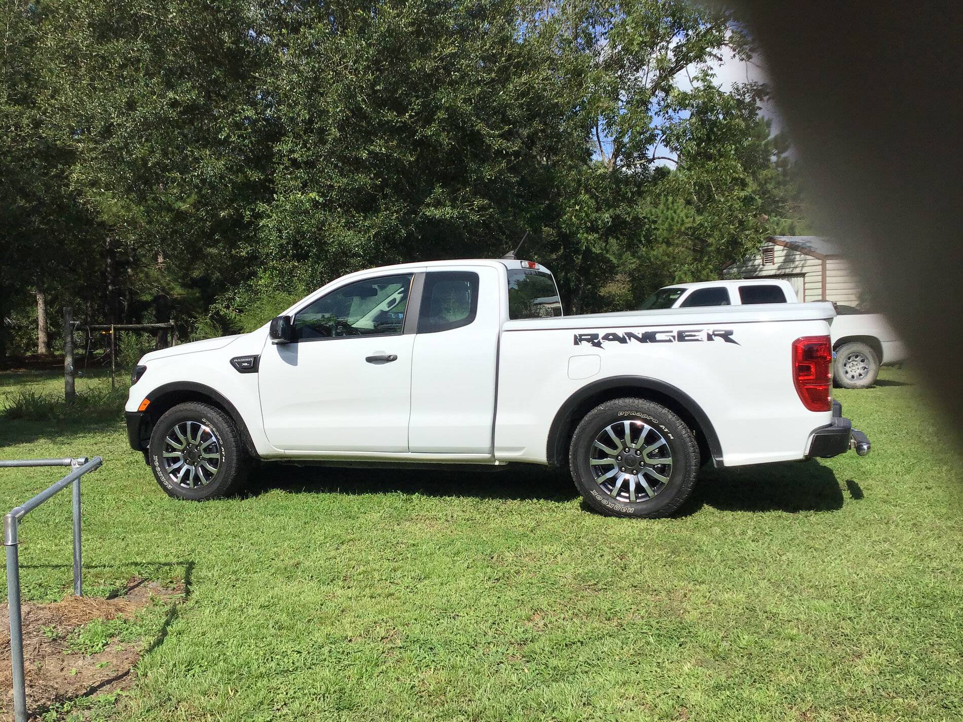

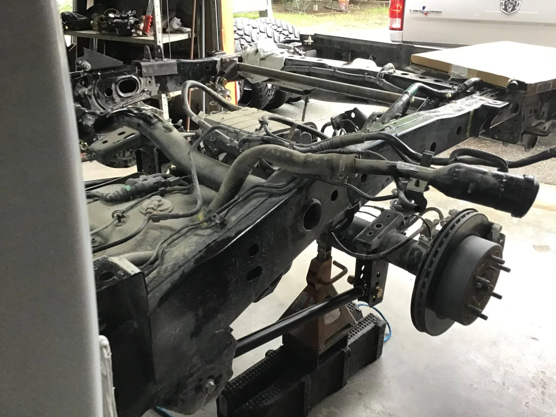

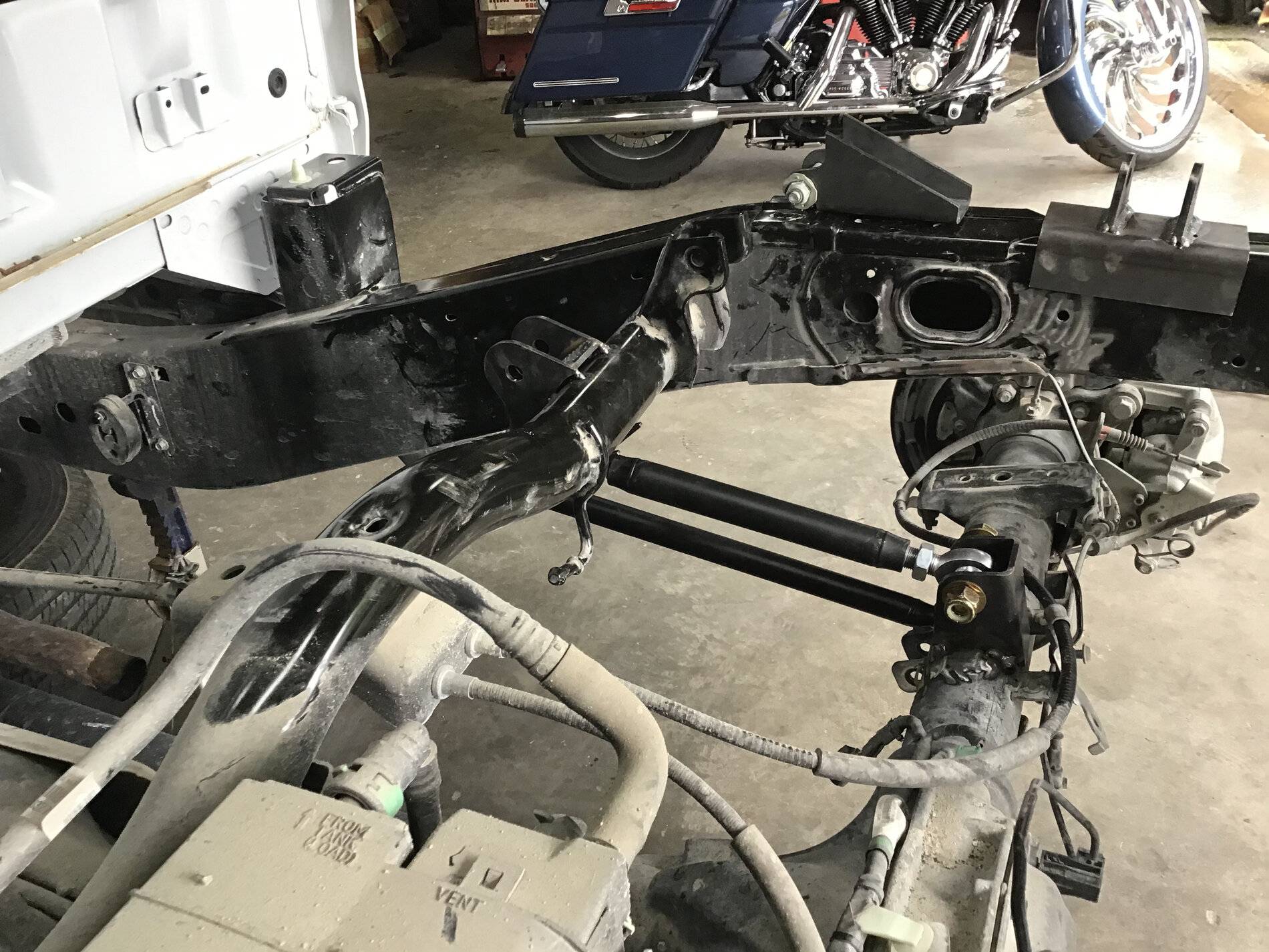

Mirage…
Here’s the Freakride (Control Freak) setup …
Doc,
That's really sweet!
I wish I could weld worth a damn, as I'd do it all myself... But probably for now, I'm going to order their front drop and Belltech's rear 6" drop. If I can find someone to weld all of that in for me, I'll definitely buy their rear kit! How much of a drop do you have the front adjusted too? I assume something around 4"?
I'm thinking for mine, a 4/6 drop would be good, with 265/50/20 tires, what do you think? I like the way yours sits actually!
Thanks for the pics!
4WD or 2WD ?? @FinalNotice I know it says 4x4, but just want to make sure....and yes, I'm a little excited. Also, any issues, like rattles, grinding, or anything weird ? Have you tried 4x4 with it ?
Great looking truck! I have been wanting to see 22's on our trucks. I really like it. And being 4x4 is icing on the cake.
Great Build!

Doc,
Yes, I have their drop spindles in the front as well as King adjustable shocks…
Both front and back are 35” to the top of the wheel well, any lower and it rubs .
Regards
That's odd, as I talked to someone at Control Freak on Monday and they said with their front drop, I could easily get 5"-5.5" of drop, with a 20x9, 4.5" BS, -12 OS, with the 265/50 tires without rubbing? I know the SCT truck is 5.5" lowered in the front and I assume 6"+ in the rear?
