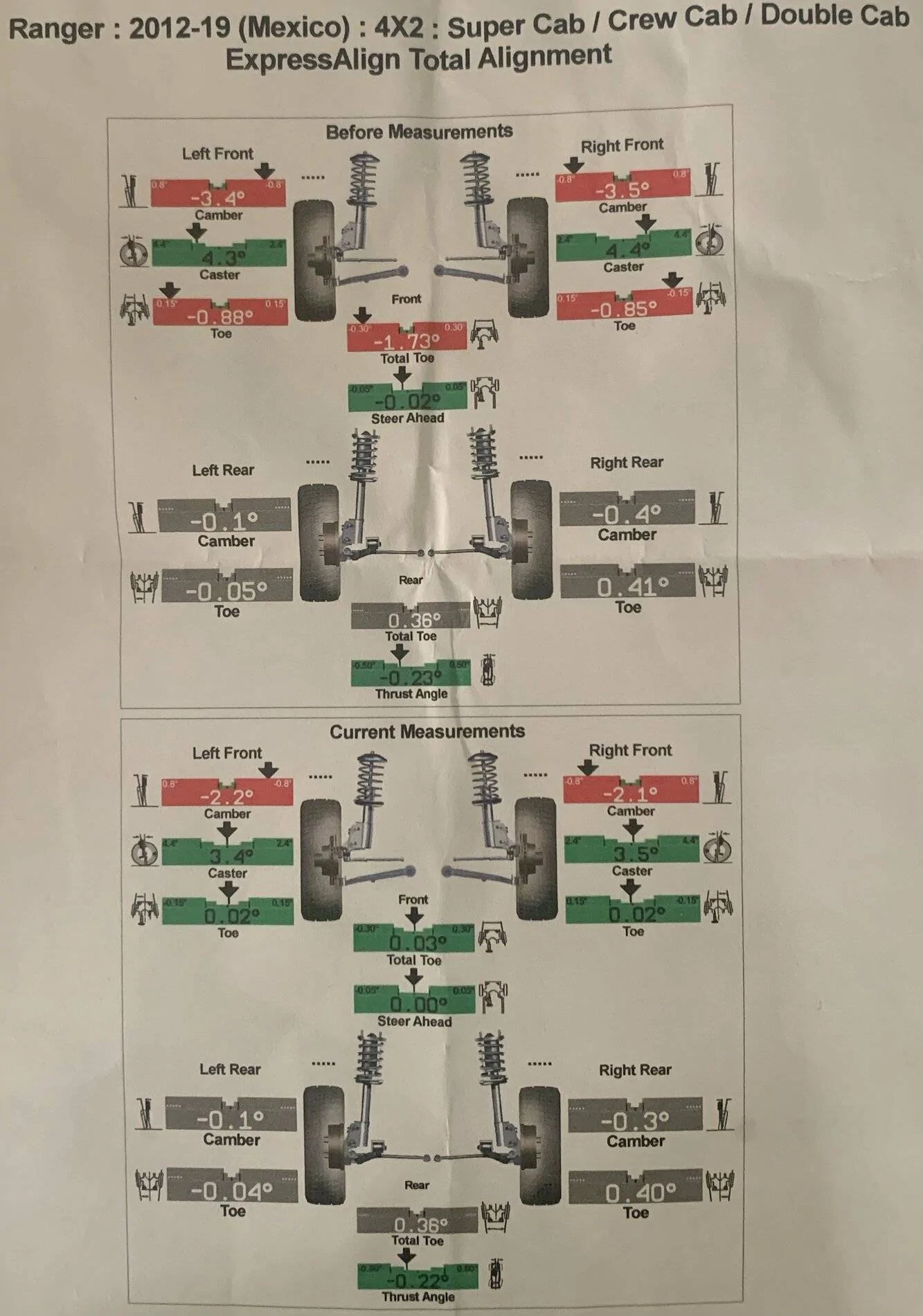

Since you went for the max drop in the front what was your final front alignment settings?
Belltech has something in their instructions about negative front camber at max drop.
The beta test guy @Kevin Franklin was at 1 degree negative camber with a 2 inch drop in the front.
Any info you can share would be appreciated. My lower kit gets installed tomorrow and I have to decide how low to go.
The camber is beyond the oem ability to correct. I’ll try to get a picture of my alignment printout posted soon. I’m at work right now.

2 degrees of negative camber shouldn't cause significant wear. If I see the same when I eventually do mine, I'll probably set it at 3 degrees and just a hint of toe out.
I I expect to wear the inside of the front tires more now. Pay to play situation. My family is a bunch shorties so we are all happy to not have to climb up into the truck anymore.

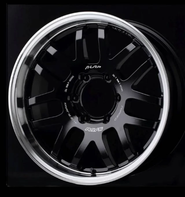

I’ve got a set of these Rays A-LAP 07x wheels on the way from Japan. They’re 18x8 +38mm, so no tires sticking out of the fenders for me. At around 19 pounds they’re about as light as you can find in a truck wheel this size. Tire size is my big decision now. Sticking with the light weight theme, I am considering some cookie cutters in 235/60. I’ve found those in the 25 to 27 pound weight range. Also looking at 255/55 for a full width, at around 30 pounds.

Ohhhh wow! Those will look awesome! Japanese tuner stuff is so cool. I totally agree on offset, I don't like the tire poking out past the fender look. Sometimes the look works with wide fenders like a Widebody Charger or Raptor but, it is a look that I think will not age well.
Your lightweight versus tire size problem is interesting. I totally understand your quest for added performance through weight savings but I know that a wider tire will give more tread on the ground. I guess you will have to figure out what you intend to do with the truck. Straight line performance or corner carving.
Personally I like a wider, beefier tire. Aesthetically the bigger tire, filling up the wheel well, just looks better to my eye. And, at the end of the day looks are really what matter!
