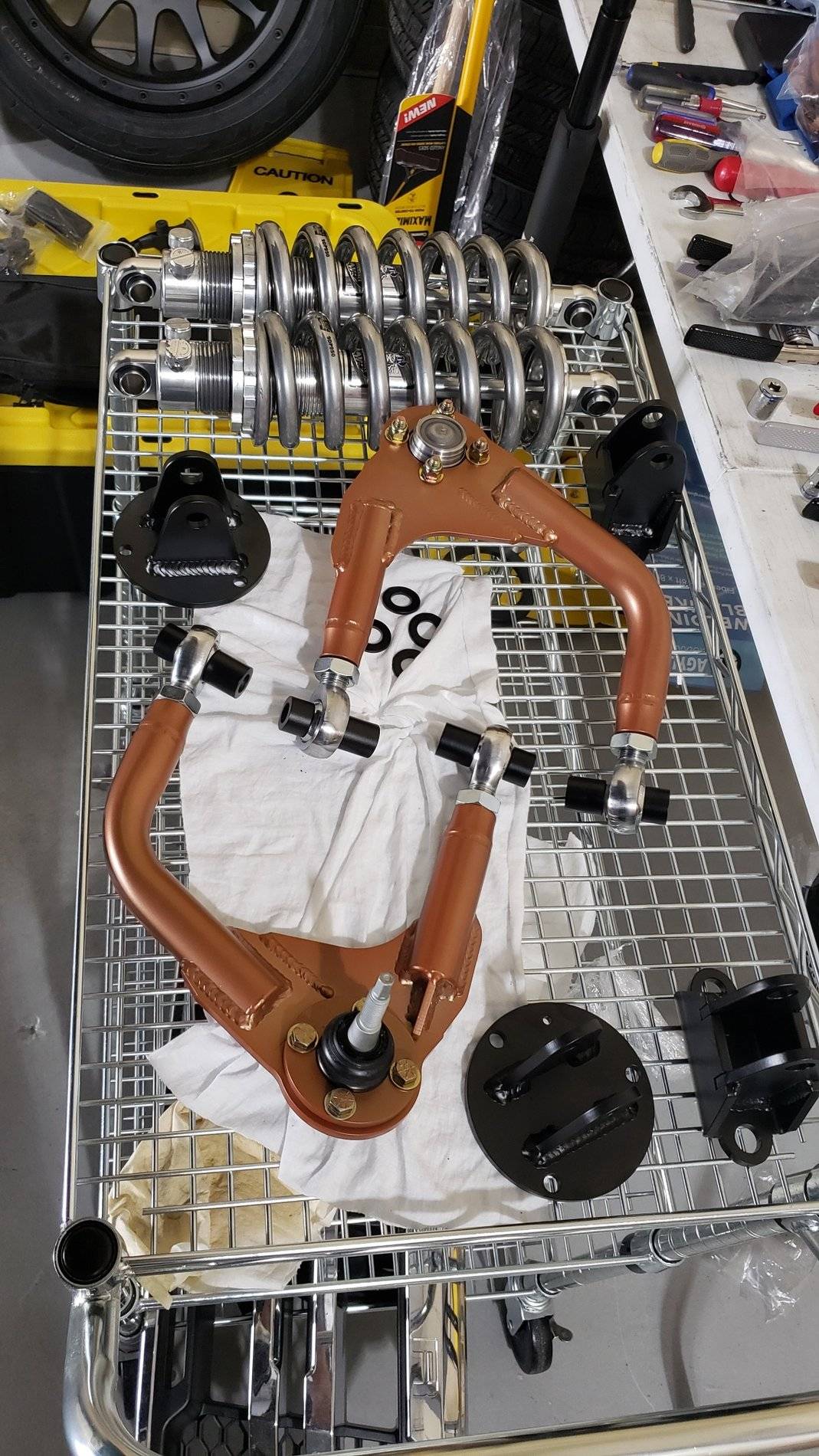

Don’t know the specifics, but I have the freakride front lowering kit, I didnt put it in… It was done by my installer here along with a very expensive rear welding job …
Regards
Edit:
It appears to be just upper and lower control arms with different spindle assignment …and shocks. I would recommend the Belltech kit also….
Regards
Edit:
Gotcha buddy! I was just unsure. Thank you for clarifying!
Be interesting to know if they would sell the upper control arms by themselves.

Doc, I thought it was just upper control arms, coilovers and the mounts for the coilovers in their kit?
Yup, you are right …I just checked, uppers only..I never paid much attention to the front setup ..
