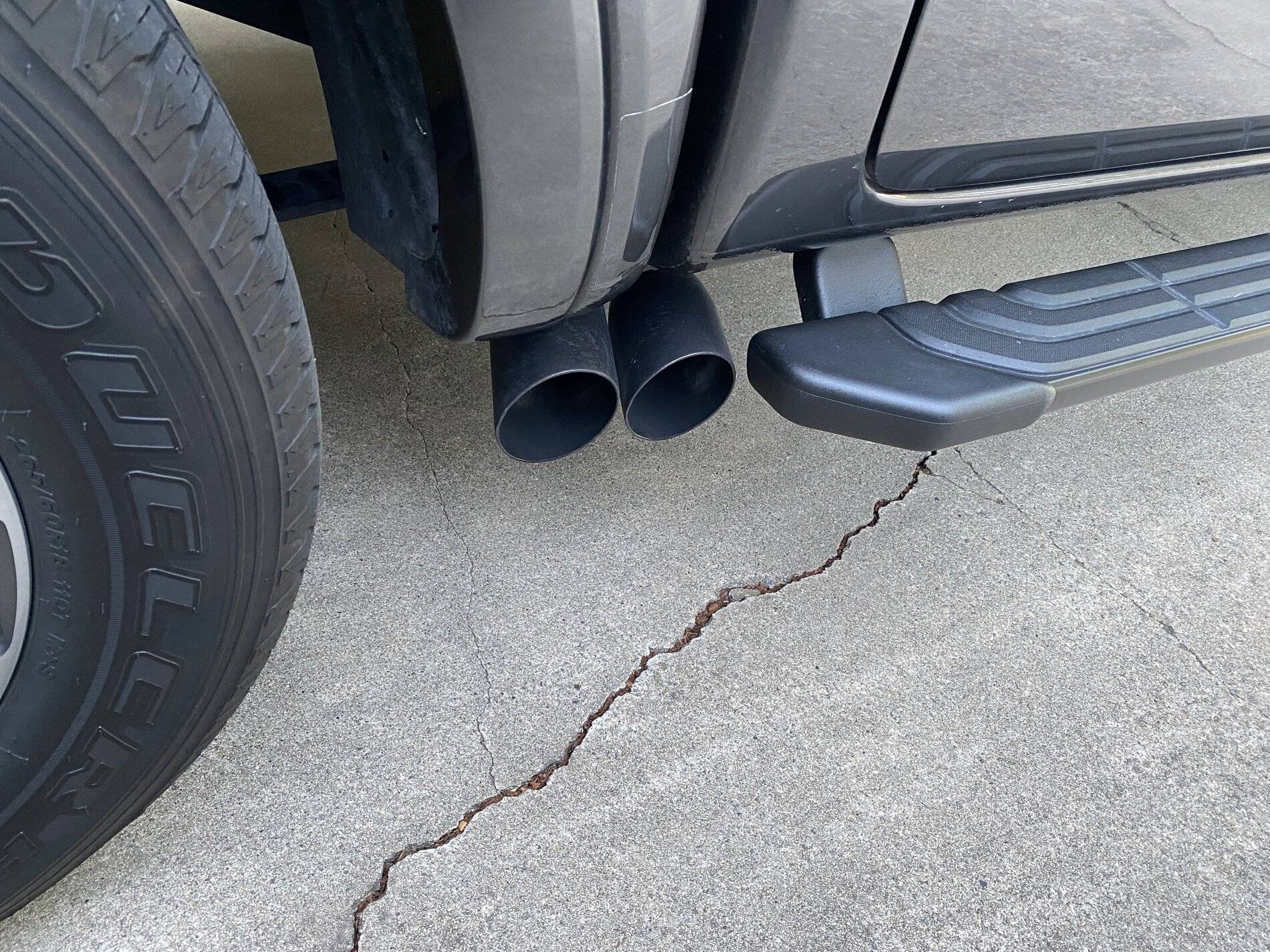

Can you tell me about your exhaust? I really like the look and would like to hear your experience with it.

Sure, first thanks for the warm welcome. I installed the aFE Rebel muffler delete but found it was too loud on startup for my comfort (neighbors and didn’t want my wife to start asking questions). I then added a muffler… still too loud …then swapped for a resonator… finally settled for a Flow 409 SS muffler. ?

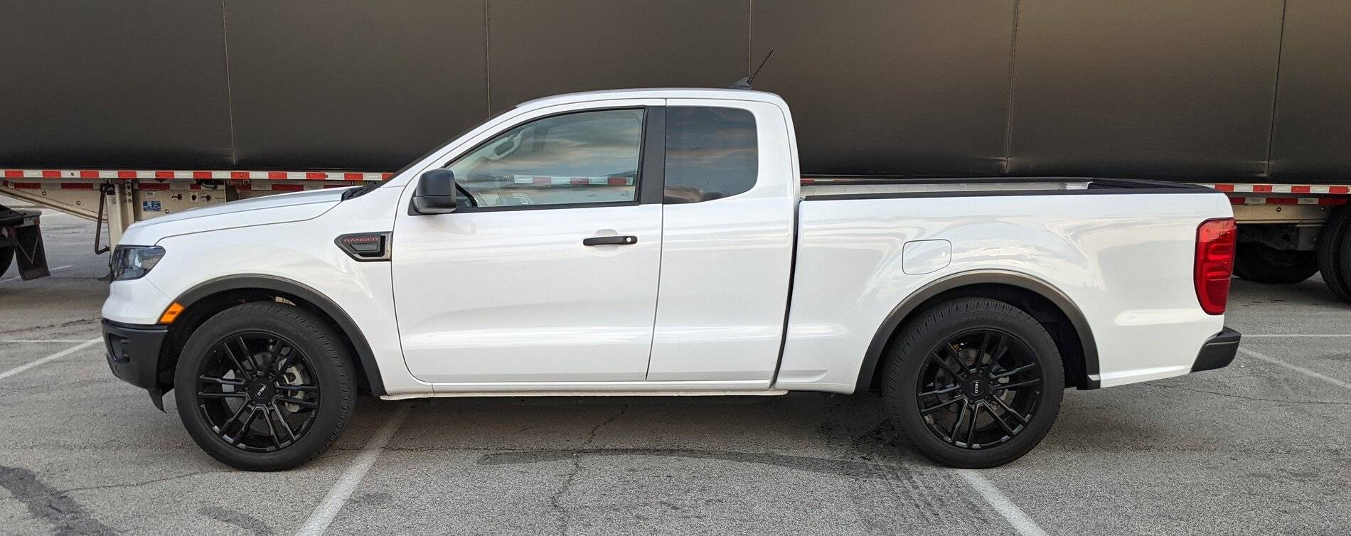

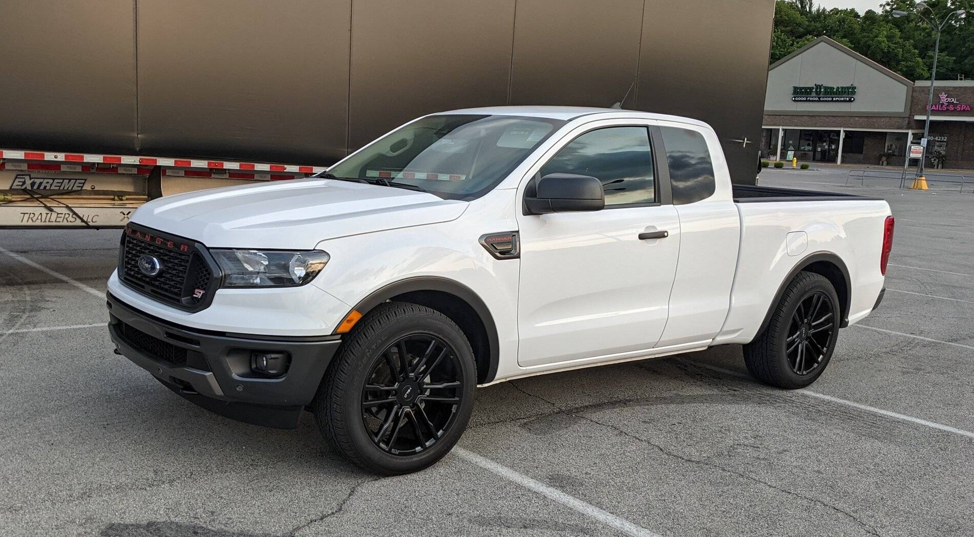

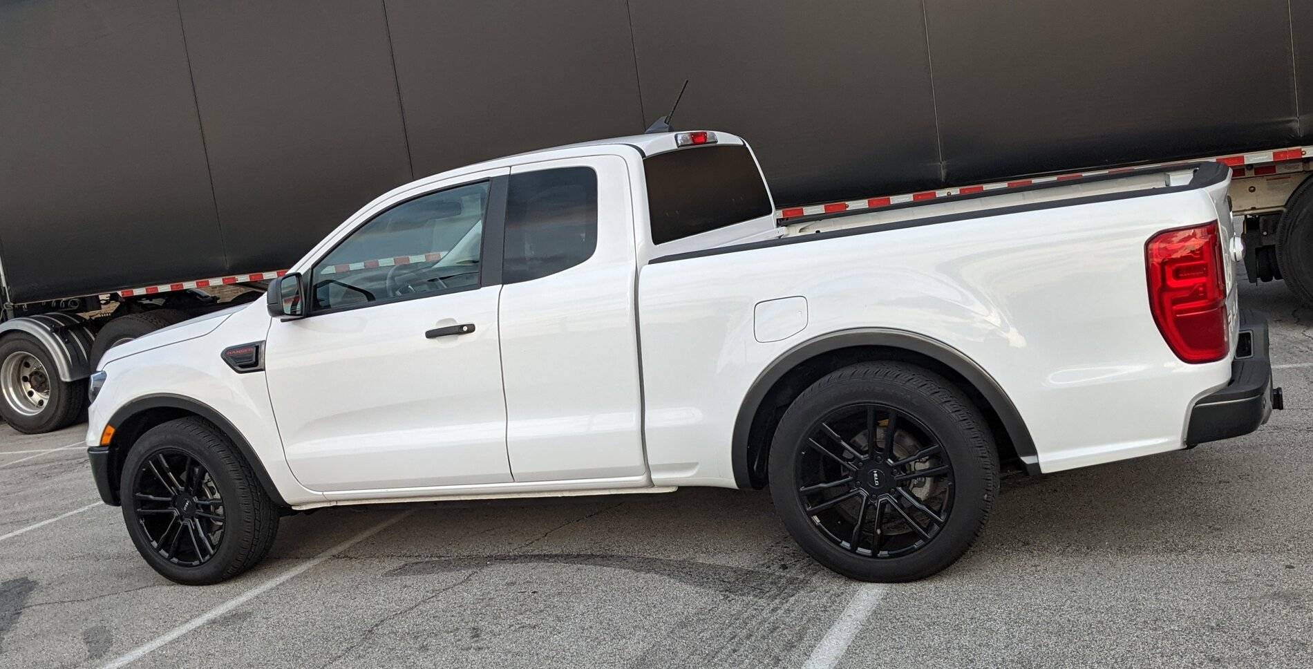

Fantastic result. Totally deserves the ST badges. Don't be mad when I copy you and follow suit. As a mid-pack national autocrosser I understand and like your alignment settings. Only thing left now is to find a Torsen LSD and these trucks would be perfect little sport trucks.
Did the lowering help or hurt lighting up the inside rear tire coming out of the corners? Without the LSD I'm just planning on a BIG front bar.
Finished!
Settled on going with the -2.0 for now on the front struts after attempting to go with a -2.5 drop. Tried the +2.5 first knowing that -3.0 was not possible without a redesigned upper control arm. I could not achieve an adequate camber or toe setting with the -2.5 drop, so regrouped and went with the -2.0 which pushes the camber adjustments to the limits. ..........................................Simply put, I LOVE IT! Next, a rear sway bar to reel in a bit more rear positivity.

That was my fear about the muffler delete. I really like the look but haven't heard anyone say that they liked the delete. Seems it is always too loud for neighbors and wives. A shorty muffler may be a fix to get the side exit look with a bit of noise control.

Mad, HELL NO! This is a truck that Ford should offer. They are fun and have a ton of potential.
There is still tire spin and I don't know if there is much we can do other than attempting to transfer weight like you suggest. I am curious to see what a rear bar would do. I have a couple of donor sway bars that I am interested in possibly adapting. What are your thoughts on that?

Normally adding or increasing the rate of the rear bar would induce or increase oversteer. I feel like the rear bar might also bind up the rear axle that we're trying to keep planted. I have not played around much with trucks though. A big front bar is a compromise. It will probably make it a little pushy but should keep the rear planted enough to help with the traction issue. Finding a good LSD would solve the traction issue and allow us to optimize the suspension for handling rather than making up for no LSD. I'm guessing it helped a lot to get rid of all that rake in the rear also.

I can understand your thought on the subject. While being a rear wheel drive vehicle, trucks do react a bit different than a rear drive pony car or sedan. I run a 7/8 rear bar on my 1994 Splash and it has helped in the overall feel. That being said, the those two Rangers have ZERO in common with each other. Reducing the rake and ride height has been nothing short of fantastic. The truck feels so much different to me. My guess is that a limited slip will eventually find it's way to the market. It may have already arrived and I just don't know about. I have not checked and I am curious to see if the center section is shared with any other vehicles that may offer such.
