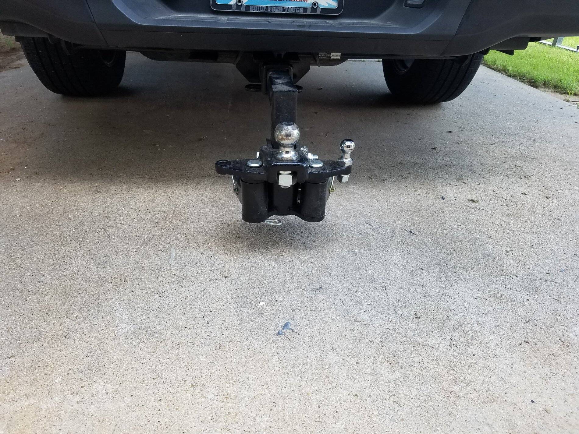

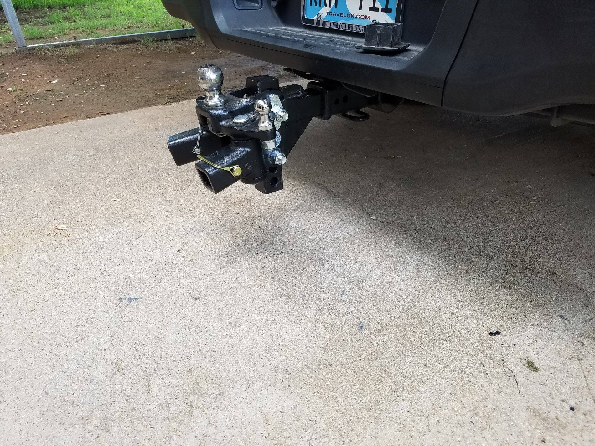

Well... I think I may have to adjust my hitch a tad.:rolleyes:
Fortunately I still have my old shorter shank.
