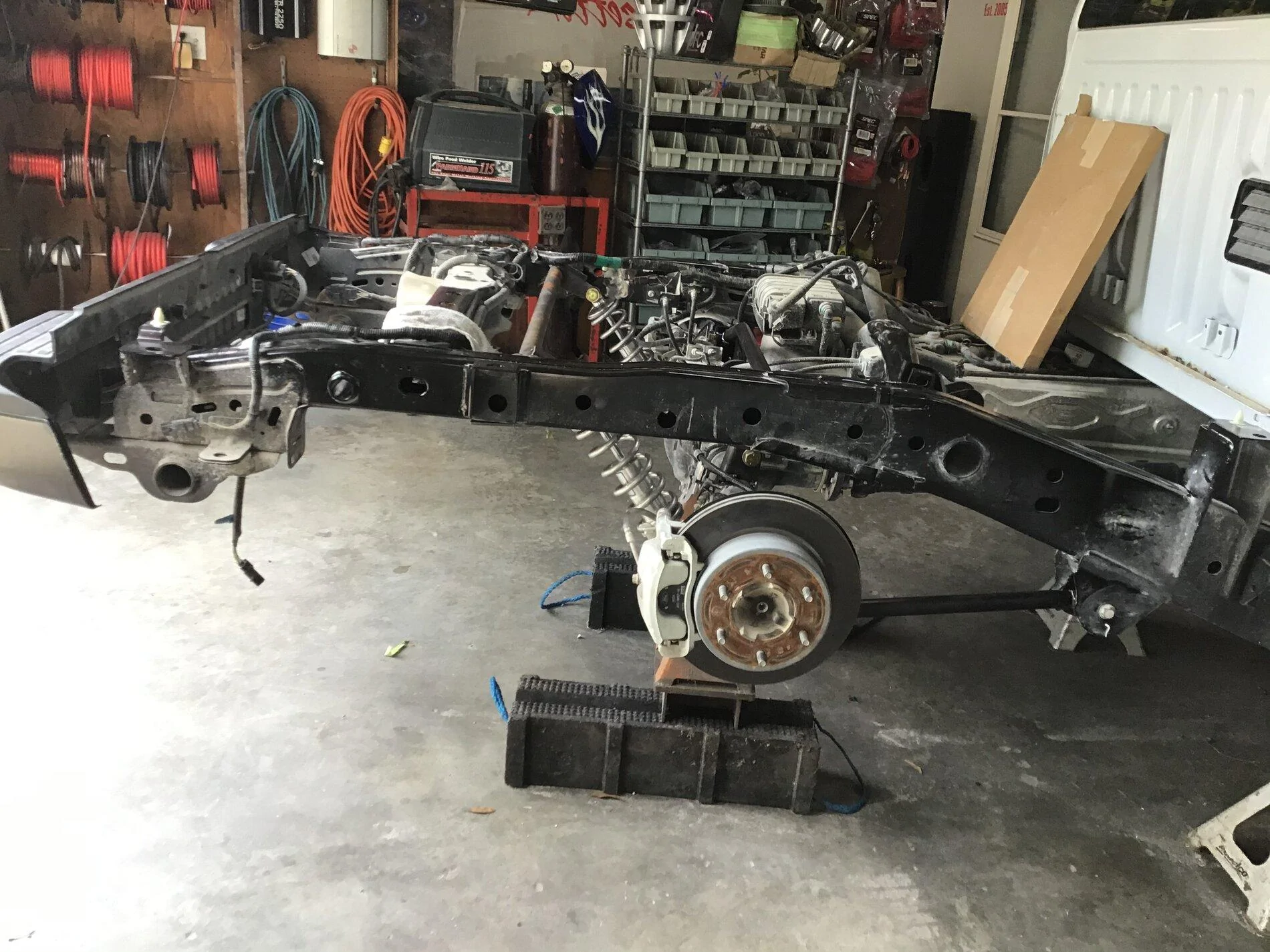

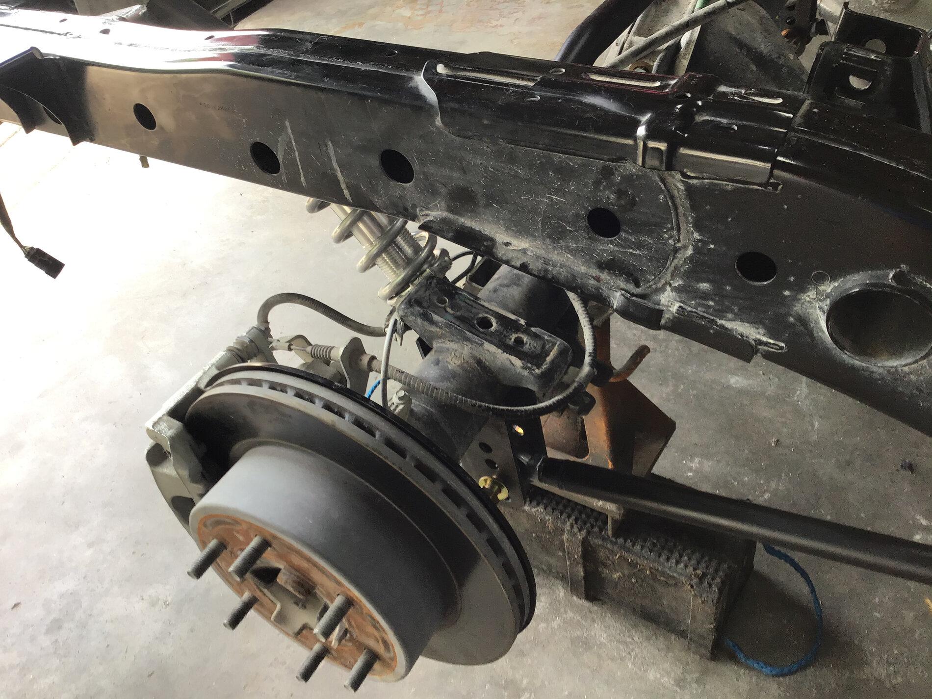

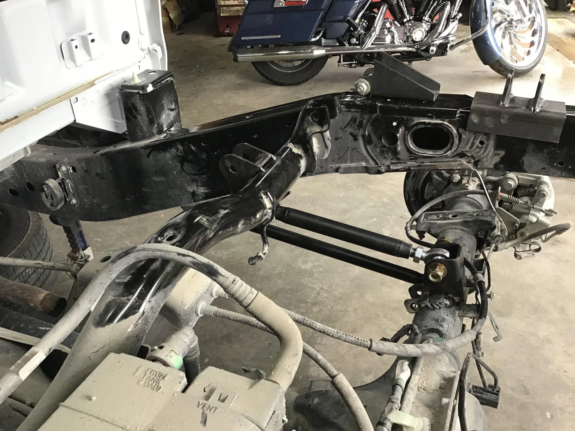

Just spitballing here. If you put APG springs on the rear, and pulled out a couple of leaves, how much drop would result?
https://automotiveperformancegroup.com/product/s20-008/
I don’t tow, carry heavy loads, or off road. Just want bring the rear down level with the front, and soften up the ride.
Based on the existing geometry i think you would break/reverse bend the springs before lowering the rear enough to level truck. Not going to happen without a axle flip or complete rebuild like @Doc did.

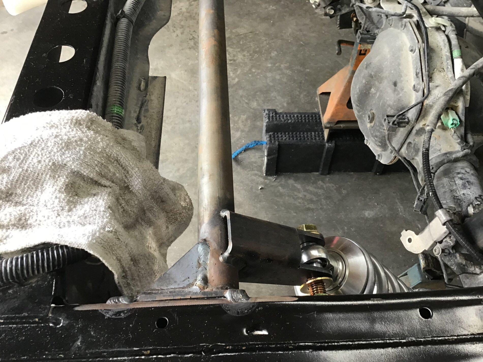

Yep, under std load, the OEM springs are almost dead straight, I don't know if a reverse arch would keep clear of the frame.
To get the back end on mine down, I had a pair of OEM springs re-arched to add 3" more arch then flipped the axle on top of the springs.
