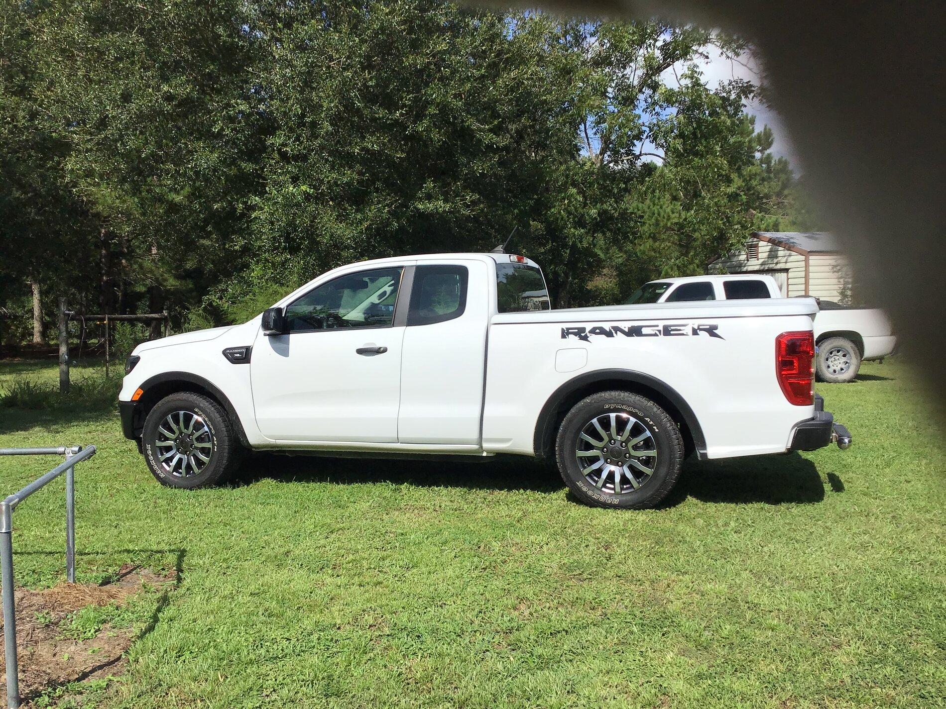

Ok, Just a quick update. I lowered the front a little more, and re drilled my flip brackets to restore the 126.8" wheelbase. Done for now
Ok, So i lifted the rear 1" with a set of BDS shackles. Done for now.
Well done. I have yet to see a lowered Ranger, until yours, where the rear tires are centered in the wheel opening.
How is the ride quality? Better, the same, or worse than stock?

Hey Henrymac, I didn't notice any difference in the ride.
