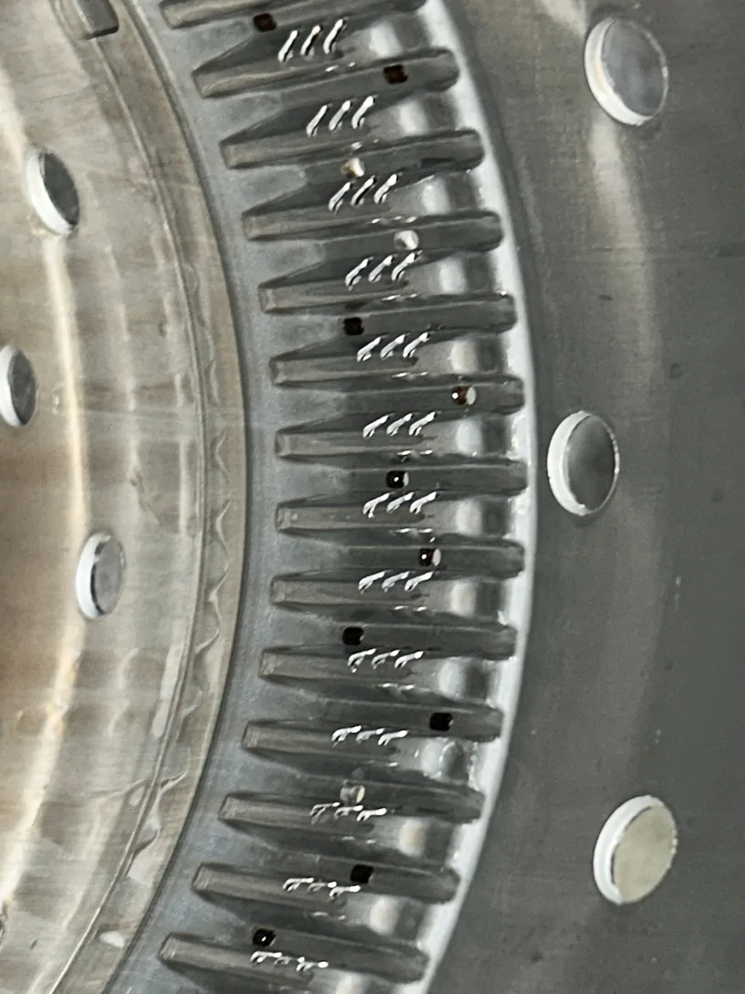

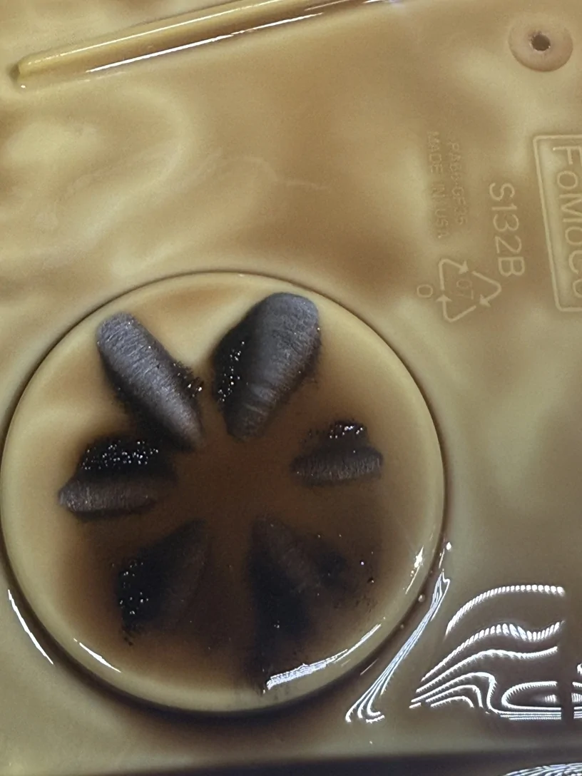

The tranny shop said I won't need a full rebuild, but the trash can and cdf drum, as well as ancilliary parts need replacing. Around 5k for the rebuild. Cheaper than a replace, i guess...
Might want to get a quote on a new valve body too.

They said that was next on the agenda to check.

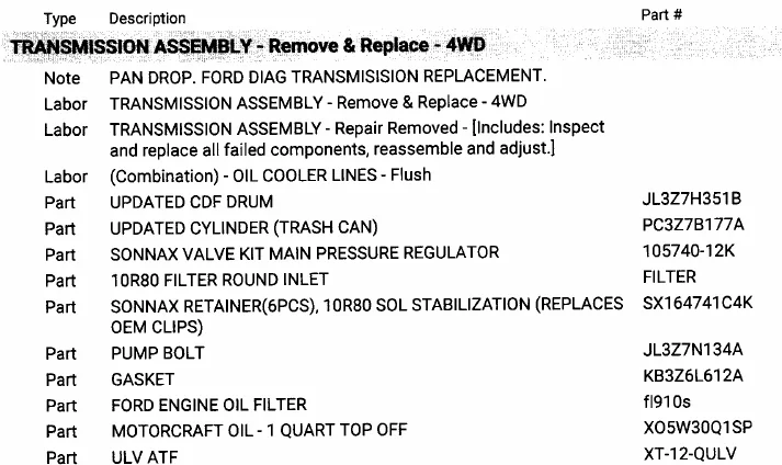

Repair cost: $4500. Attached is what was replaced. Here is the letter I sent to Ford customer relationship. I don't expect any positive response besides corporate hand-wringing.

10R80 transmission failure, as detailed by TSB 25-2134
I spent $1,800 to fix problem #1 and $4500 to fix problem #2. This is more than I had to spend to repair issues with all 6 previous Fords COMBINED. The only thing more disappointing than the money I spent on repairs, is Ford’s complete indifference to its lousy quality. You can rest assured that if I can’t get a positive response, including some kind of renumeration on these repairs, this will be the last Ford I ever own.
