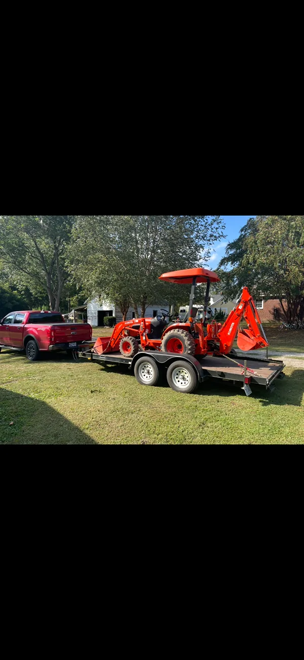

Never had any real weight on the truck itself but I do pull my Kubota 2620 backhoe two or three times a year. It turns five years old next week and I cannot say one bad word about the truck.
