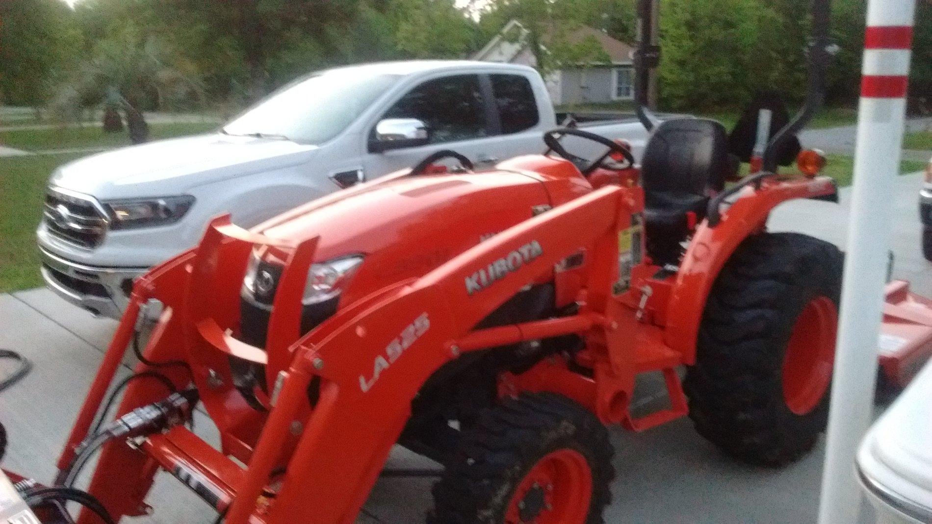

This is the type of discussion that I was hoping for thank you. Blindly accepting fords ratings are logical not all are equal. I have a class A not all tractors can pull the same amount. And these can't either. I hope that this makes sense. And as for you trolls that don't have a ranger go somewhere else. Here's what I want to tow and here's what I want to tow it with. Thanks Floyd

Actually, the take away from that circled portion is that trailer tongue weight is part of payload.
10% is generally too little tongue weight ...so if you choose to tow a 7500 pound trailer with 900 pounds tongue weight and four hundred pounds of passengers in your Lariat SuperCrew, be prepared for only about 250 pounds of cargo. Even if you agree with the 10% per J2807 your cargo will be only 400 pounds.
To me this means that a realistic trailer for the new Ranger would be about 5000 pounds, which would leave a thousand pounds for people and stuff to max out.
I bought mine for maximum payload (STX SuperCab) and overkill for a trailer under 2500 pounds. Subtracting tongue weight I am then left with 1500 pounds for people and stuff to maximum payload.
Leaves me with a good margin of a thousand pounds of space for toys and gear, of which I would prefer not to use 100%.
Ditto. You should probably read the manual very carefully before trying to tow anything. Good luck.
I have and it's ambiguous at best my next move is to visit the good folks at the MDOT commercial enforcement. ÀAAH and then see what they say.

I have ocd. And have violated my rule #1 change the things you can accept the things can't and know the difference. Called FORD 7500 OK called MDOT enforcement 7500 OK. Ohhh that's three rules. Ocd again. Am sorry for being a ass. Any hard feelings???

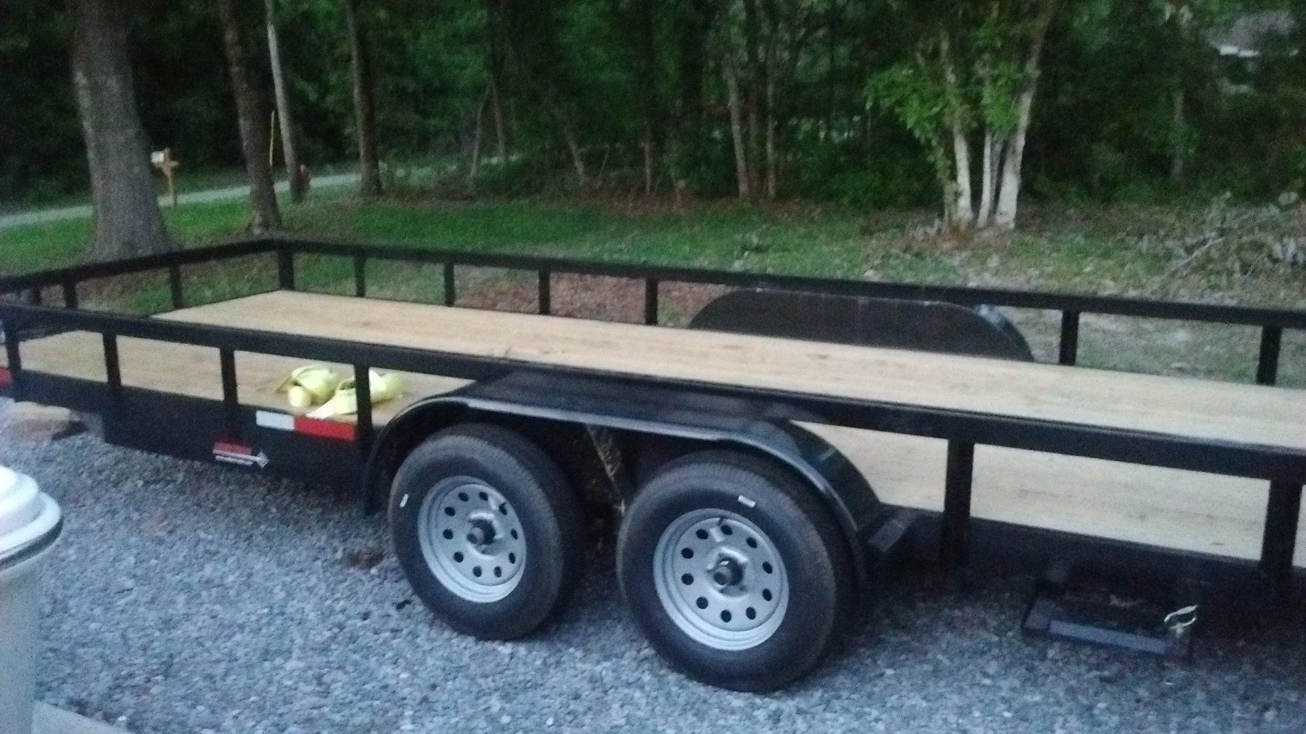

That's a nice trailer, very similar to mine. I have towed mine a few times now to get used to it's handling and Friday me and the wife are taking it to North Alabama for it's maiden camping trip. I will let everyone know how it goes.
It's only 2.5 hrs. to the site, but a good amount of large inclines and curves, some back roads and some interstate. I'm hoping everything goes well.
Well we made it. Friday was wet and stormy with very high winds, so I towed slow to fight the cross winds. Took me a bit longer to get to the campsite but the truck did well. Only had one crazy 18 wheeler pass me in a rainstorm doing about 80 and that got real sporty for a moment, but the truck and trailer handled it really well.
On the return trip it was sunny and no wind so I stayed around 55-60 mph and I sometimes forgot the trailer was back there. The truck handled to big hills, merge lanes and several quick stopping moments like a dream.

12 ain't bad, had ford put my redarc in about 230 bucks 202 for the unit. Didn't want to screw up a new trk and am not a automotive electrician. Will try to scale trailer, tractor and trk by this weekend. If all goes as I hope will report about towing 6000lbs on I-10.
