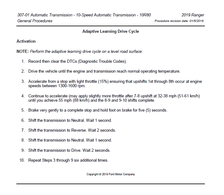

My Ranger has just rolled over 33,000 miles. Not sure how long the learning period goes. I do know that my transmission works more like expected when the weather is cold... stays in lower gears longer at slower speeds, shifts smoothly in and out of 8th gear in all torque ranges. Makes me wonder if a higher viscosity transmission fluid would alleviate these issues.
you can do the adaptive learning cycle in a half an hour by following the procedures in the tech manual.
you dont need thousands of miles on the odometer.
