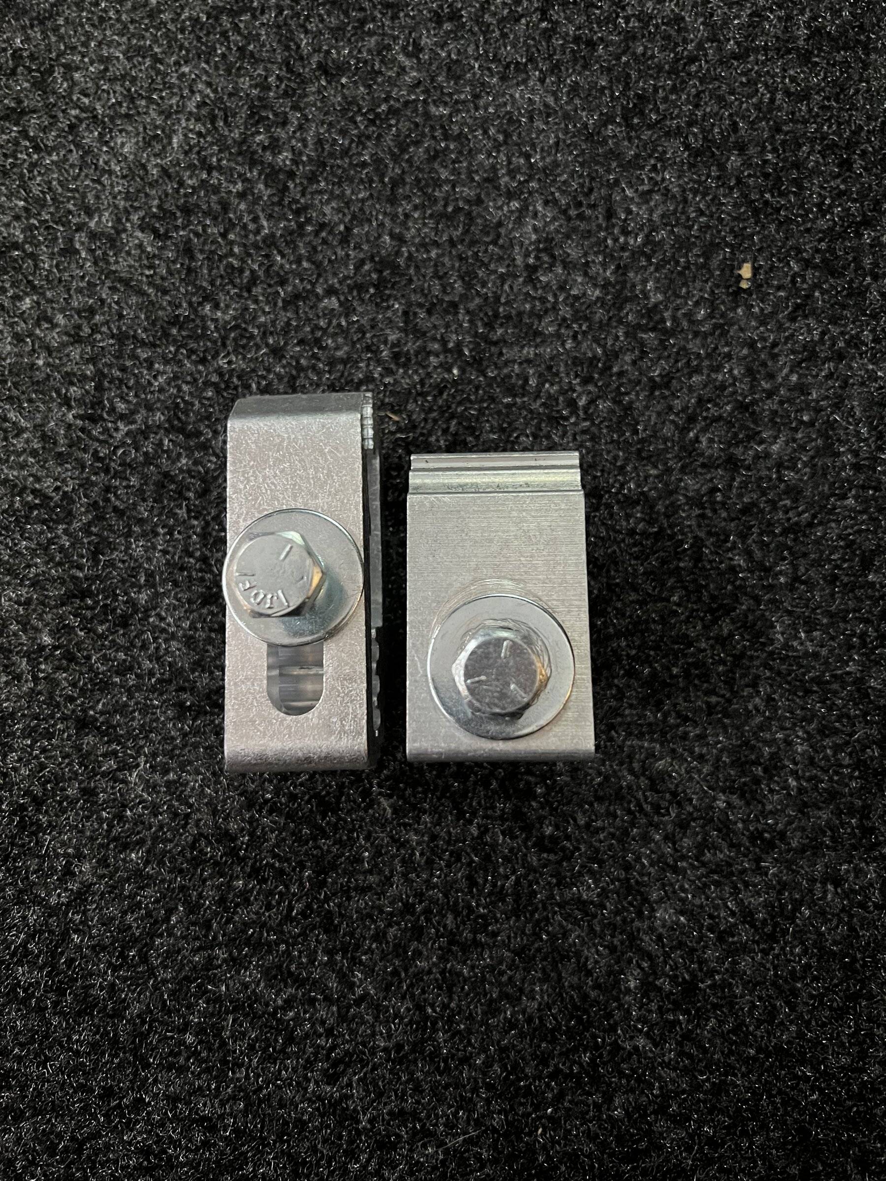

For anybody who may still be following this… New clamps came in, they are much longer and seem to bite down way better on the small lip on the bed of the truck. Have not driven around since installing the new clamps… been watching football anxiously all day to see who my Packers play next weekend. Don’t know if the rattle has stopped but I’m happy and optimistic about the results. Here’s a size comparison for anybody who’s curious. I believe these are truxedo clamps.
new clamp is on the left, clamp sent with gator tonneau on the right.

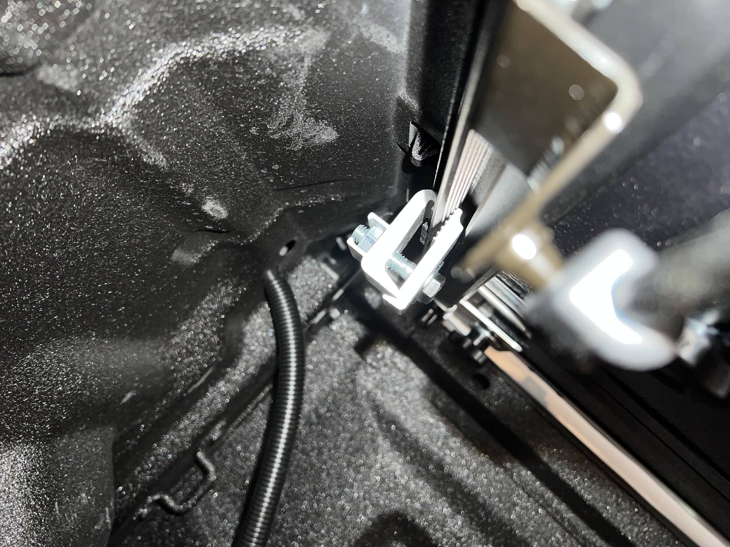

I am thinking about buying a gator hard trifold.
The Ranger rail does not have full coverage on the sides.
3" of no rail at the cab, 5" of no rail at the tailgate.
It appears a shim could be used between Ranger rail and the plastic cover for
better clamping on the rail. I have the factory sprayed liner.
Looking at the pictures of the clamps, this one seems to have missed the Ranger rail altogether.

You're right. In that photo I either missed that rail altogether or it lost grip and slid down while driving. Either way, the new clamps I got are working much better... little to no noise from the back, even in the cold weather.
