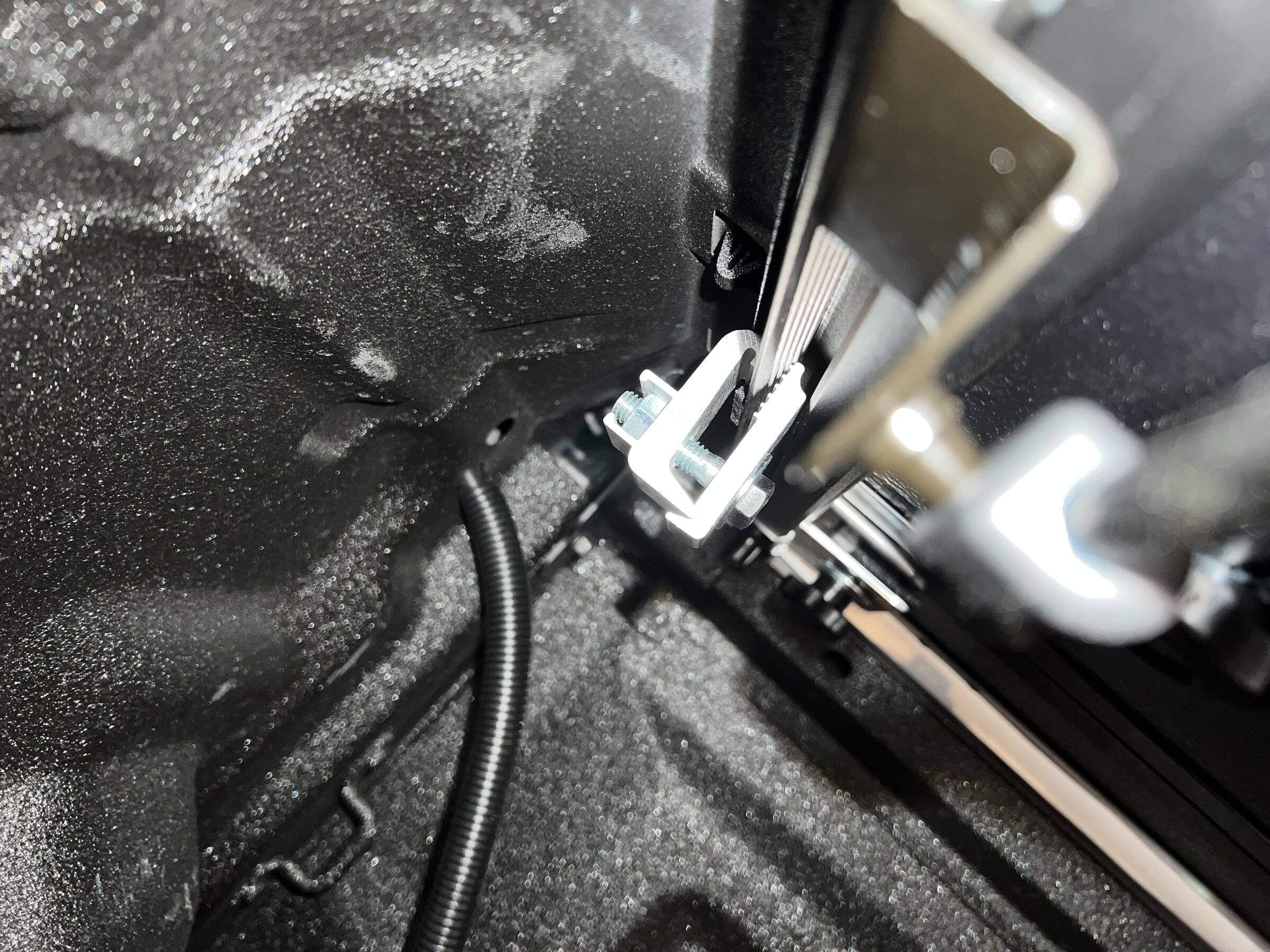

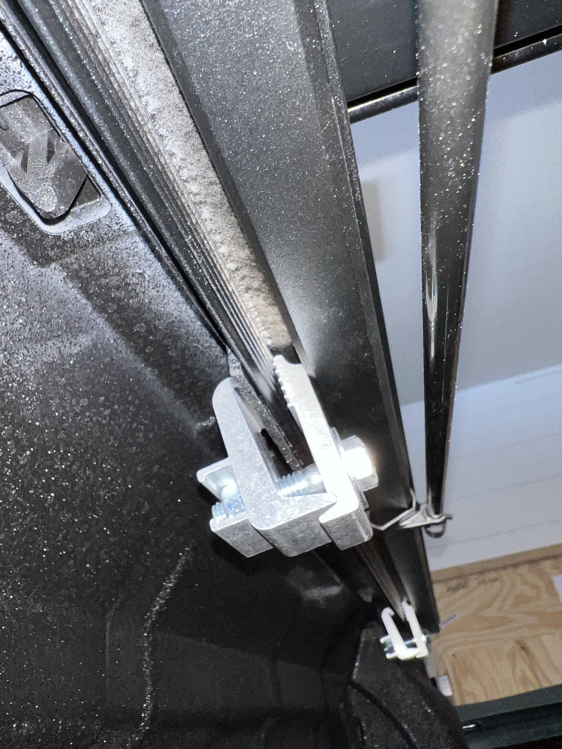

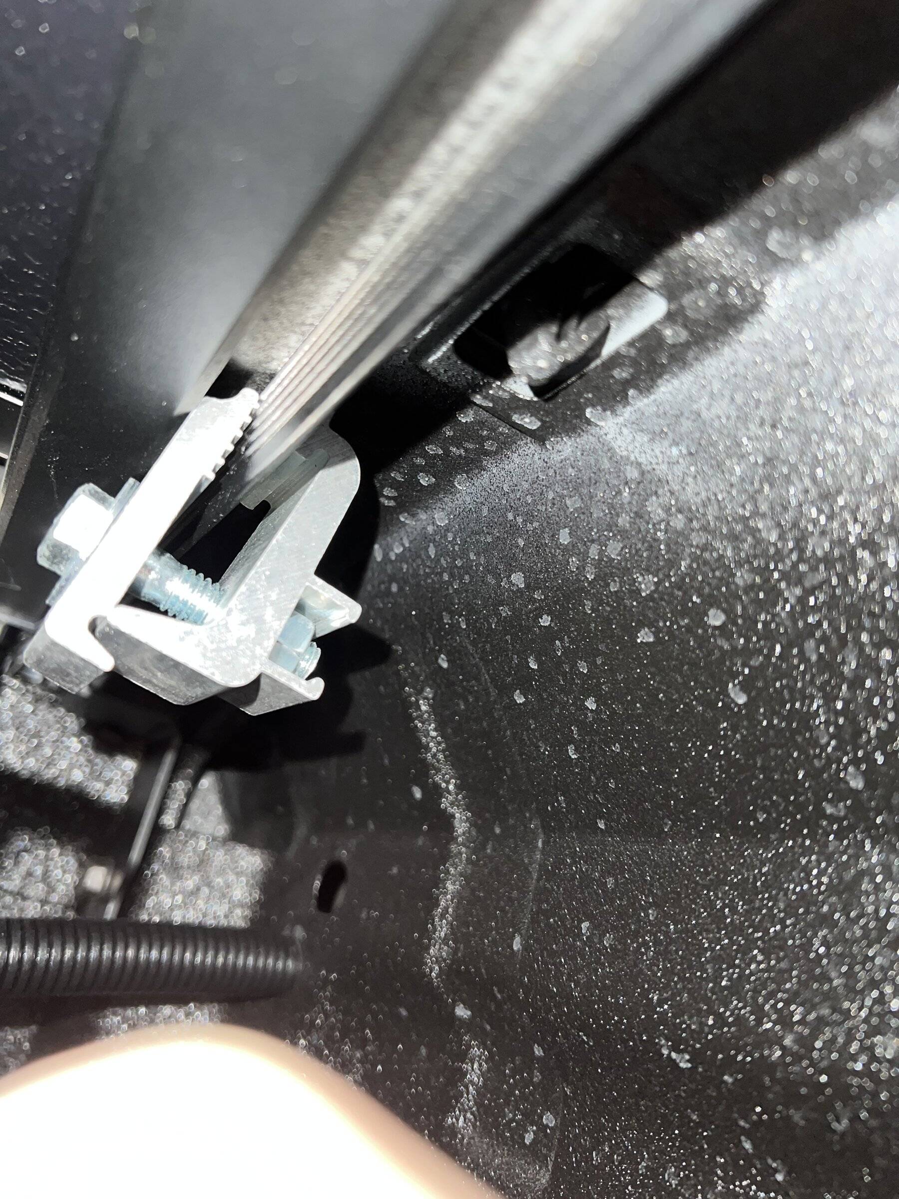

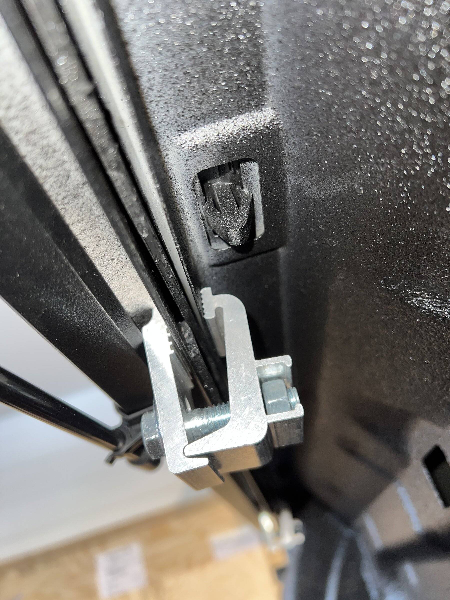

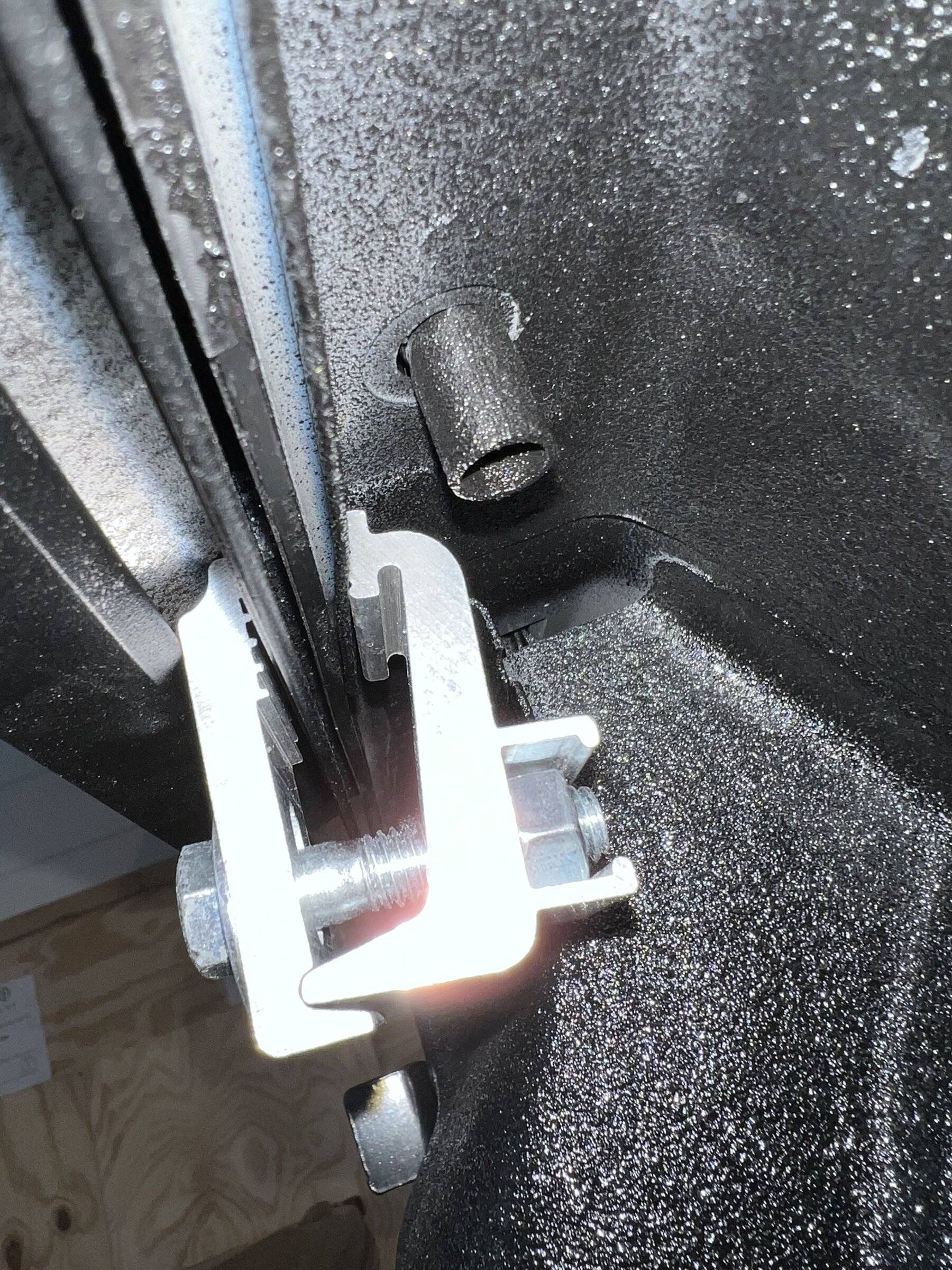

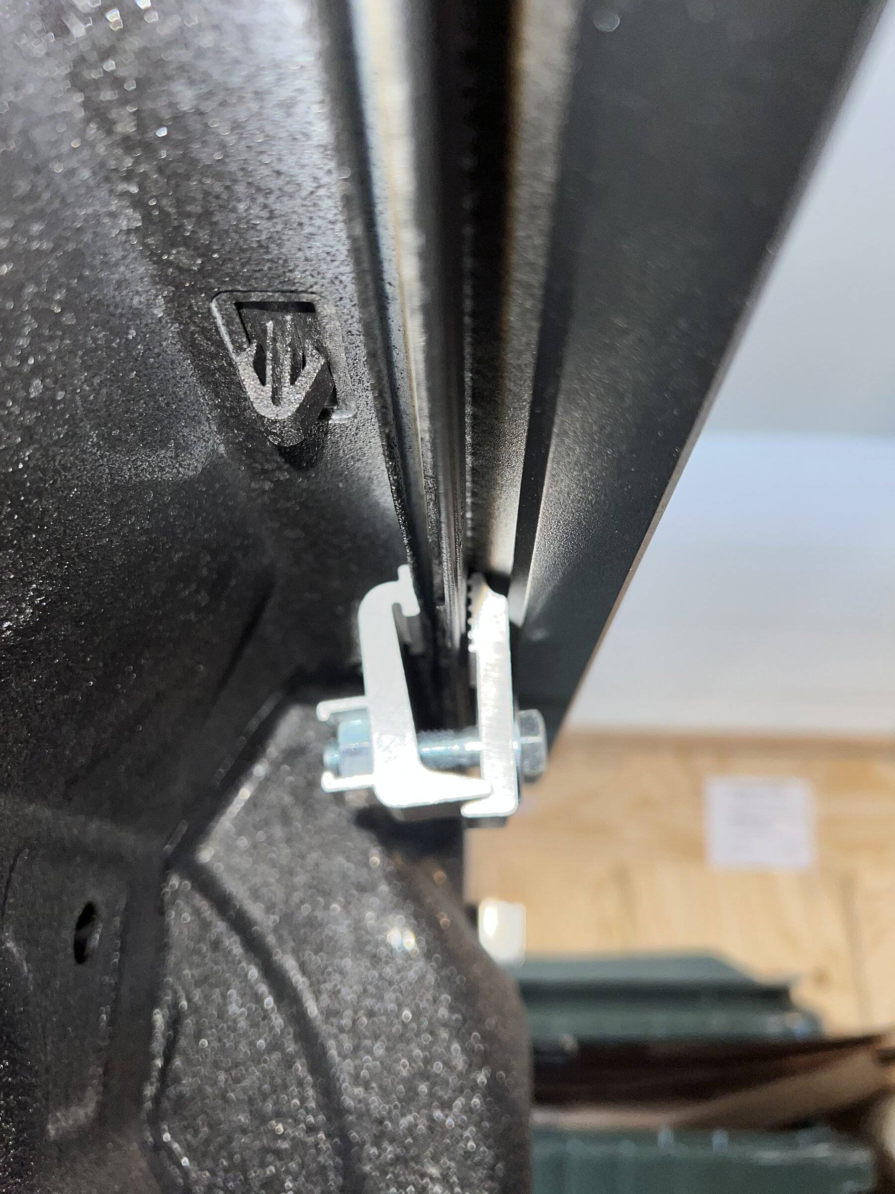

Can you show a picture of the current clamp installed?
Here are some photos of the clamps as they are right now. Not the best photos but they definitely don’t seem to be as noisy after being parked inside all night

It's the rails that attach to the inside of the bed rails. They tend to shift , up especially at the rear, like they're coming loose. Clamp is still tight, but rail simply "slides" up.
Damn Ford bed rail lips are just too short...an extra 1/2 inch would do it. Clamps that are supplied are good, just not enough bed rail lip to get a good permanent hold.
