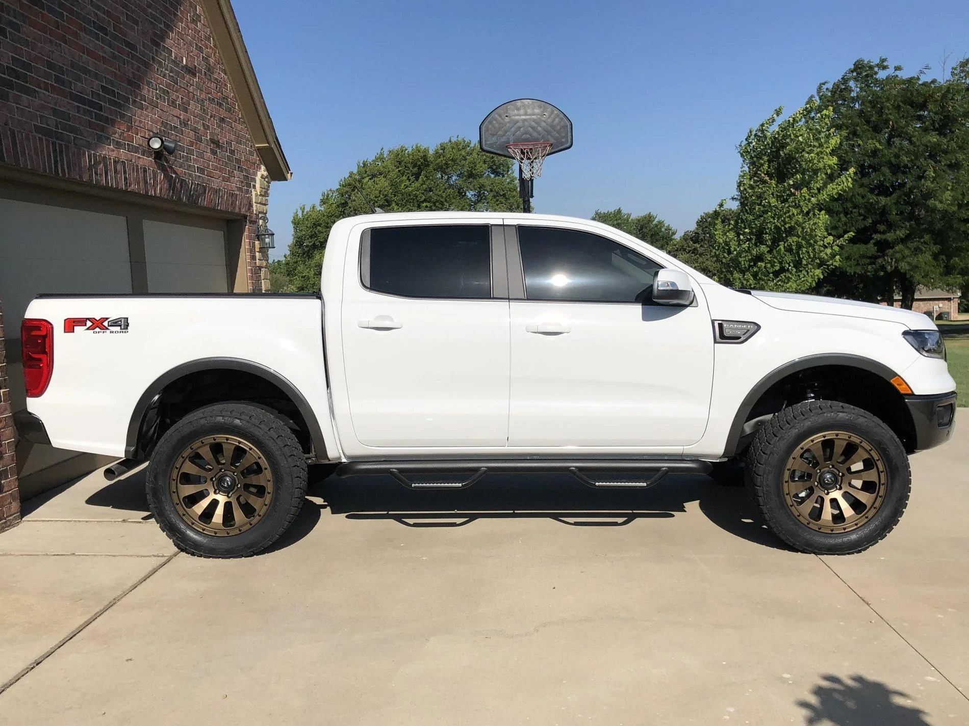

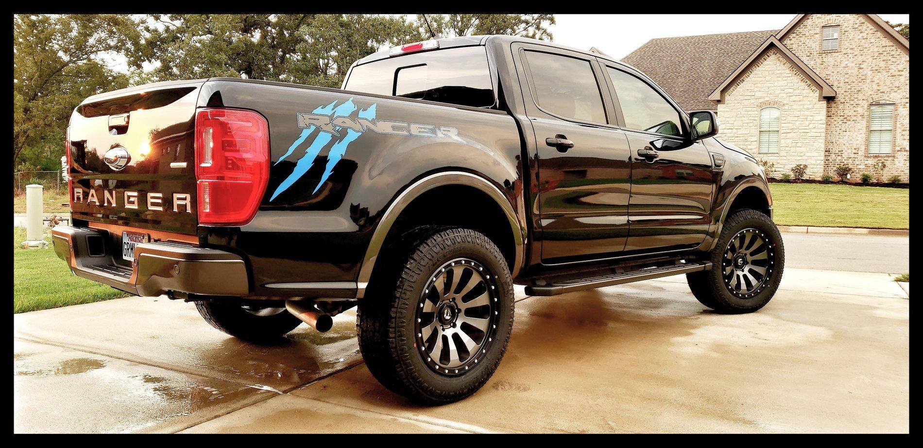

As mine sits:

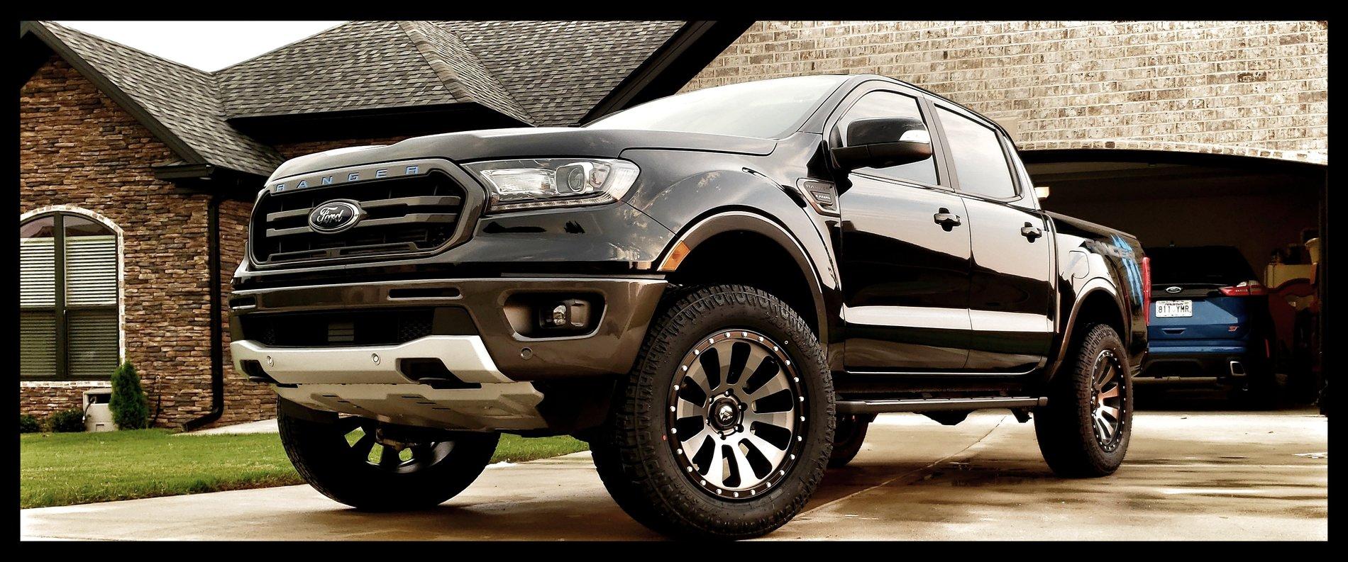

295/55/20 Nitto Terra Grappler
20x9 Fuel Tactic D678 +0 offset
3.5” Rough Country Lift
Absolutely no rubbing at any time after minor trimming to include partial removal of the crash bar (approximately 50-55%).

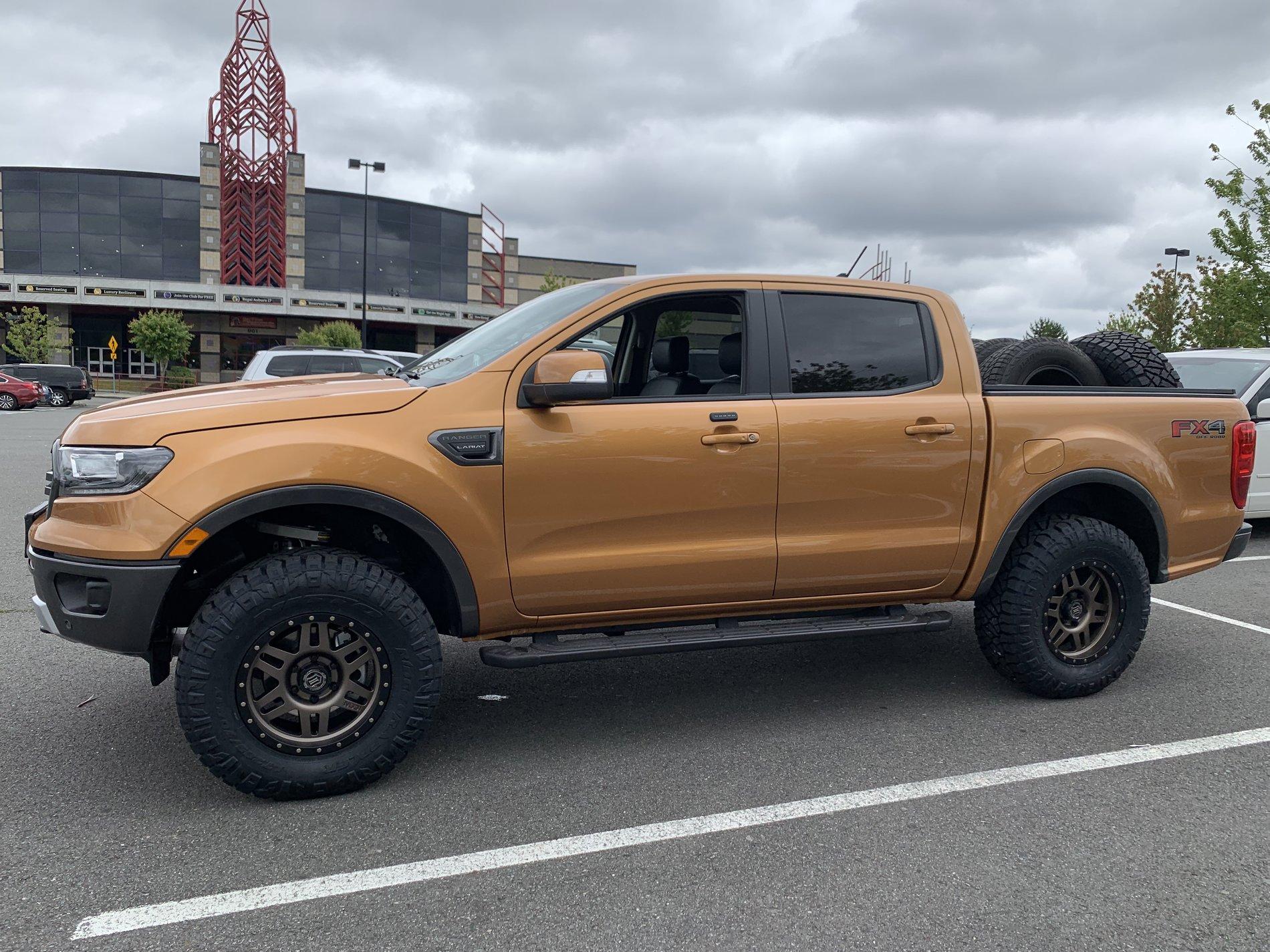

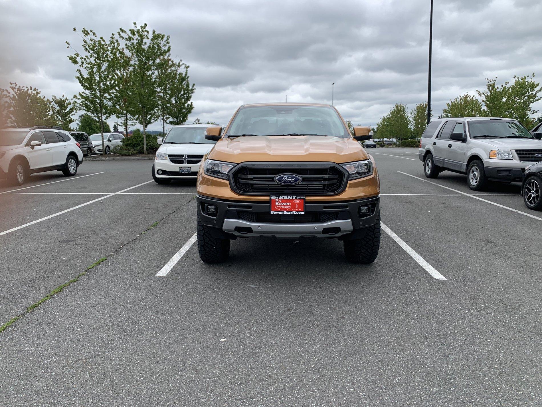

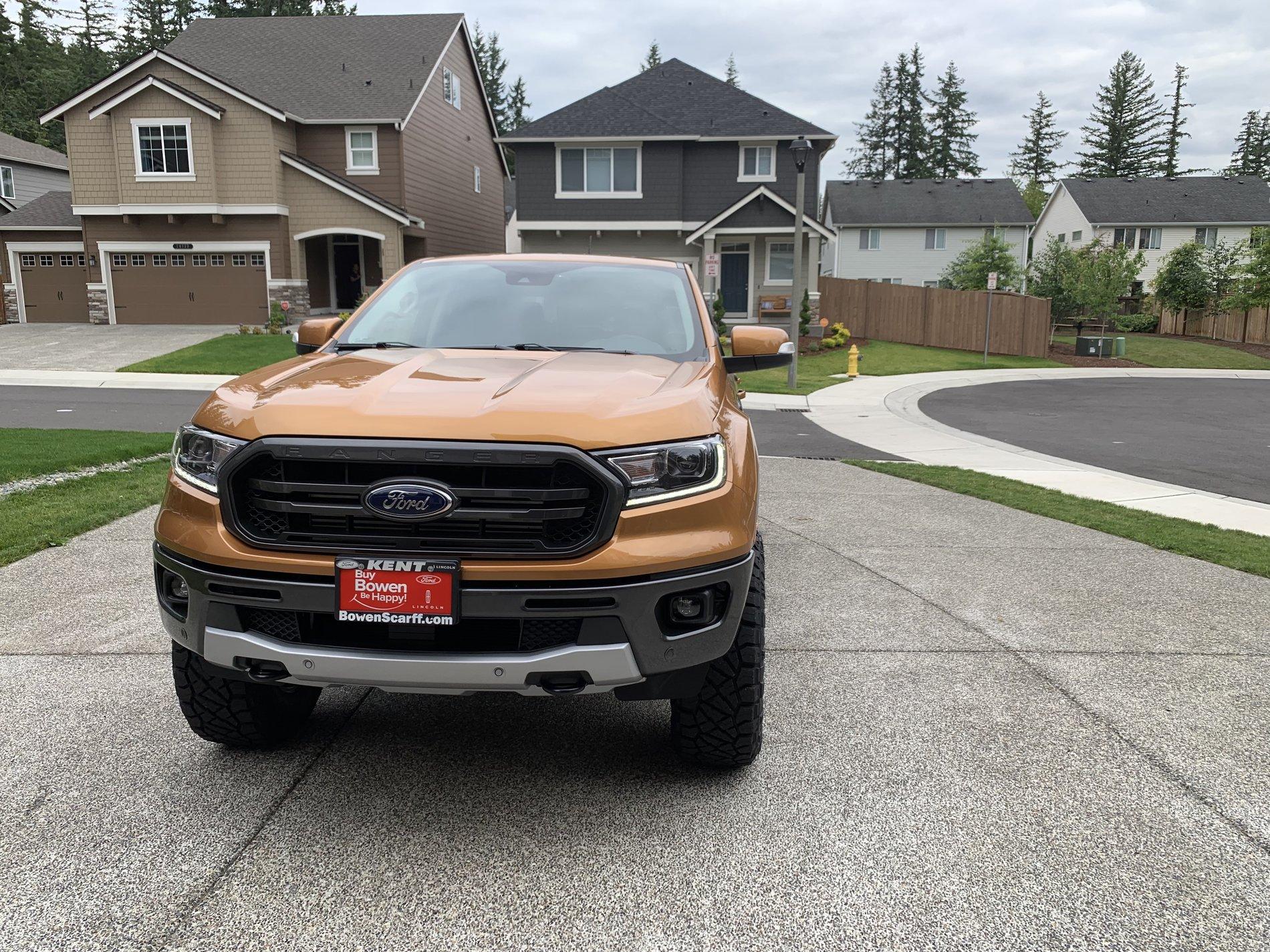

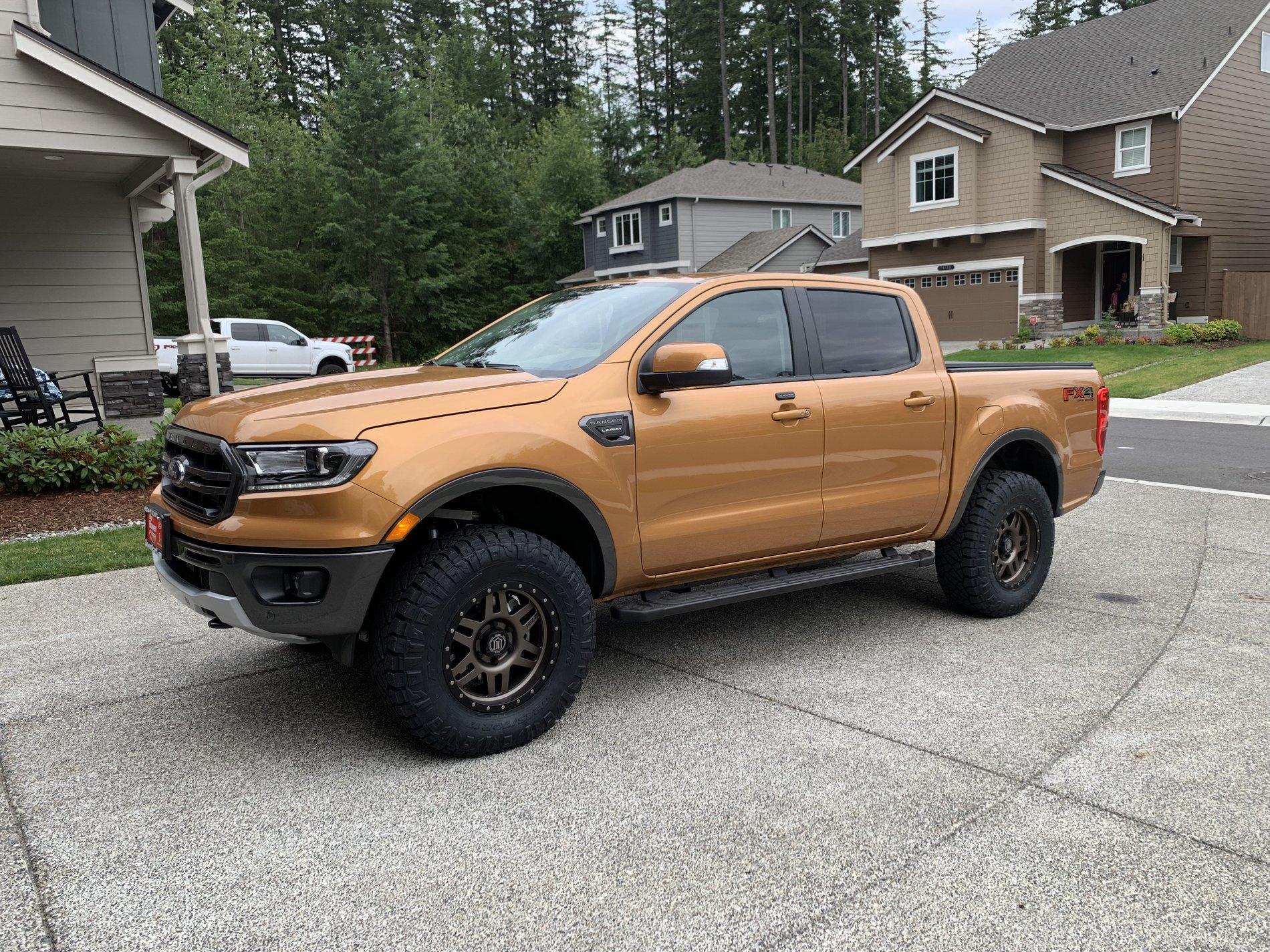

My truck, riding on:
285/70/17 Nitto Ridge Grapplers
17x8.5 - Icon Alloys Six Speed w/ +25 offset (“Ranger spec’d”)
Icon Stage 2 kit w/ 2.5” level and billet UCA
There was some pretty bad rubbing on the front intrusion beams, so my setup includes a Fabtech offset intrusion beam kit and air dam delete (or trim if I weren’t so lazy) as well.
Couple of these were pre-alignment, so there’s some noticeable positive camber there.

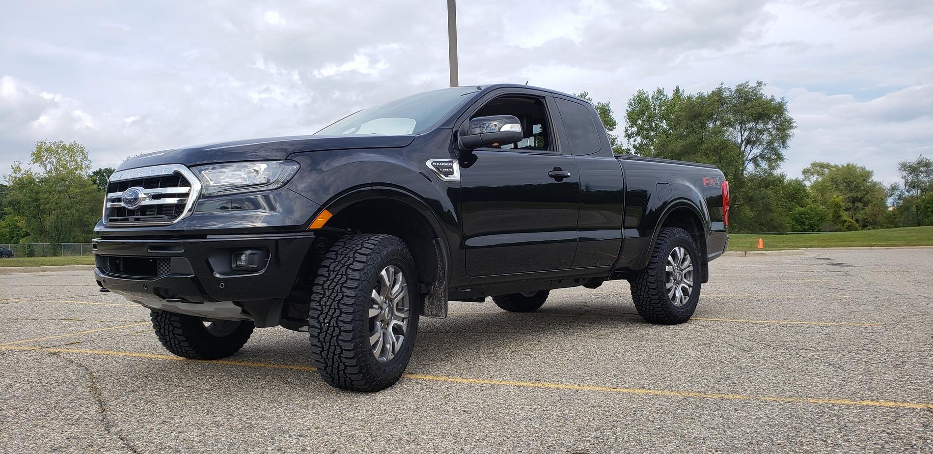

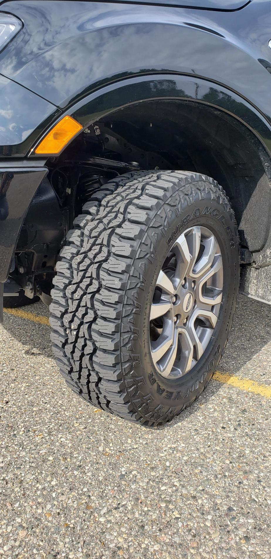

I had a set of Goodyear Wrangler Ultraterrain A/T's in LT275/65R18 installed at Discount Tire today and they do indeed fit. There are also at least one or two other members that have confirmed fitment of the 275/65R18 size here. They fit tight to the knuckle but they seem to be safely do-able. I am also running at Daystar 2 inch front leveling kit. Other than that the truck is all stock, no spacers.

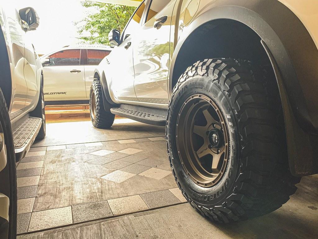

What wheels and offset is that? Did you have to mod or trim anything to get them to fit?
Fuel shok 17x10 -18
Caster adjustment to move the wheel forward
some rubbing in full lock but not to much to require trimming
