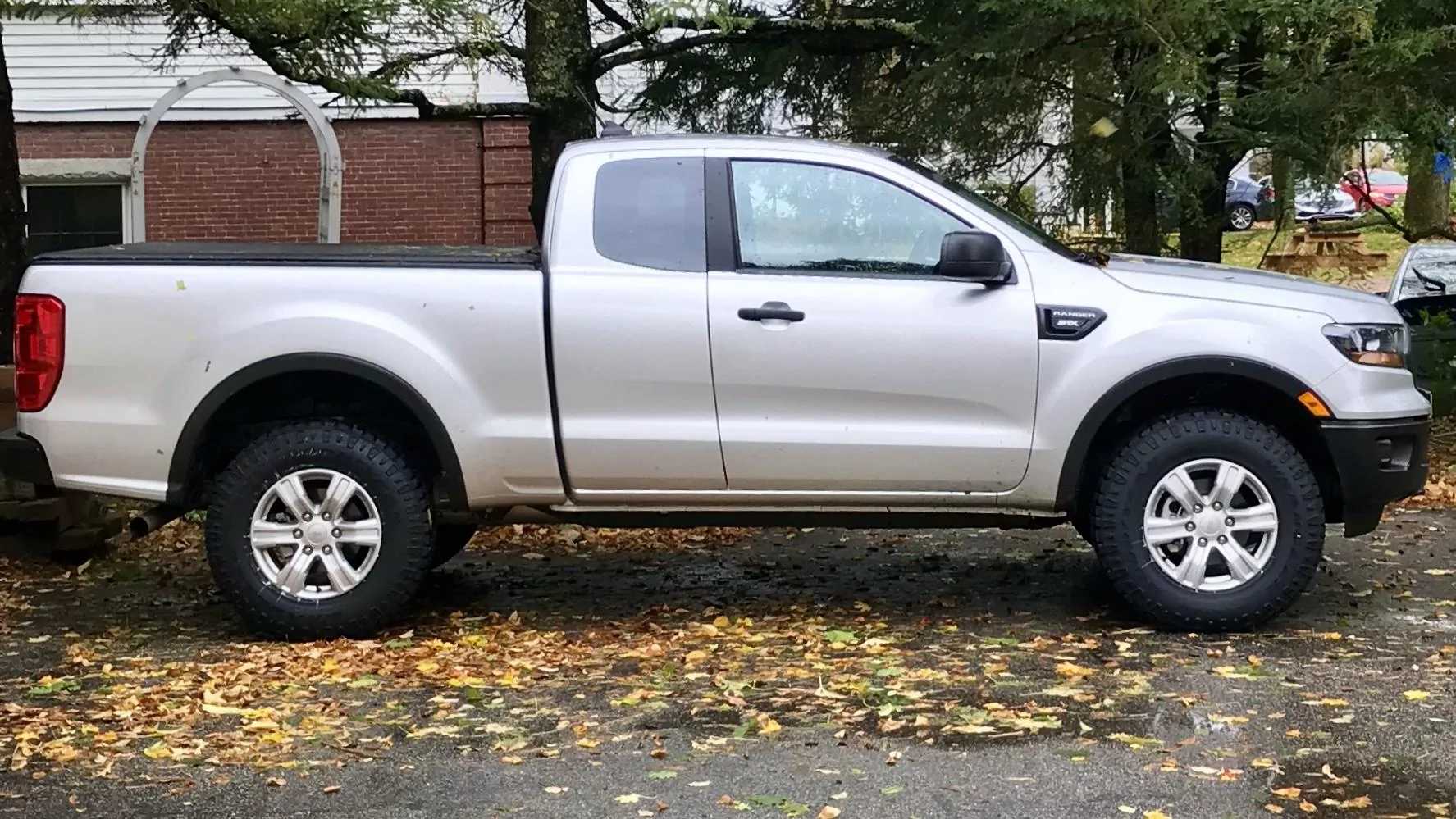

255/75 R17 Goodyear Wrangler Duratrac fits like a glove
Looks awesome! I'm glad to see someone with the silver 6 shooter wheels with different tires. I REALLY want to get wheels someday but I definitely want to upgrade my tires first and was wondering what larger tires would look like on my stock wheels. I'm guessing you're not running any spacers, right? How's the inside clearance? I plan on going with 265/70/17 on my stock wheels.
137,225
I'm running the same size (265) and they fit perfect,no rubbing. You can add spacers if you want to offset the tire some but there not needed with this size. It fills the wheel well in good without losing a lot of mpg's like the 285's. The 285's look really good too but now you're into cutting the crash bars and getting aftermarket replacements.
i posted more of these in the other tire size thread but here is a sample.
255/75R17 Duratrac 32” diameter, 40lbs each.
Yes Stock. Spacers are... not a good idea, and may not be legal in your state.

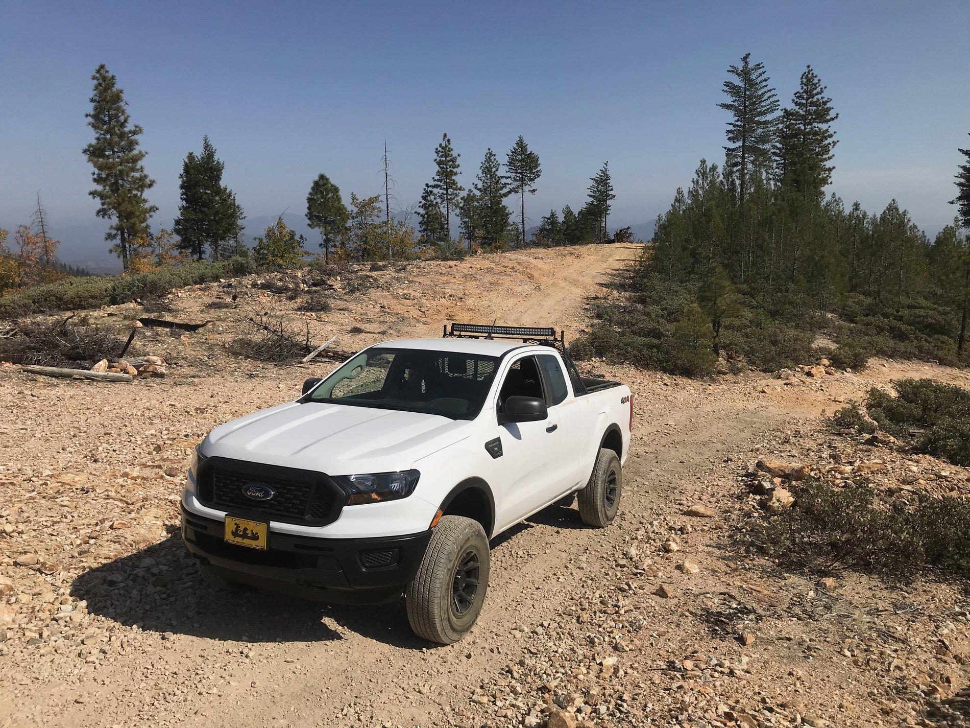

A little surprised more people aren’t running 16” wheels, they seem popular with Tacoma’s and 4 Runners. I have SVC leveling collars, and some 16” 0 offset wheels, just ordered some BFG K02’s 265/75r/16 32”, hopefully get them next week. Currently running the stock duelers 255/70/16, a very flimsy feeling tire, but not terrible
Those BFGs are going to totally change the truck, they’ll look great on there!
