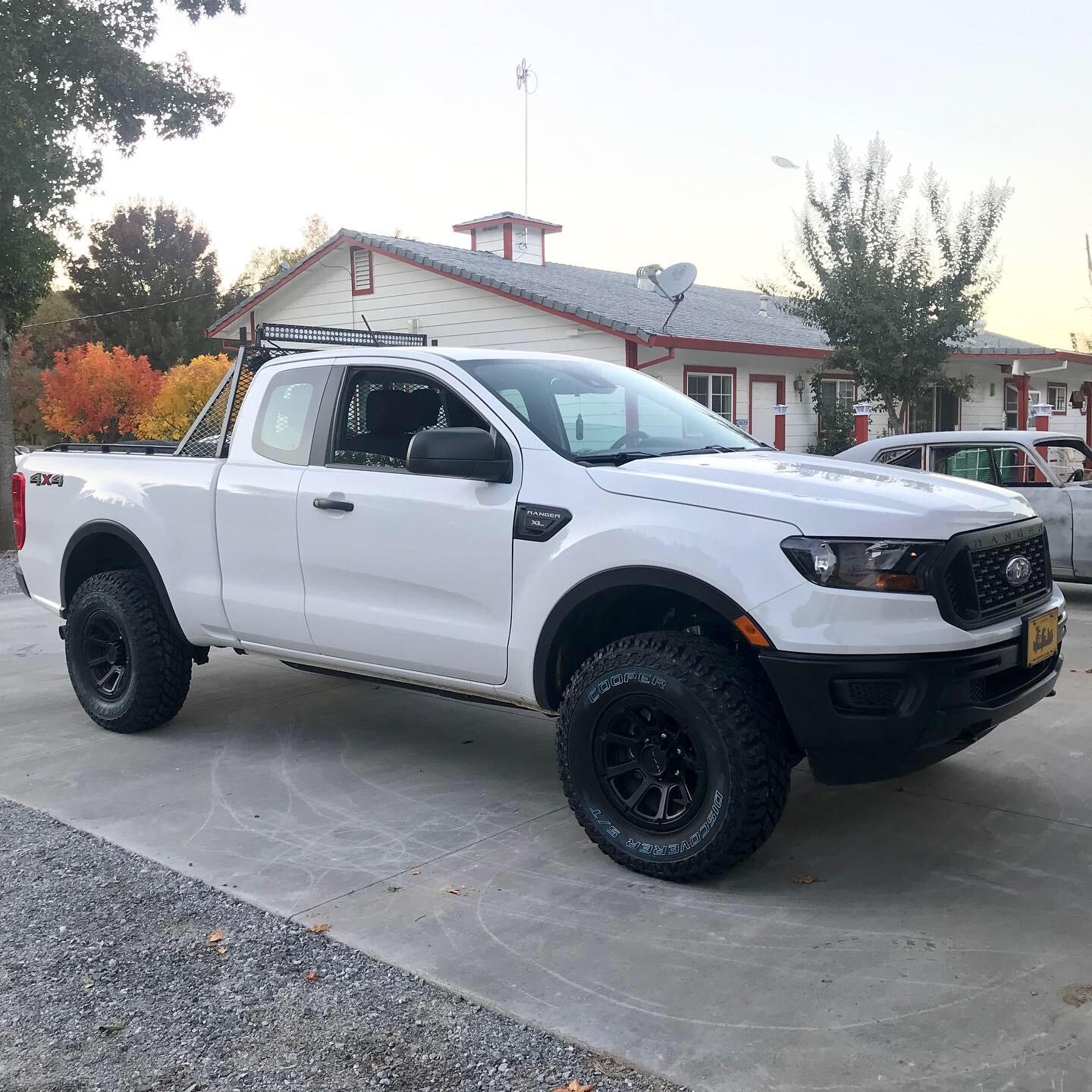

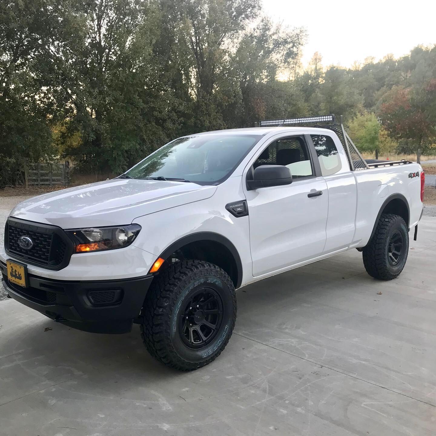

SN13
Sep 14, 2019
223
412
Florida
2019 Ranger XL Oxford White
I ended up going with Cooper Discoverer ST Maxx in a 265/75/16 (32”) They rub a little so crash bars gotta go
Can we get specs on your wheels as well? That really makes a difference with the Lock-2-Lock rub.
MTB-BRUH
Tyler
May 16, 2019
27
667
1,405
Shingletown CA
2019 Ranger Base
Shop Manager
They’re a 16x8 with 0 offset, with crash bars removed no rub

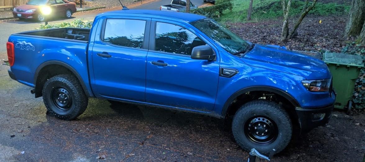

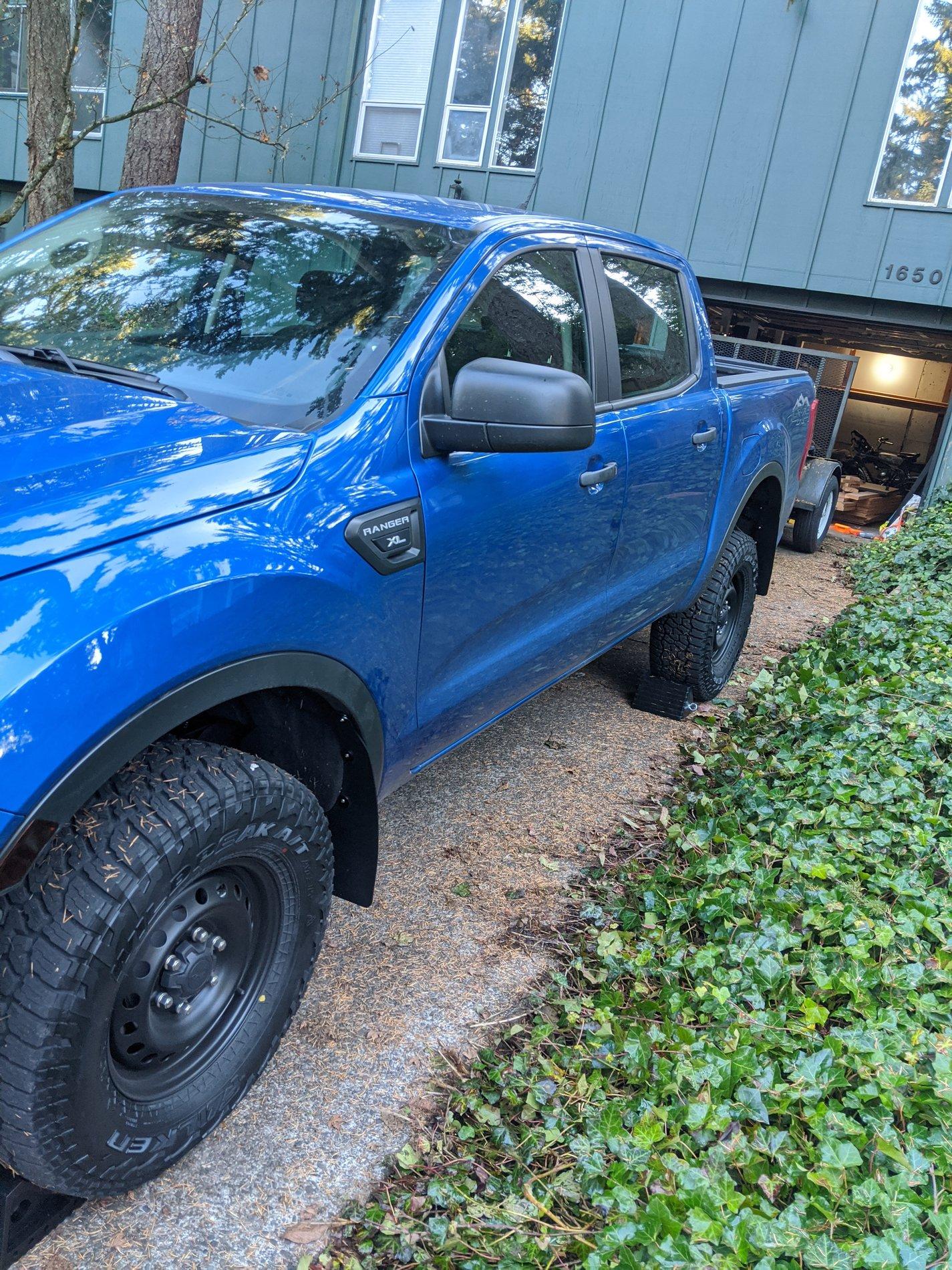

Tangent
Joe
Oct 27, 2019
126
202
Oregon US
2019 Ford XL Ranger 4x4 Supercrew
Didn't go as daring as others, but haven't seen anyone else with this size so thought I'd throw in for reference.
Old tires: Stock 255/70/R16 Bridgestone Duelers
New tires: 265/70/R16 Falken Wildpeaks (+0.5" same size as stock 17")
I dig the look more than I would have thought. Might not even upgrade to a 17" wheel, currently running the base level steel wheels rattlecanned matte black w/matte clearcoat.
