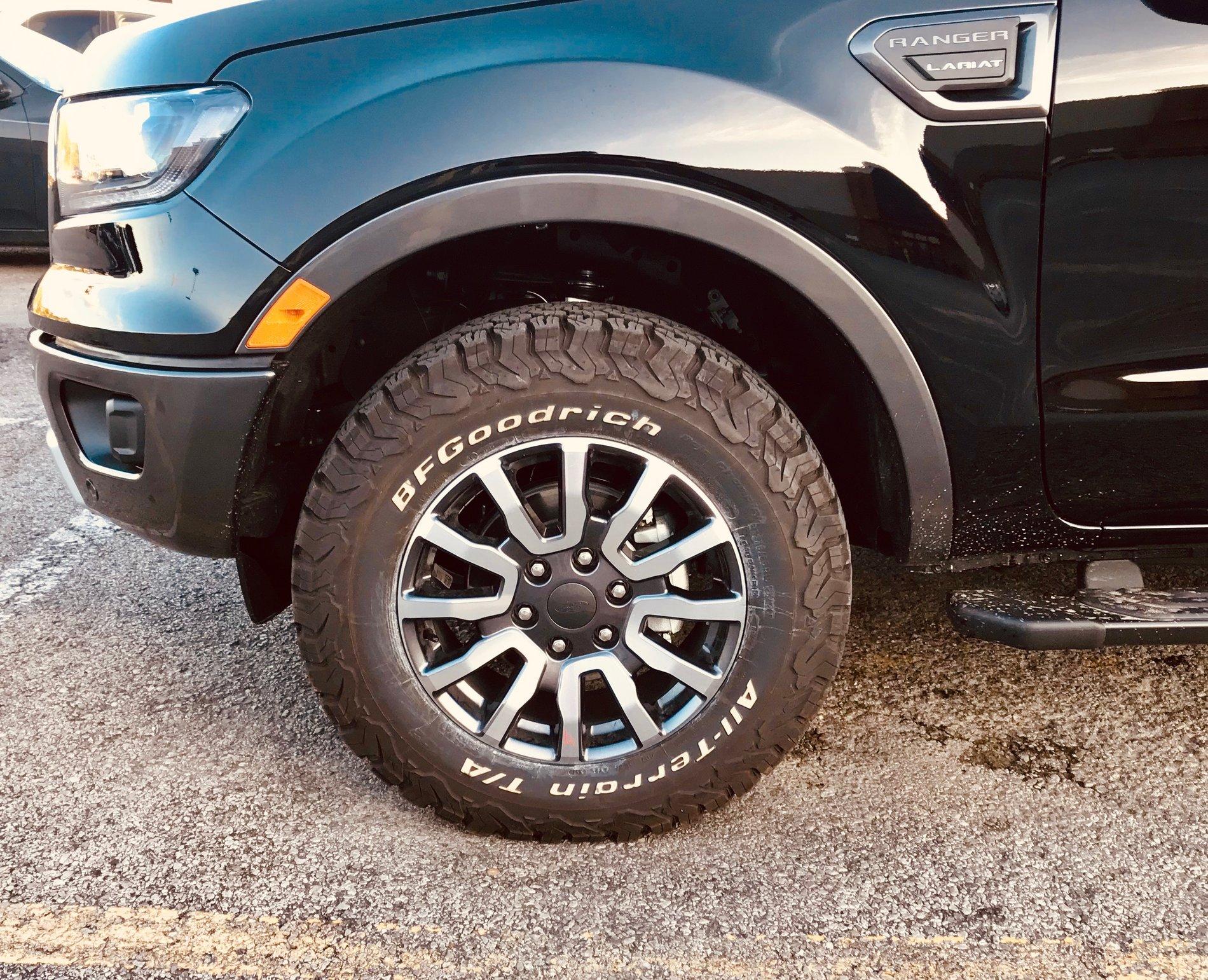

Over the weekend I traded a Jeep Grand Cherokee that was running 275/65R18 BFG AT KO2's. In the trade I asked for the tires to be swapped if they fit...Just got home from the dealer a couple of hours ago. They swapped the tires and took the truck out for a quick test drive. Happy to report that they came back and said "no rubbing."
I will say this though- they are VERY close to the front intrusion beams. I am sure that under suspension flex they would rub slightly, but even coming to the bottom of a down slope with the wheels turned I did not rub. I am ordering a set of the FabTech angled intrusion beams though, just to make sure! And a leveling kit is on its way already...
As for the spindle clearance, these tires actually have MORE clearance than the stock Hankooks! Because they are almost two inches larger in diameter, the widest part of the tire is higher and due to the curvature of the spindle there is quite a bit more room.
My Ranger is stock, no leveling kit or anything. I will try and take pics when it is light out and post them.

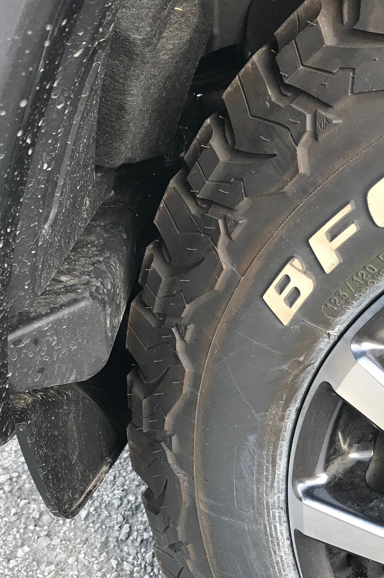

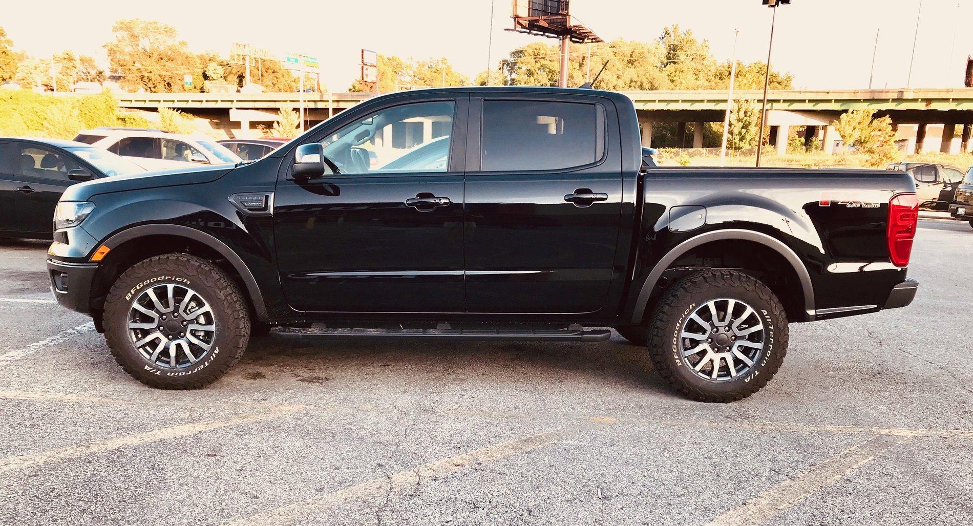

Current set up of the truck- SuperCrew Lariat FX4 with Sport and Tow packages. Here is a pic of the BFG's (275/65R18), along with shots of the VERY tight front crash bar clearance and the spindle clearance. I have a solid 1/2 inch clearance on the spindle....wish I had that on the front! Modified crash bars shipped today, I will baby this thing until they get here...

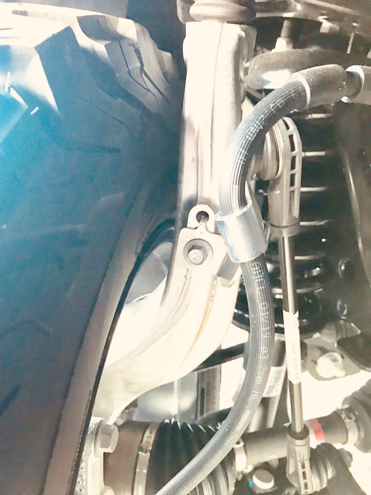

Hi Folks,
I would like to take this opportunity to enlighten you on one thing Ford Testing does..It is called a Jounce Study. the vehicle is put on a hoist, a dual piston that lifts the front and rear independently. The vehicle is lifted to about 5 ft. At both hoists, front and rear are giant bullrings and the vehicle frame is cabled with huge stranded cables so the vehicle cannot move. Then each wheel is raised to its maximum suspension travel (with jounce bumpers removed). Then the front suspension is rotated to the right lock for the left side tire, for example and the vehicle is inspected for any rubbing., including brake hoses, crash bars as you call them etc. If anything is identified, then there are are redesigns. Then the vehicle is rotated left and again inspected. Then the right side is inspected. Then the left rear, only that there is no steering input...Then the right side rear is done as well.
I will bet none of you with larger wheels, changed offsets, added spacer, larger tires go through this above through study.
So how many of you think you are not going to rub a brake hose? Like I have said before, when you modify your vehicle, you are in uncharted territory.
Please take this as an FYI on how Ford engineering does testing to certify vehicles for sale. My goal is not $hit in your Easter Basket, but explain things you should consider when you embarking on modifications.

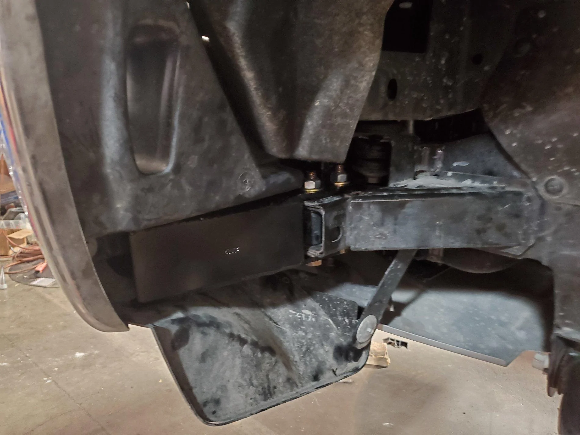

@ChopprJock which modified crash bars? is that clearance at full lock or straight wheel?
@P. A. Schilke Thanks for the perspective on the thorough testing. I think most owners find out the hard way first and then buy the parts to fix it (tires first, modified crash bars later :sunglasses:). There is also usually decent aftermarket support for offroaders where a supplier will provide brake line relocation brackets for example. I think we are still all learning the new Ranger to know what to look out for to be safe.
themikeyan
Mar 3, 2019
319
481
LA, CA
19 Lariat FX4
https://www.rogue-offroad.com/product-p/fts22296.htm
I installed these the other day, fitment is pretty good but I needed to finesse one of them
