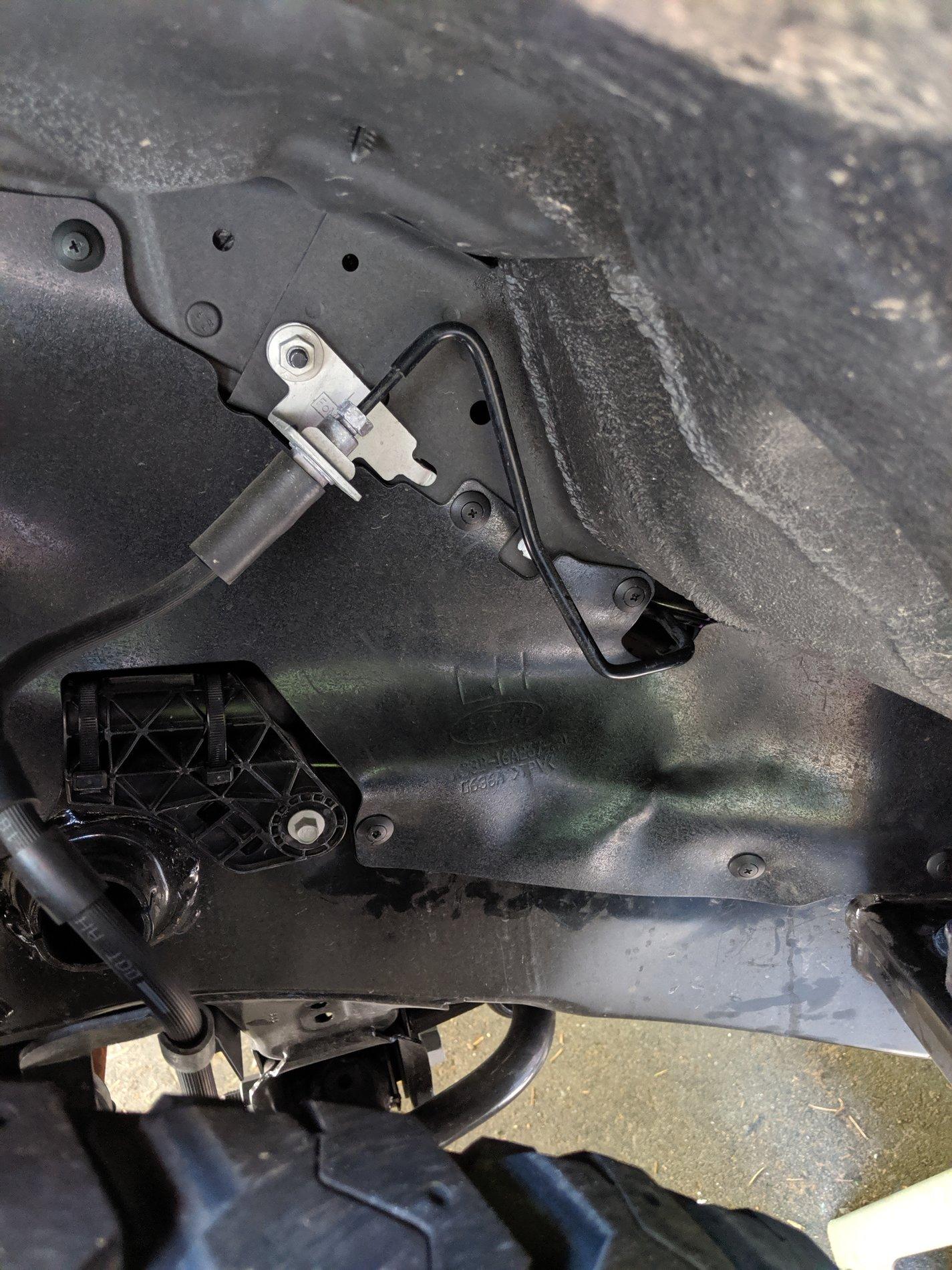

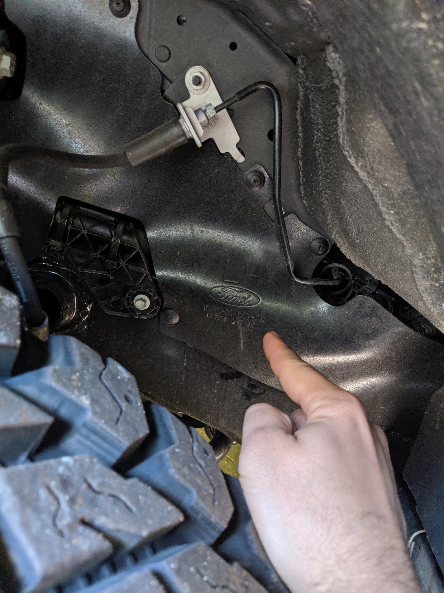

255/80/17r Cooper discovery maxx fit with mild trimming/reforming of the inside liner that covers the engine bay. Mine appeared to be sticking out and I got it to where I wanted. No rub at full lock and I've had a fair bit of compression, so I think these are the easiest 33s to get on there.
