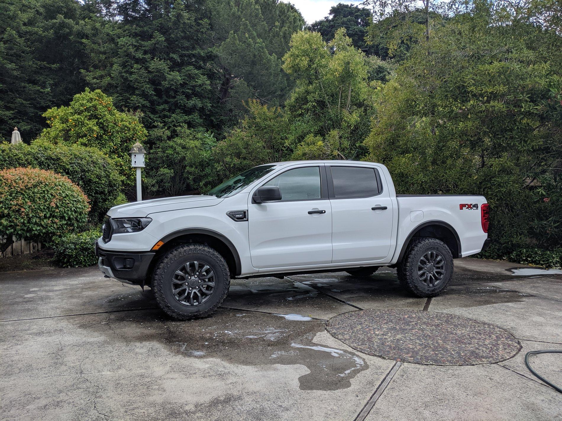

I am going to the shop tomorrow to have my 285/70/17 installed with my rough country 2.5" leveling kit. I can post photos and let you know about any rubbing! I went with the brand new Yokohama X-A/T's. Check them out!
Great thanks, I am a little dissapointed though I just found out Nitto does not make the 275/70/17 tire size, guess I will check the Yoko's
