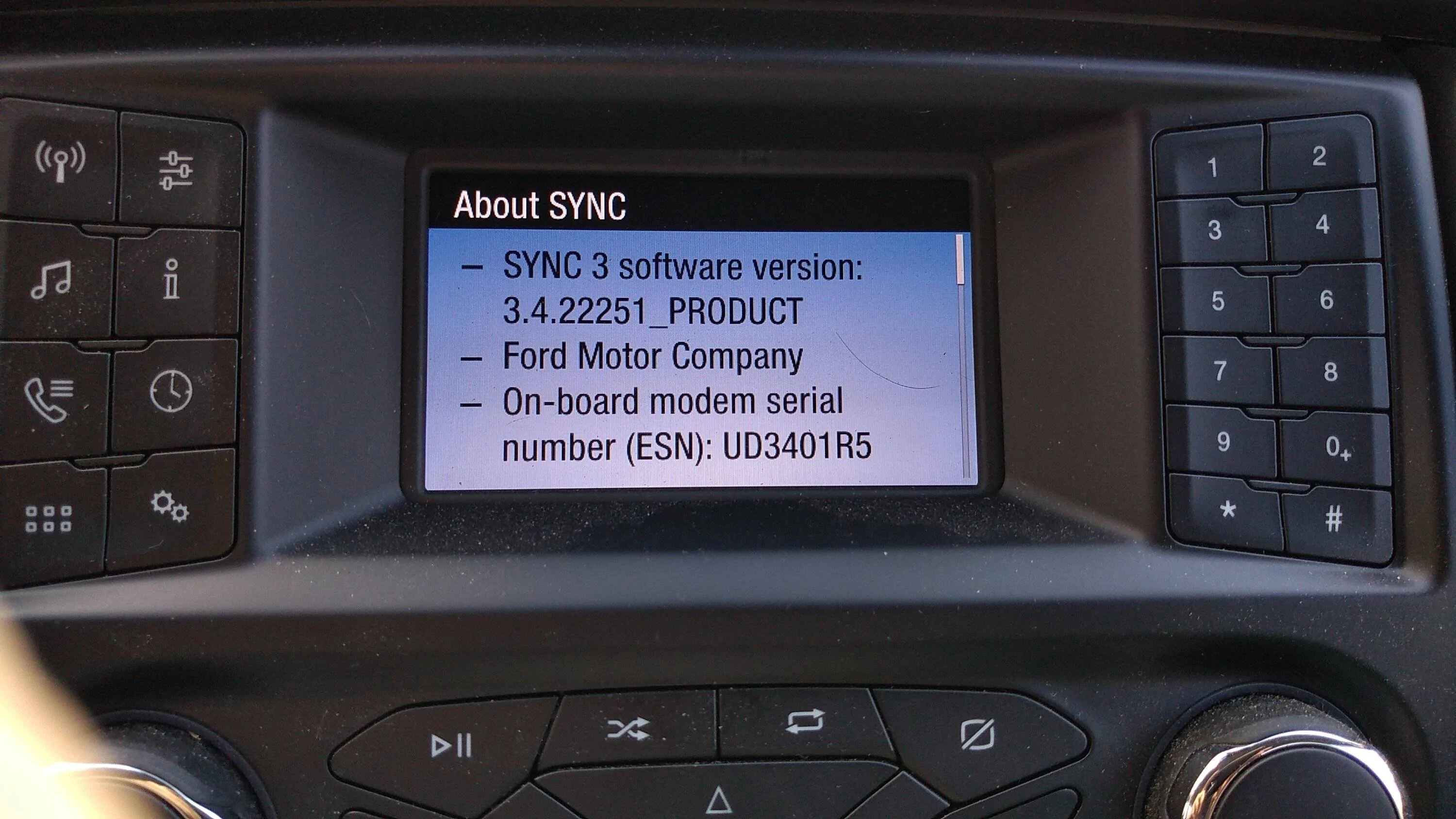

Ford says I have update v. 3.4.23088 available, but when I downloaded the update, it was still v. 3.4.22251. Anyone else seeing that 3.4.23088 is available?

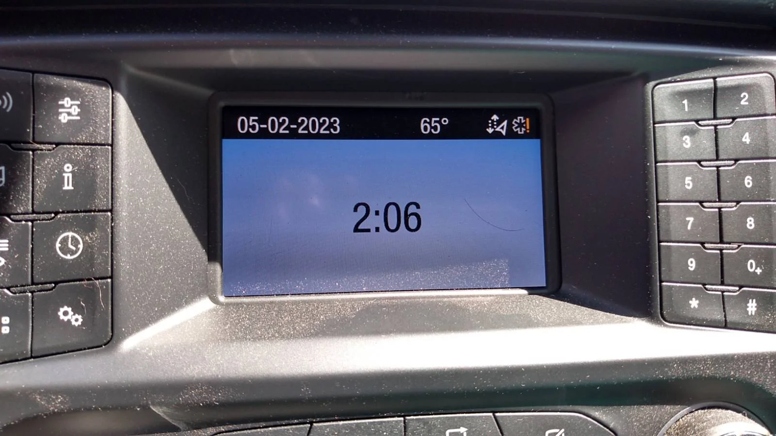

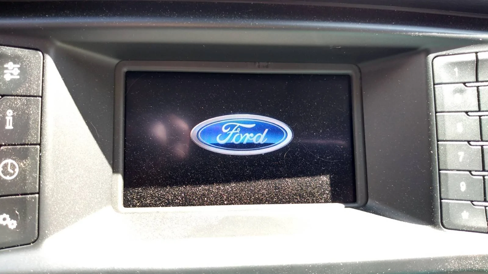

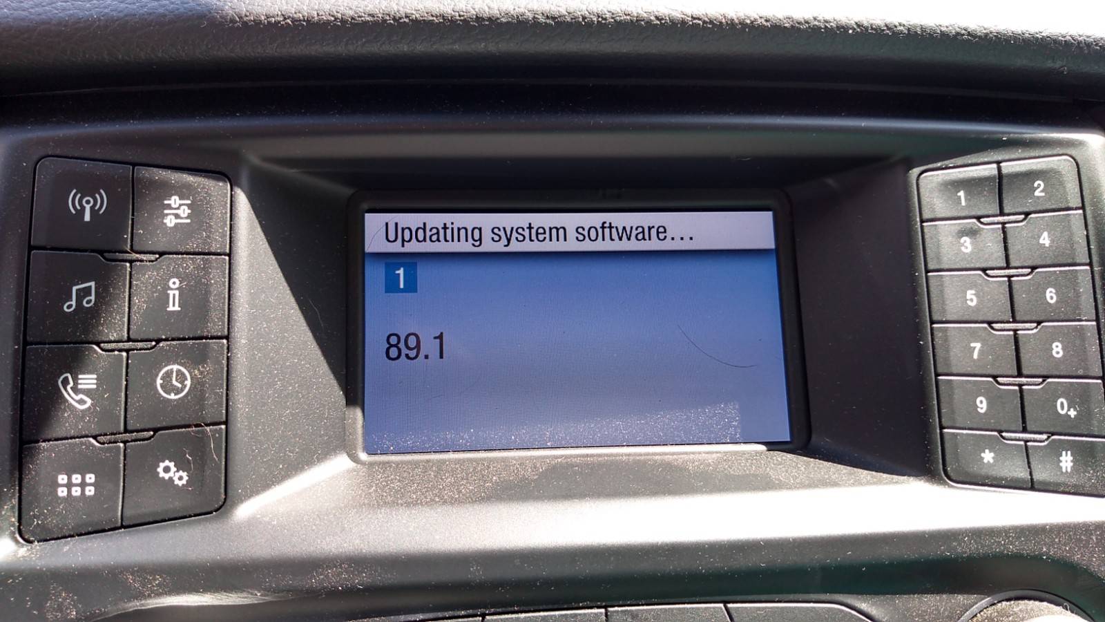

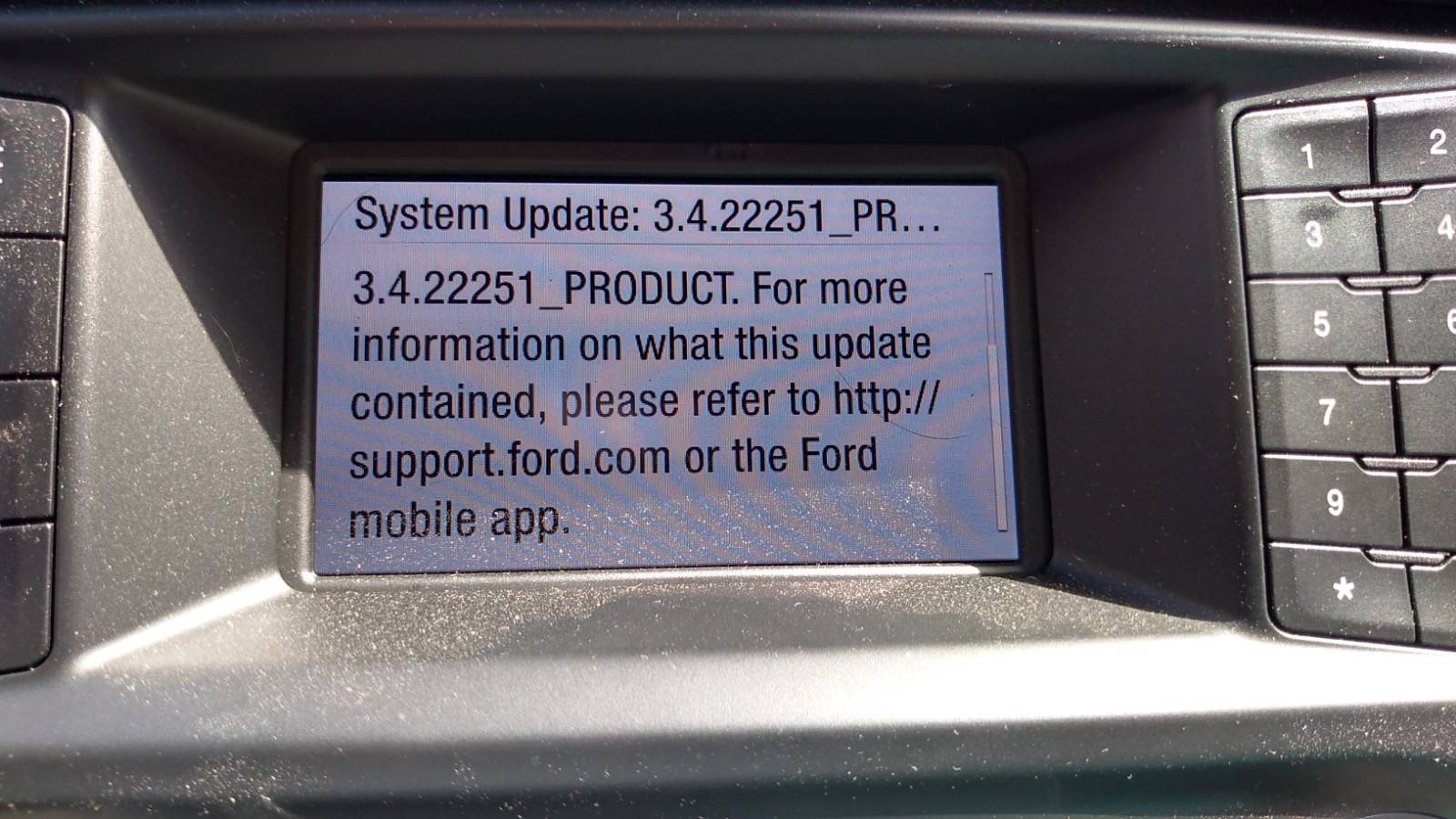

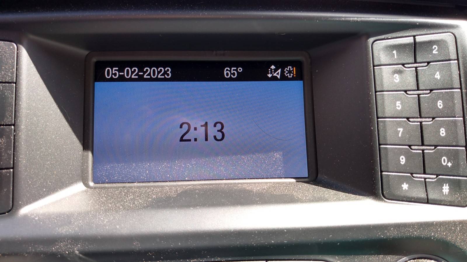

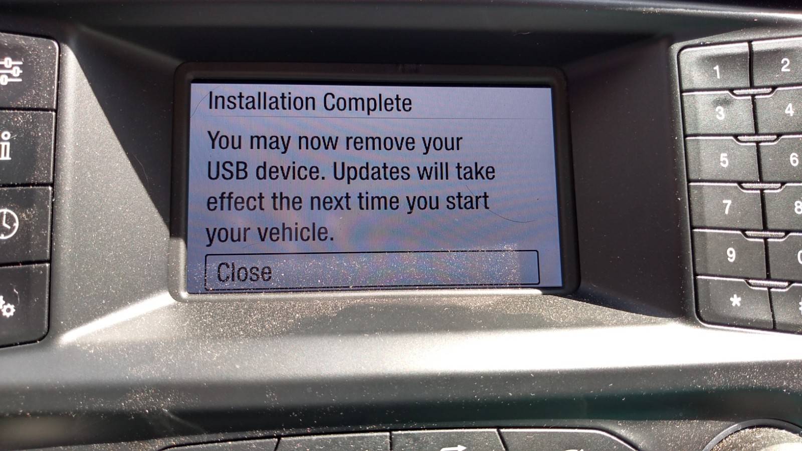

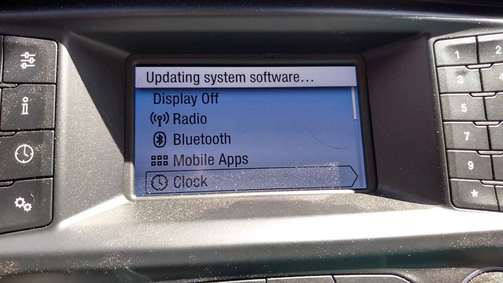

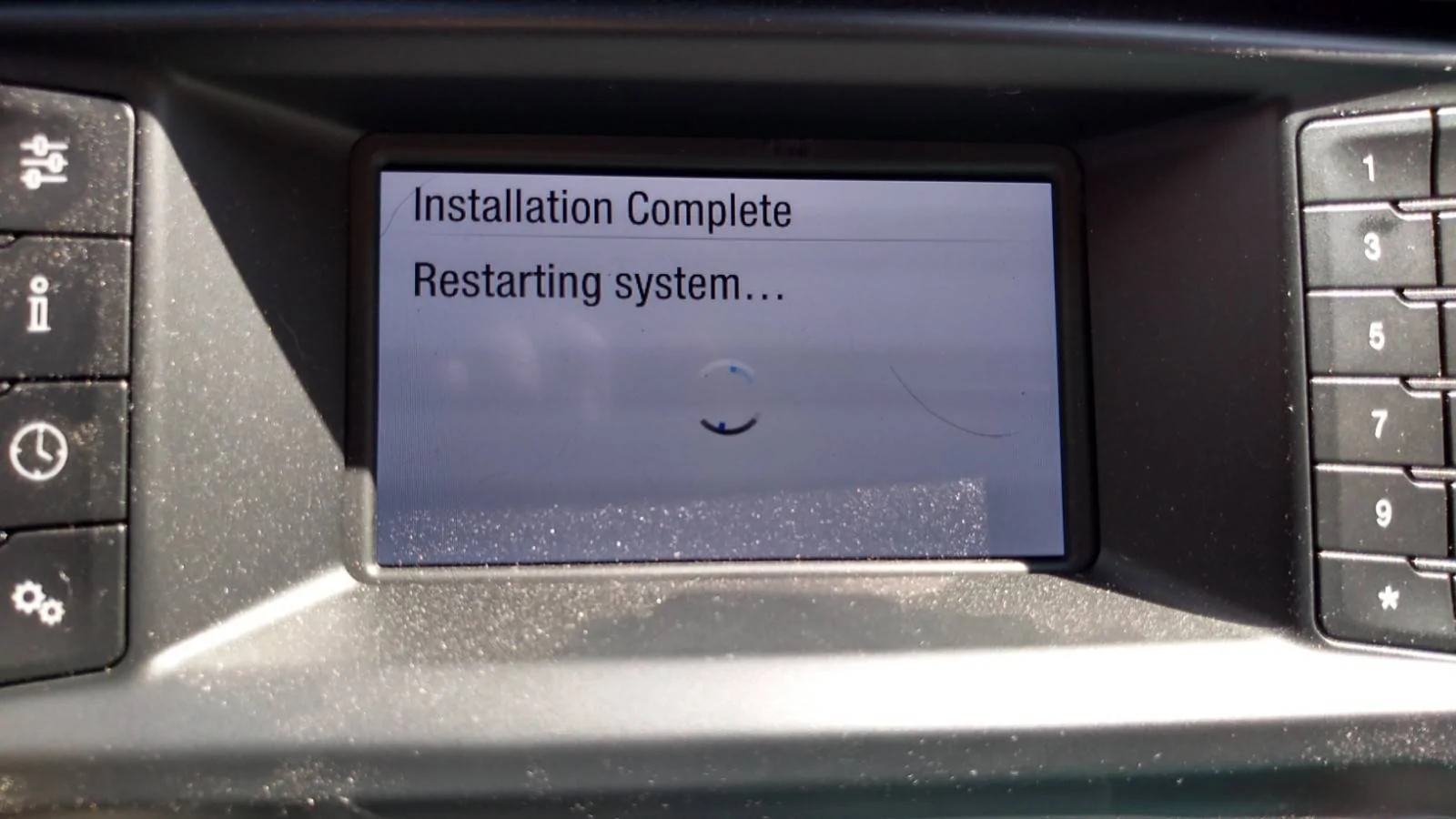

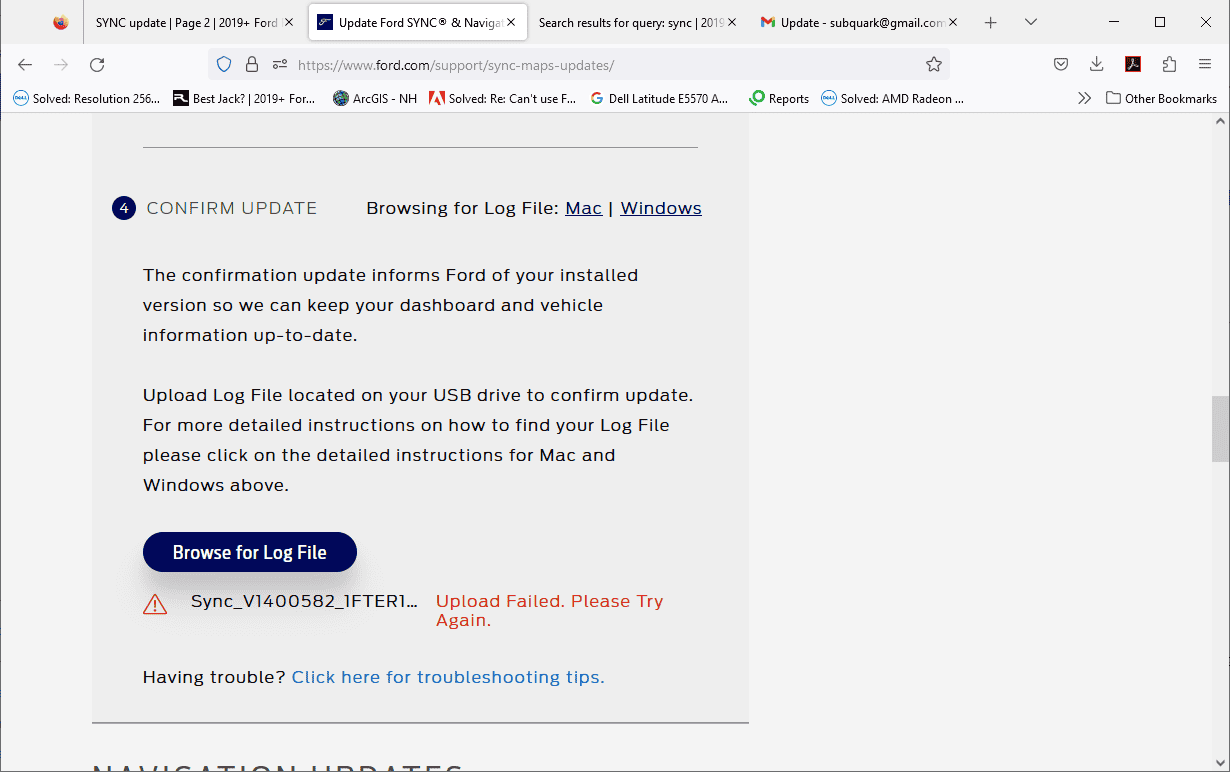

I did the update for my XL today, of course, the confirmation file won't upload, but the rest was easy. Last version was 3.4.22200 back on October 27th and this one is 3.4.22251.
Now mine is the 4" unProductivity screen that only lets me make phone calls and see the backup camera.
My date is still wrong though, derr, it's a day ahead but may fix itself if I go further than 1.6 miles to the dump and IF I turn on location on my phone.
Anyway ... did the USB method with the truck running and it took about 10 minutes.
start Soupie, wrong date, bah, insert USB
first message after 20 seconds, then on for about 8 or 9 minutes
next message

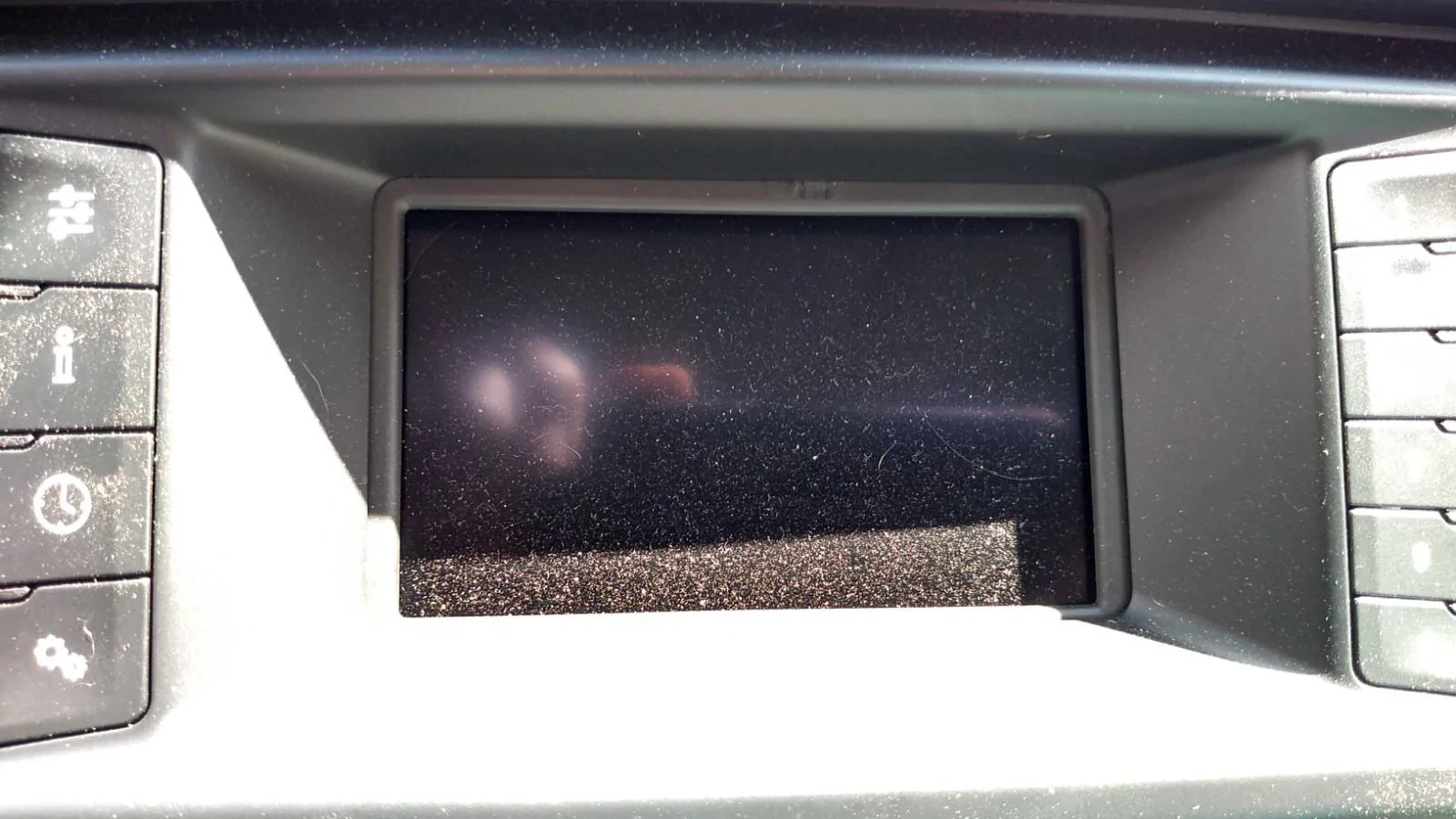

screen goes blank for about 15 seconds
logo comes up

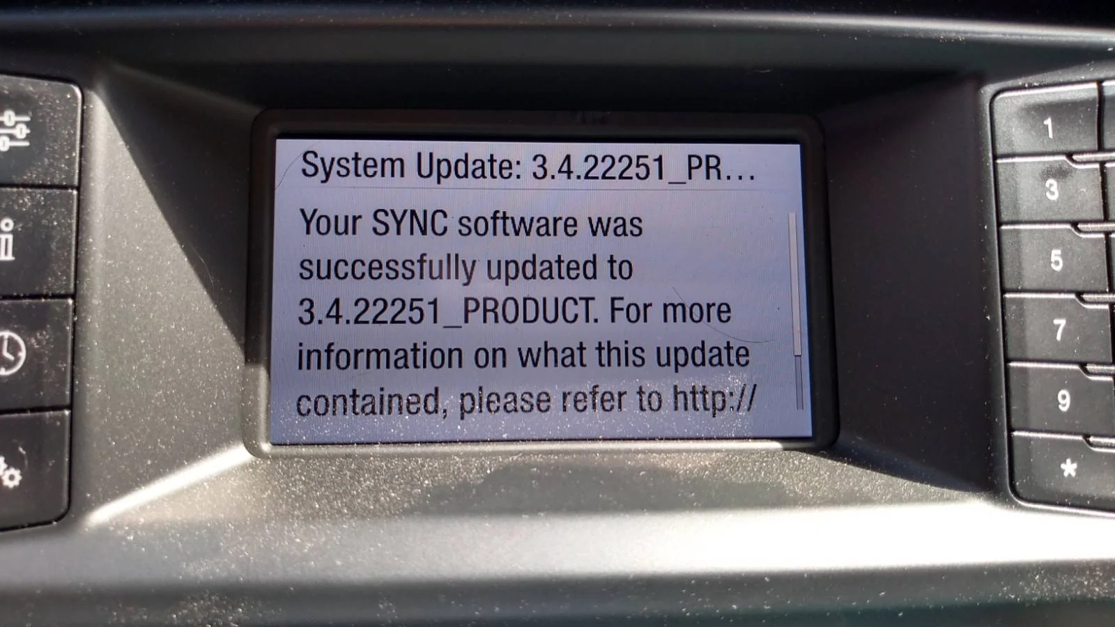

normal screen is back, still wrong date

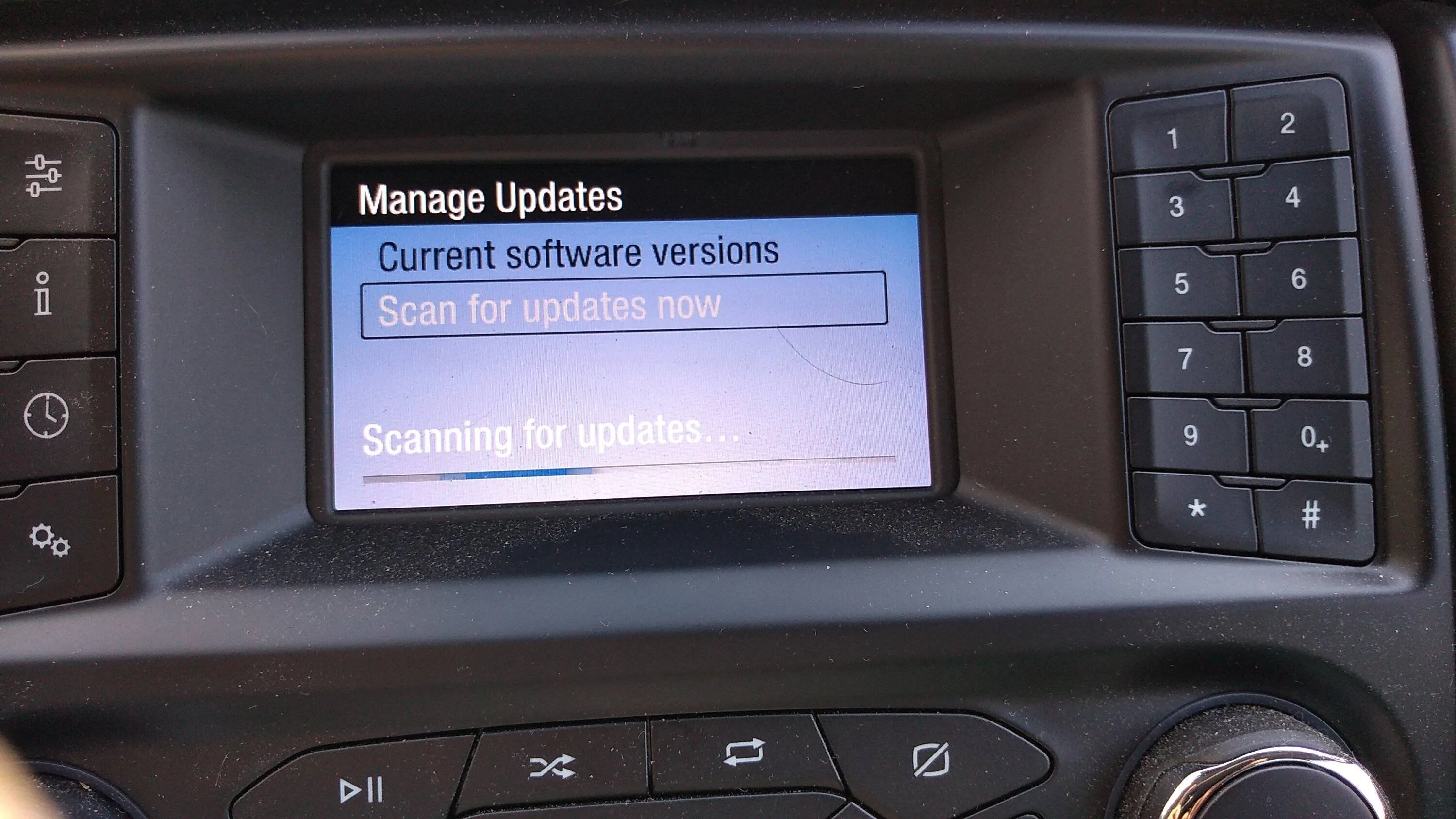

then this came up when I went looking for update info, on for about 15 seconds
then this one
then looked for system info
ford fail, again ...
then this one
If you don't have navigation it will only update to 3.4.22251 even though you installed the 3.4.23088 update.
then this one

I was told by Ford that the confirmation upload is no longer available. You'd think they would change their instructions by now to eliminate that step.

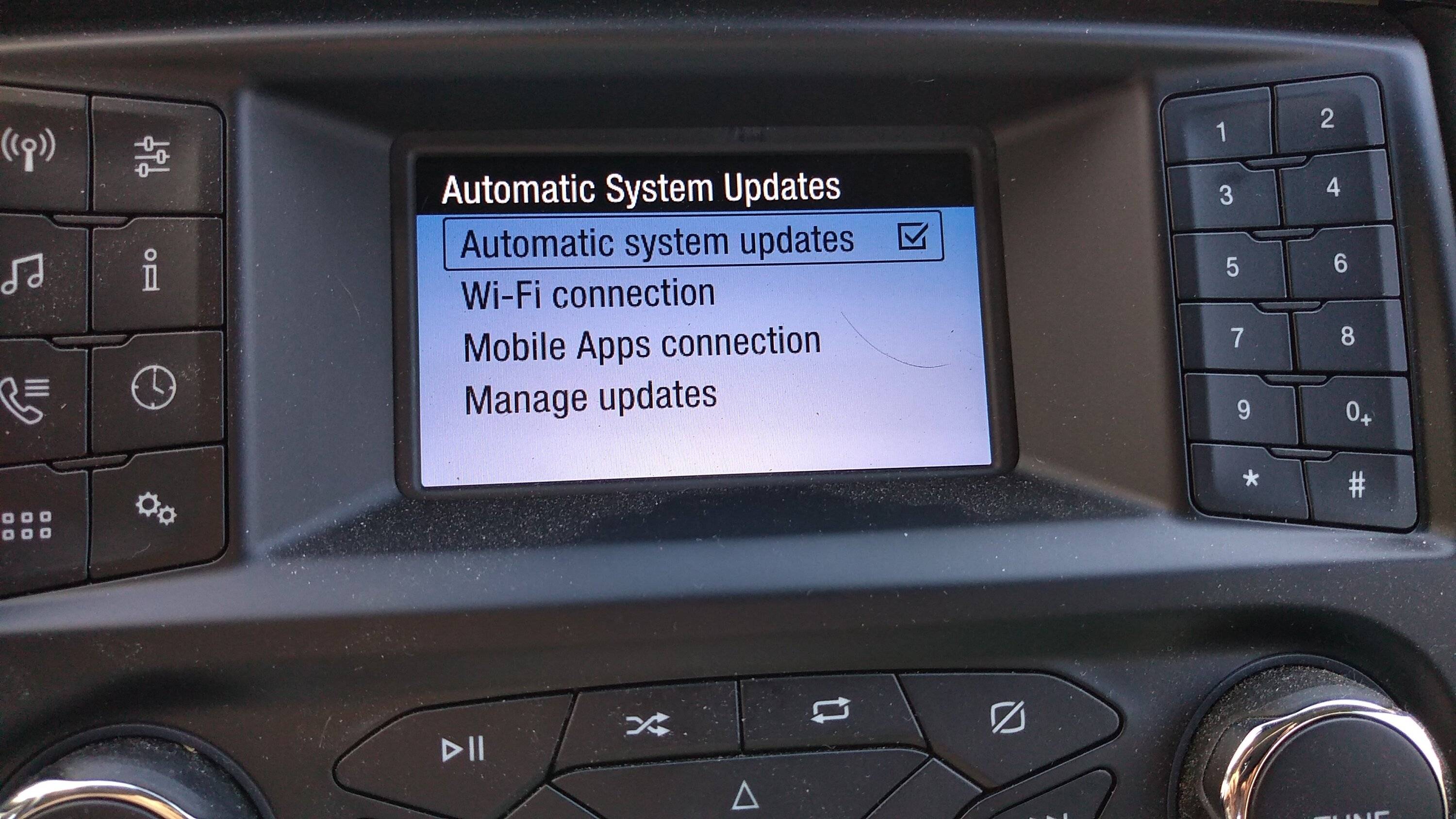

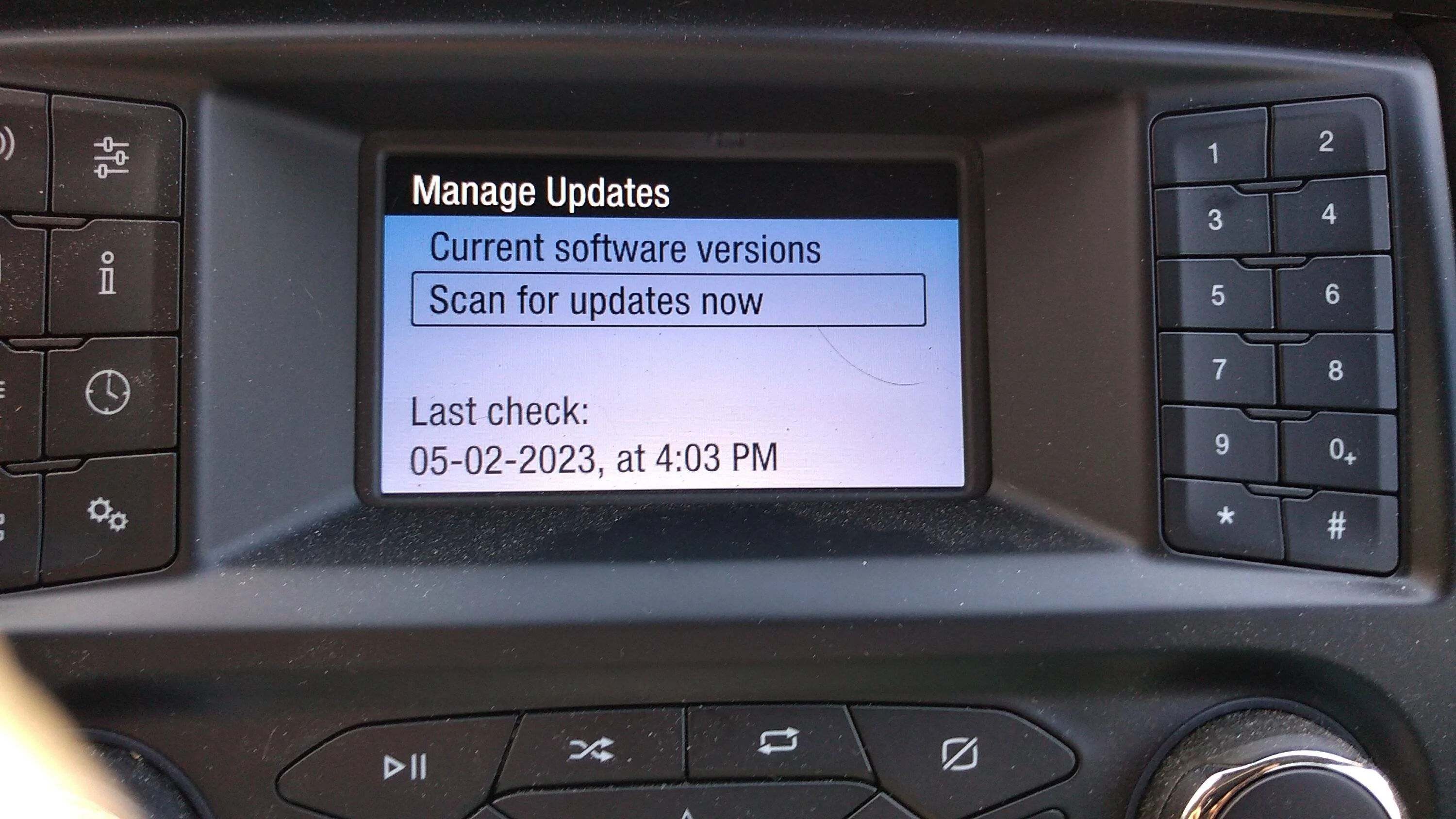

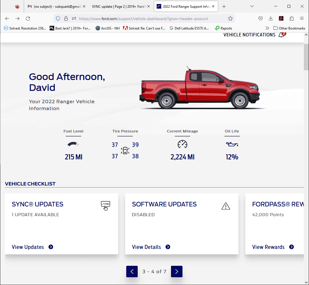

A little off topic. Is anyone else's software updates disabled? Although I have software updates enabled on the truck my dashboard at Ford.com says it is disabled.
4,554
23,153
I just logged back in to my online account at Ford.com and mine shows disabled too! =(
And on my Ford App, I couldn't find it.

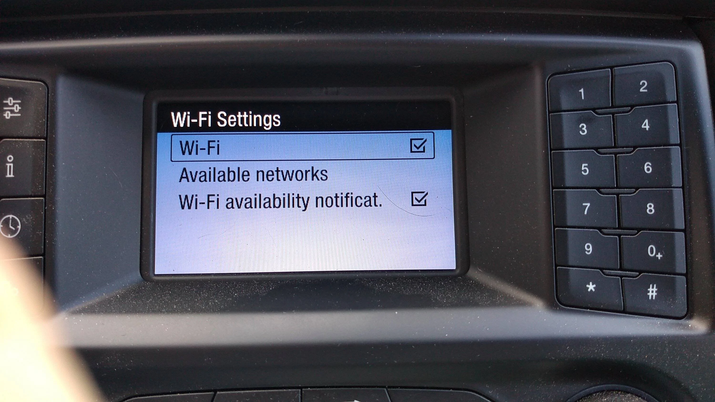

I then went to the truck and it is enabled there. Is your wi-fi also turned on?
yah, still wrong date ...
Yep. Second time this has happened.
Well that sucks. Ford still shows mine as 21194.....truck shows 22251.
4,554
23,153
Same here, mine never updated and I'm parked close enough to the home router. It never did the one from late October and won't do either confirmation file for the two times I've done updates.
I figure the truck itself shows it, so if anything ever came up, I'm not worried about it.
