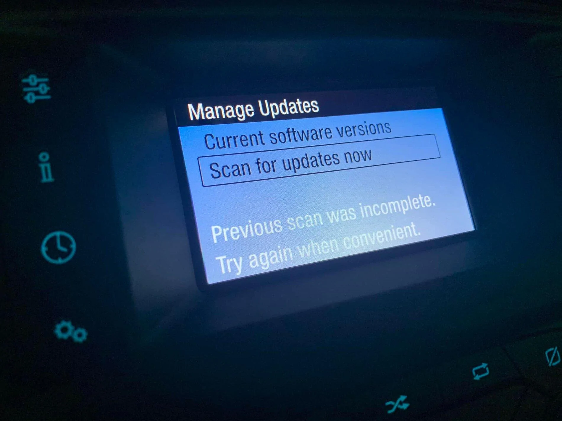

Tried the USB update a couple of months ago, and no luck. Tried WiFi too, that said "It's up to date". Now I thought I’d try again on WiFi and this comes up. I scanned for update and this pops up again. Tried a few other times well in range of WiFi no luck. (XL/STX with a 101a package.)

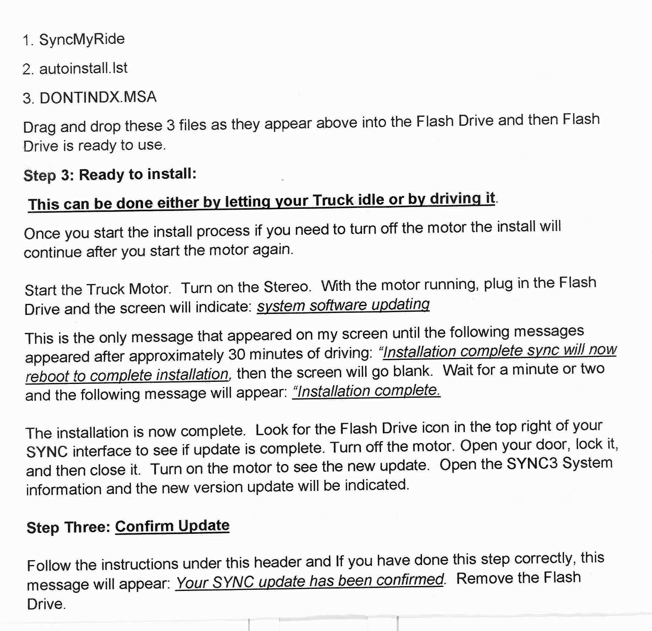

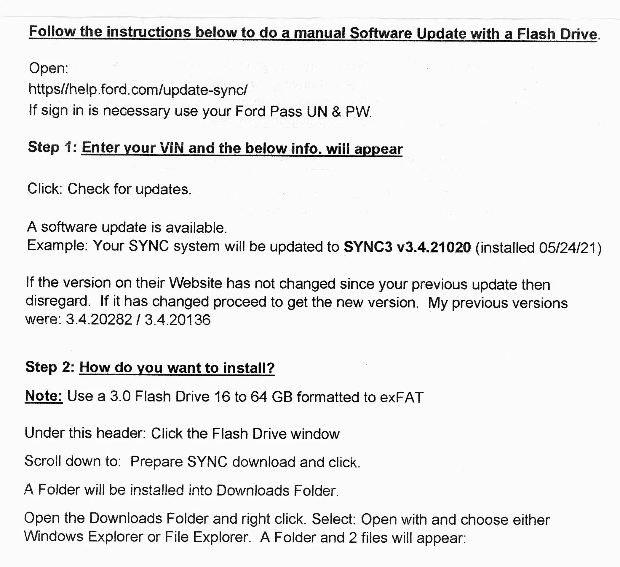

Have never been able to update successfully with Wifi so I use a Flash Drive. FordPass is supposed to inform of new updates, but I never got them so have to check online for them. I updated to 3.4.21194 (latest version) last month with a flash drive and it has worked well so far.
Here are the instructions that Ford gave me to do an update (hope this helps):
