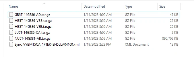

From my vehicle maintenance log:
01-19-23 6,007 miles
Updated SYNC from Build 22200 to Build 22251 using the software download from Ford website onto a thumb drive. Received the XML file after the update was complete (about 20 minutes). Uploaded the XML file to Ford.
Files on the thumb drive:
