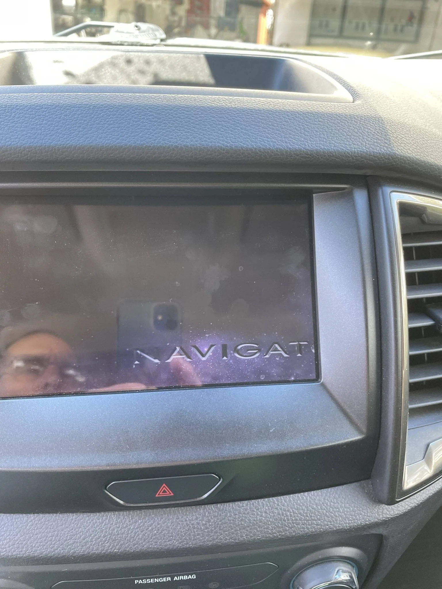

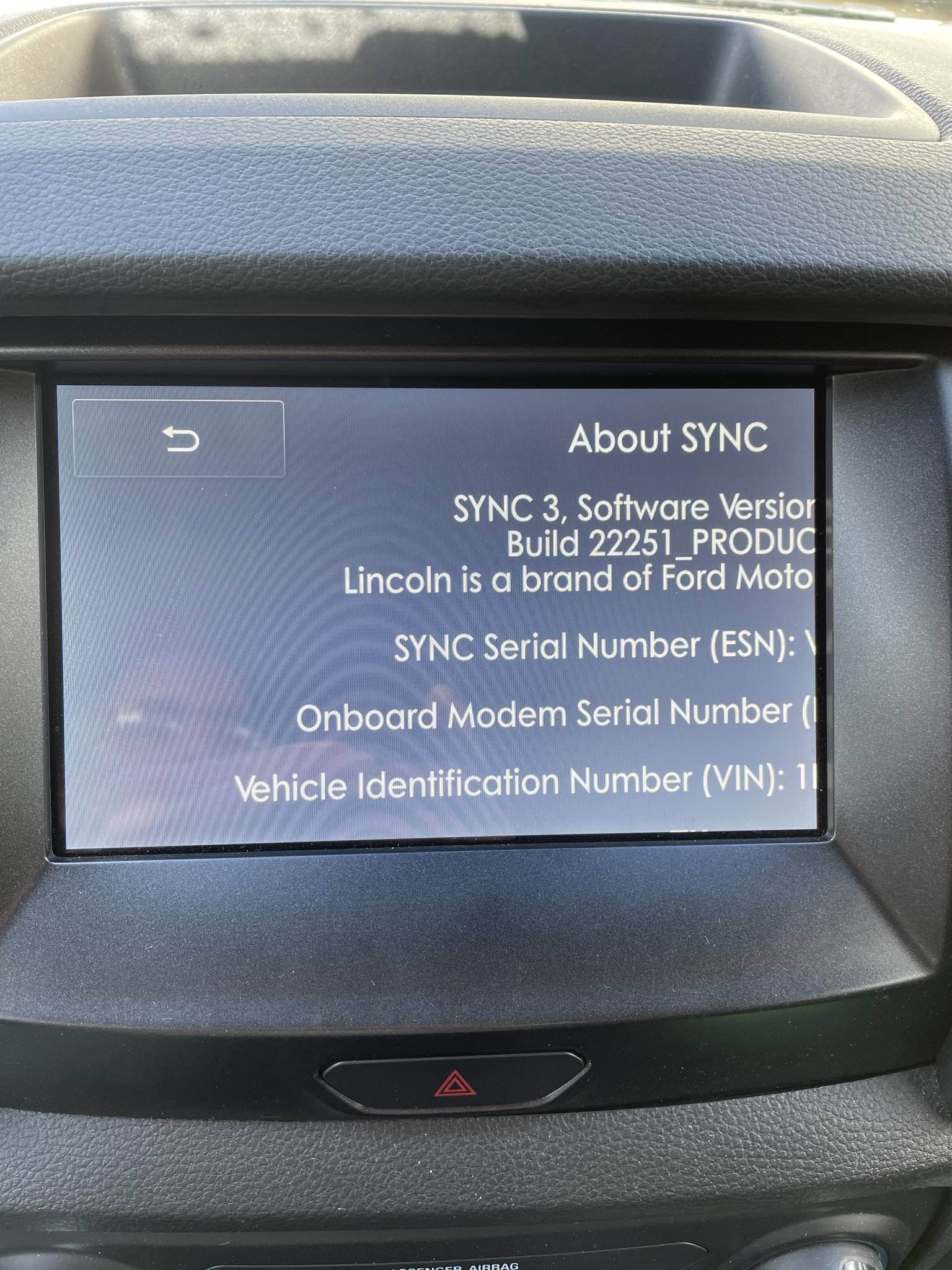

Well the dealer Fubared my SYNC, I already had updated it, they decided to update it again, now it is stuck in a oversized Lincoln Navigator mode, they ordered another APIM module, the last APIM module didn't fix the primary complaint, which was SYNC is slow, now it's flat broken, cant see HVAC, it's great.
Anybody ever see this? I may try to change the screen through Forscan to see if it would shrink back down, but I'm afraid I may make it worse, I can only control the audio with the steering wheel and volume knob, no touch screen.

Did you make any changes to Sync in Forscan prior to the dealer mucking it up?

I made other changes but nothing under APIM.

What's stupid is I had done the most recent update a few weeks before I took it in, now it wont update, when you hit "check for latest update" the swirling icon just keeps spinning, wont stop, wont update, wont say it's current, it's just lost.

Hard to believe a dealer could muck it up that bad. Well, maybe not…
Any competent dealer should be able to use their master usb to resolve that.
