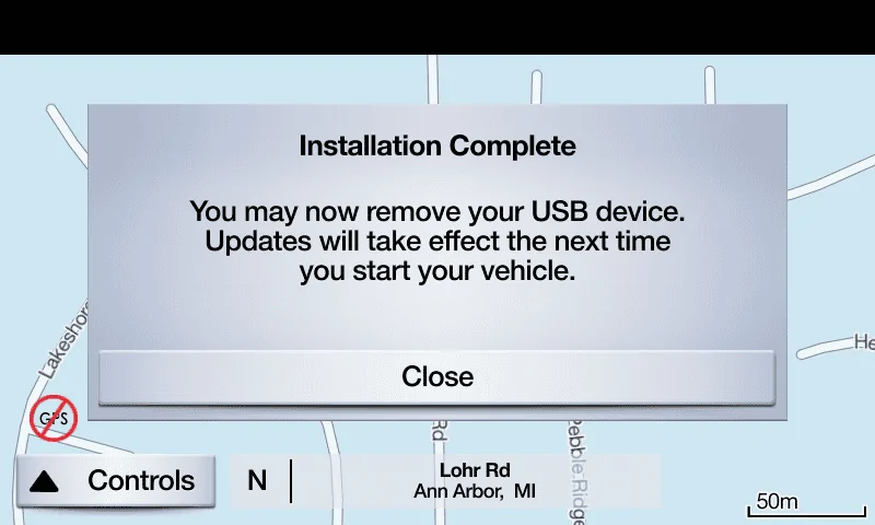

From the Install Instructions:
Step 11. Copy the License file to the USB in the folder “SyncMyRide”.
The Map Data and License File Downloads and Transfer to USB processes are complete. You may now be ready to
take the USB and install the new maps into your vehicle. The Vehicle Installation Instructions are located on the Order
Complete page. Download these instructions and take them with the USB to your vehicle for installation.
IMPORTANT NOTE: Your vehicle will need a certain level of SYNC 3 Software in order to install the maps.
This detail is located at the beginning of the Vehicle Installation Instructions. Check the software level in your
vehicle, if you need to update your software, follow the instructions outlined. Once complete, you can then
install the maps.
Below is from the install instructions.
Go to your email, click on the link at the top - Download Map Update
From that page, scroll to the bottom of the page and click on Install Instructions, these instructions are for (At The Vehicle)
I am attaching a copy of these instructions.
And here is what you will see when its actually complete.

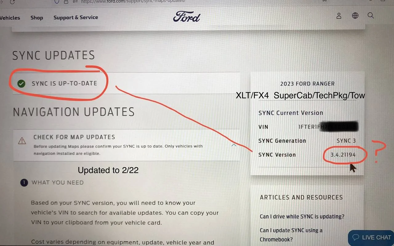

I checked for Sync updates prior to doing the map updates and it said I had no updates and was the version I needed, so I was not expecting Sync updates...regardless as soon as I get the time, I will try again. Thanks for the info, everyone!!!

Earlier is this thread, I commented that there is no option available to download the 3.34.23188 update on the Ford web site for my Tremor and I am directed to have the dealer do it. I have never uses CyanLabs , only Ford software in the past. So here is more of the story:
on 10-2-2023, I made an appointment to have the update done 10-16-23. When they looked in their system yesterday (10-2-2023), they weren't able to find any SYNC updates available......but we kept the appointment date open anyway.
This morning I called Ford Sync support. They found that there was some conflicting VIN information in their computer systems for my Ranger and that it was showing that I have SYNC 4....I don't, I have SYNC 3. (This isn't the first hiccup with this vehicle & the radio...back in May, I tried updating the maps and discovered that the ESN on the Ford web site and the ESN displayed on the radio screen were not the same. That took a visit to the dealer to correct as well.)
Anyway, the guy at Ford Sync Support said he corrected the mistake and that for this update, and for my vehicle, I still need to take it in, and that the dealer will probably have to call them to help assist with the update.
Since there are some existing issues, I am brave enough to try the Cyan Lab update.
Are any of you with 2022 Tremors running into any problems like this, or am I just the lucky one?
