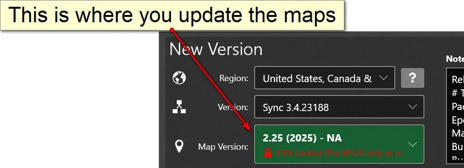

I've been poking around over there and am not finding any map updates only sync.
It looks like things have changed a bit since I used it last. It looks like there is some new "protection" for APIMs built after 2019 (ESN Locked). It sounds like you can still do it by disabling MY20 protection but that would make me a bit nervous honestly.

If you disable MY2020 protections to install new maps, it will reformat the unit, leaving you with a bricked APIM.
