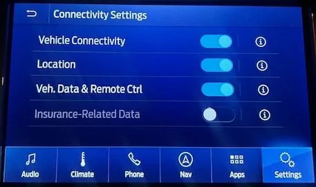

Well...haven't heard back from the delaer yet. Need a favor, can someone send me a picture of the FordPass > Connectivity Menu on thier screen? Seems our local tech insisting that these features are not availalbe in my area, but I had Ford Pass working prior the recall update......

Ford Pass Connect - Has 2 Tabs
1. Vehicle Hotspot
2. Connectivity Settings
a. Press on Connectivity Settings and this shows
