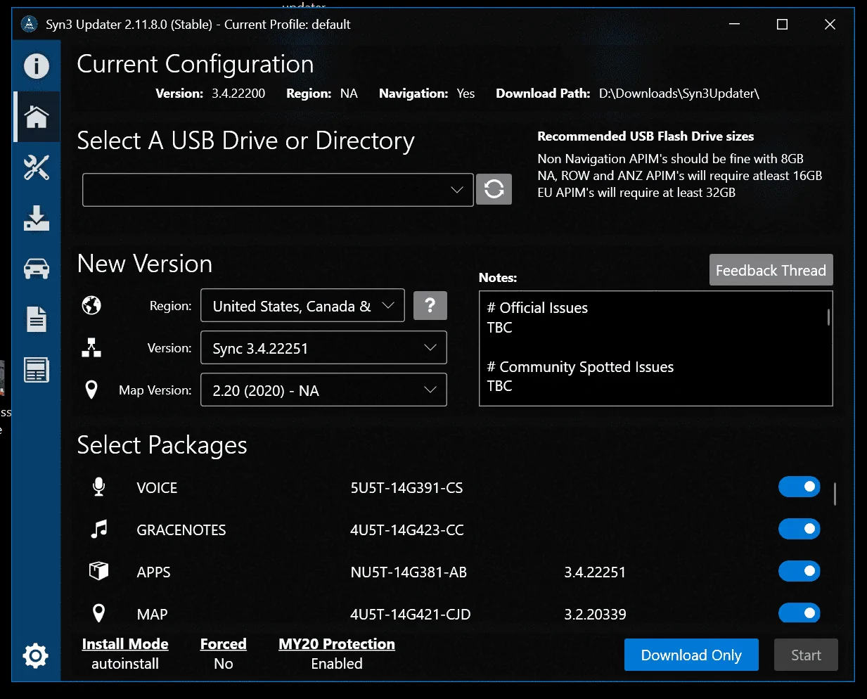

I use syn3updater. Latest Version is 3.4.2251.

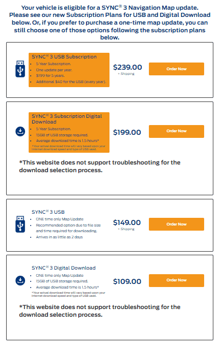

That is good for Sync system updates but if you have a 2020 or newer vehicle you can't down load the new maps.
The subscription prices noted in the previous post were for map updates.
