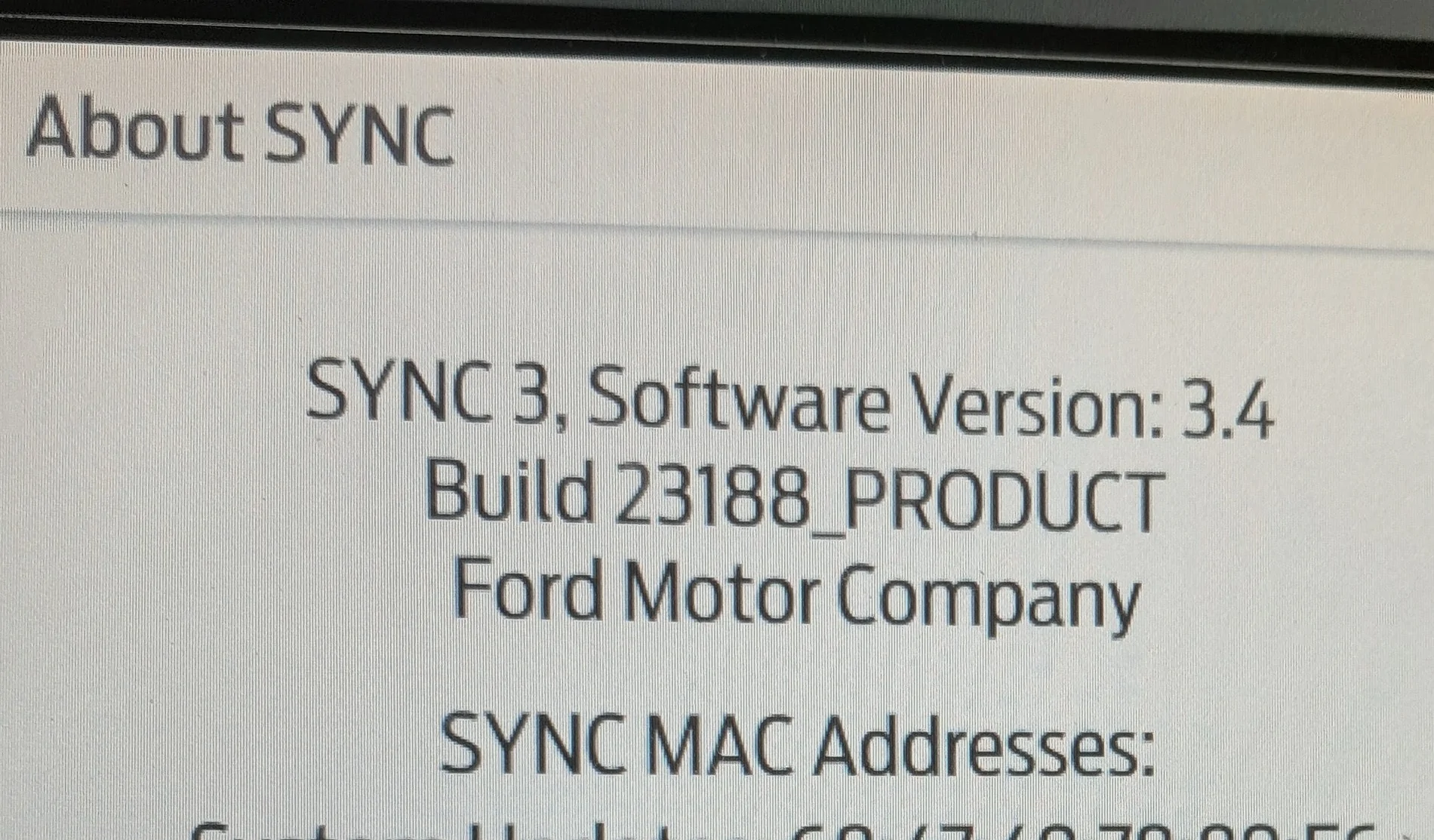

I used Cyan Labs way back when to get the 'latest' Sync versions but worried this would somehow keep official Ford updates from happening. Just happened to check today and it seems all is well.
The 'updates' screen says I'm up to date, and I'm connected to the home wifi.

There is actually an update- released in May, Ford does not show it yet - but Cyan Labs does

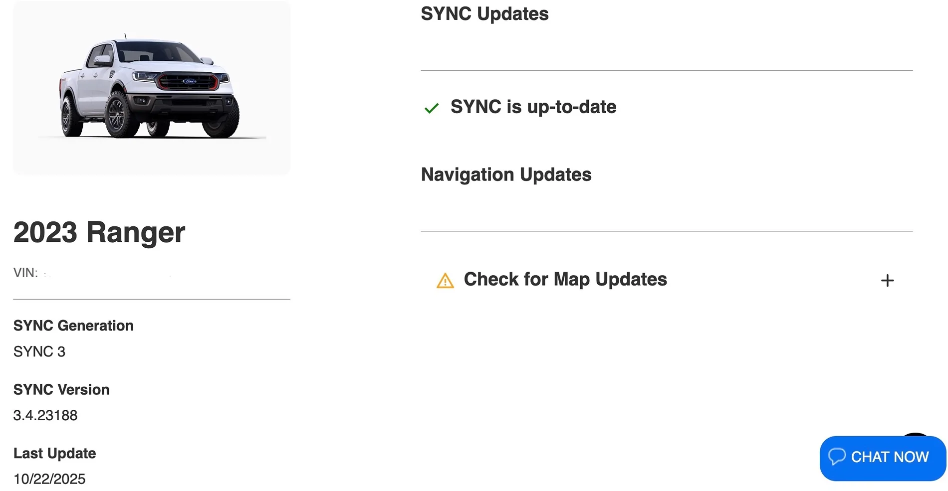

I just checked on Ford site and mine says Up To date also.

I went and checked for updates by my Vin. Sync said up to date checked the map updates 1 available but I have to purchase. The option to download for free is gone my truck is a 22 my. So guess they don't support past 3/36. And that sucks as nav was a $1k option.
