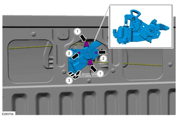

What Bsthroop did was extend the Hood Ajar (Hood Opened) circuit back to the Tailgate.
What we need to do - To get a Handle Check on the Tailgate, tied in, is to find a spot on the latch / handle mechanism to mount a (Proximity Sensor) that will detect movement.
The CAD design comment was a driving force in our new option (Dipstick) aka Fitzstick
It will serve the same function as the external (Microswitch) that Bsthrrop has installed, only moving and modifying his solution some.
This is where we will need to open up the cover and look at the mechanics inner workings of the handle and latches.
Compare Locked - Operation to Unlocked Operation of the handle.
What exactly does not move when locked and what moves?
So, when locked - place a proximity sensor on any part of the mechanism that moves (Handle Check)
The Hurdles to Overcome:
The alarm activates with a 12-Second delay.
So, a quick handle check (MAY NOT) trigger the alarm, as it would be a brief pull and release hey its locked.----Get the screwdriver.
1. Find a spot for mounting a Proximity Sensor - Handle Movement (When - Locked)
Once a spot is found, that will work, find a way to mount in possibly (3D Printed) mounting block for the sensor.
2. Check operation for the input trigger, will a momentary handle check on the Tailgate, actually trigger the alarm (Less than 12-seconds) OR does it have to see a constant (Proximity Away) for 12-Seconds then trigger the alarm. (This is the main factor for proper operation)
Sure, you can hold the handle out for 12-seconds and the alarm will trigger, but that is not going to help in resolving this issue.
3. Wiring is simple, the Hood Ajar Switch is just 2-wires, Power & Ground
The Hood Ajar Switch is a (NC) Normally Closed switch, so when the hood is opened the Ground is broken, which triggers the IPC message and if armed the Alarm.
It uses body ground, and its power source comes from the BCM.
So, for a wire run, it will only need (1) wire to tap into the Hood Ajar switch and (1) wire to a body ground anywhere along the frame.
I am sure this is how @ Bsthroop wired his setup.

So, need to open the panel to investigate what moves in this part when the tailgate is locked.
The diagrams from the manual are not much in detail on that question.
Here is a Install Video for Tailgate Storage Box:
Scroll to approx 6:30 in the video it shows the actuation of the tailgate release mechanism but note this is (unlocked) operation.
Just to give a general idea of how it operates.
USA Ranger Tailgate Storage Install Video (youtube.com)

I played with it some today, opened the hood and manually set the latch back to closed.
Locked & Armed the Alarm
Popped the Latch and Alarm Immediately triggered, reset the latch and it did not silent.
Also, tried leaving driver's window down, hood closed - Locked and Armed the Alarm
Reached in and pulled the Hood Release - Alarm Immediately Triggered, reset hood to lock and it did not silent.
Also, tried leaving driver's window down, Locked and Armed the Alarm
Reached in and opened door with interior handle, Chime sounds on IPC, getting louder and faster for 12-seconds then Alarm Triggered, closing the door did not silence.
So, this confirms that a Tailgate Handle sensor (for movement) will work in triggering the Alarm.
I also looked at the Hood Latch (Switch) verified it is a microswitch. just like Bsthroop installed on the tailgate.
It is a NO - Normally Open Switch
I also opened the tailgate and took a quick video of operation.
Sequence
1st - Is Tailgate Handle in Locked Position (Movement)
2nd - Is hitting the Unlock button on the FOB, note the actuator arm that swings out to allow full movement. This is the arm that gets moved with a screwdriver to unlock the tailgate.
3rd - Is Tailgate Handle in Unlocked Position (Movement)
So possible placement for a Prox Sensor / Mag Switch / Reed Switch will be on the arm with the white label on it or the leg off the back of the handle that is actuating it.
I am thinking the best solution is to mount a block on the back side of the panel (Cover) and mount the wired side of the switch, so it lines up with the top of the lever (labeled) and have the other half of the switch mounted on the lever.
