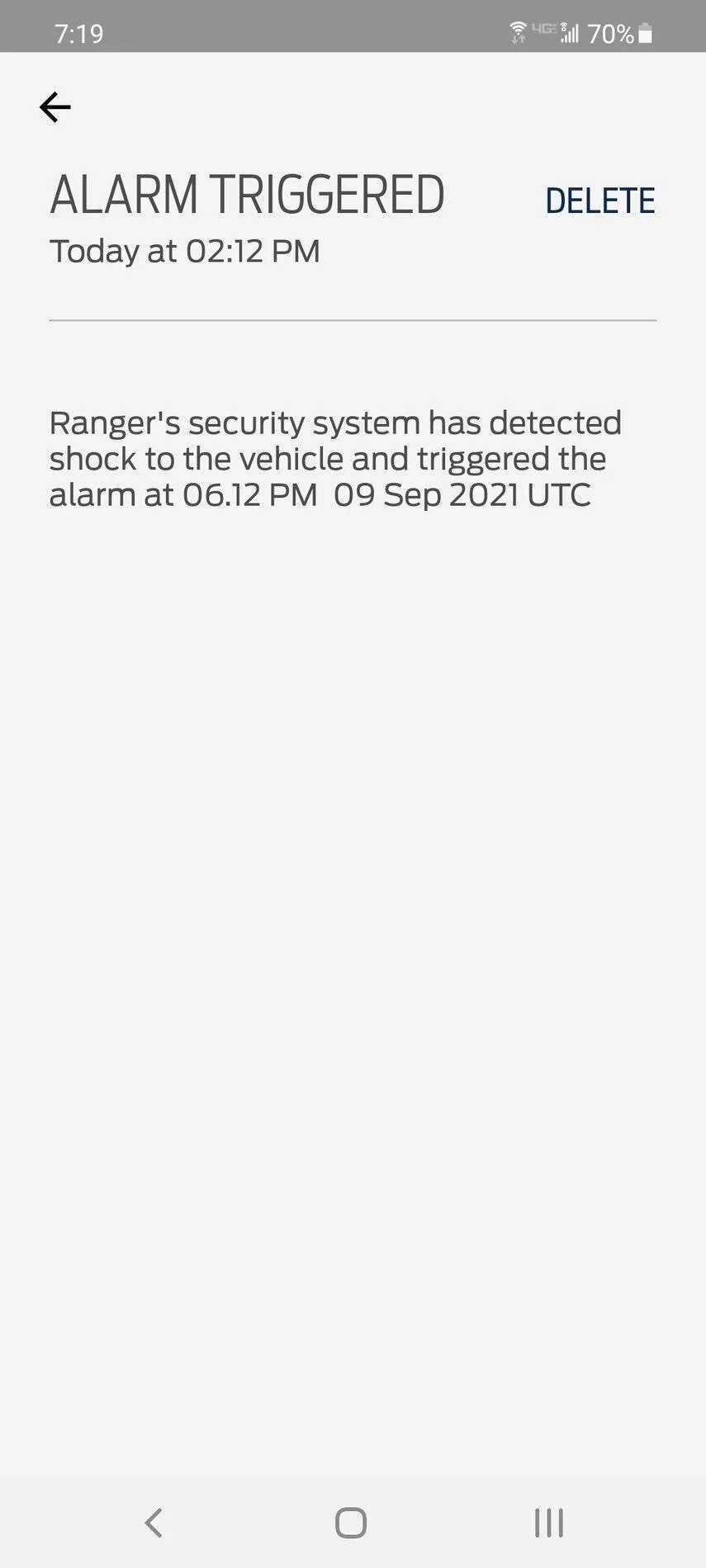

Someone in another thread was asking how do I like my Ford Perimeter Plus alarm system?
It works great. I find that if I try to open door handles the horn will beep once, which is great since we have a perp that goes through the neighborhood checking car doors. (not sure if its one attempt to enter, or 2 attempts to cause horn beep)
The alarm is setup so if If I kick the tire hard I will get 1 honk alert. Its also supposed to give me a long alert if its hit harder. I have not tested that part yet.
I did not know this when I bough tit but it also sends me an alert through Ford Pass.
Below is what the alert looks like.
you have to use the time stamp on top (2:12 PM) because the other stamp is England time (utc)
Now the bad part:
When I received this alert today my truck was sitting in the dealers parking lot waiting to be picked up for the line-x bed liner install :(.

This happens constantly when I have my truck parked anywhere, for absolutely no reason.

So today I rode my 2006 Sportster with stock exhaust past the truck as I was going into the garage and it set off the truck alarm.
so I pulled the front dash cover off and found they just stuffed it into the kick panel. All you need to do is find the thin wire that drops into the kick panel and use it to lift out the module so you can get to the adjustment screw, I don't need to remove the front dash panel.
I found the adjustment was turned all the way to High. I turned it back a little past 1/2 and did the Harley test. No more alarm when I ride past.
