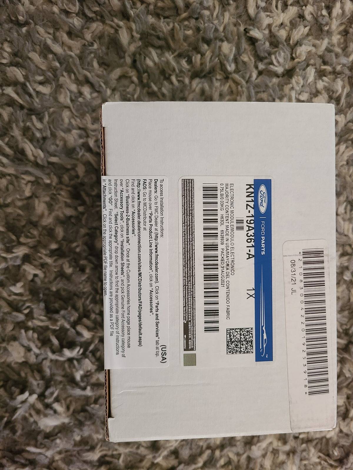

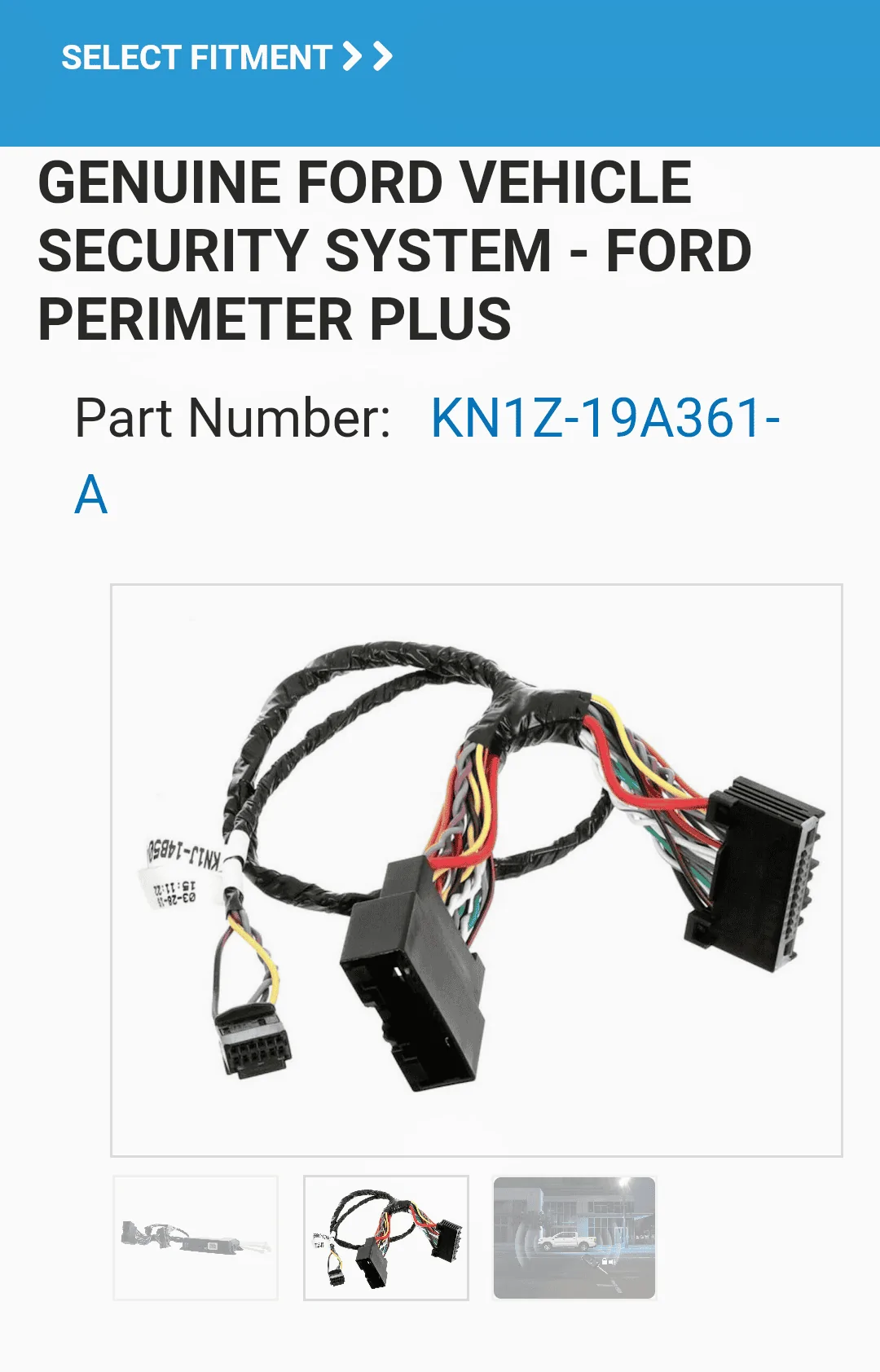

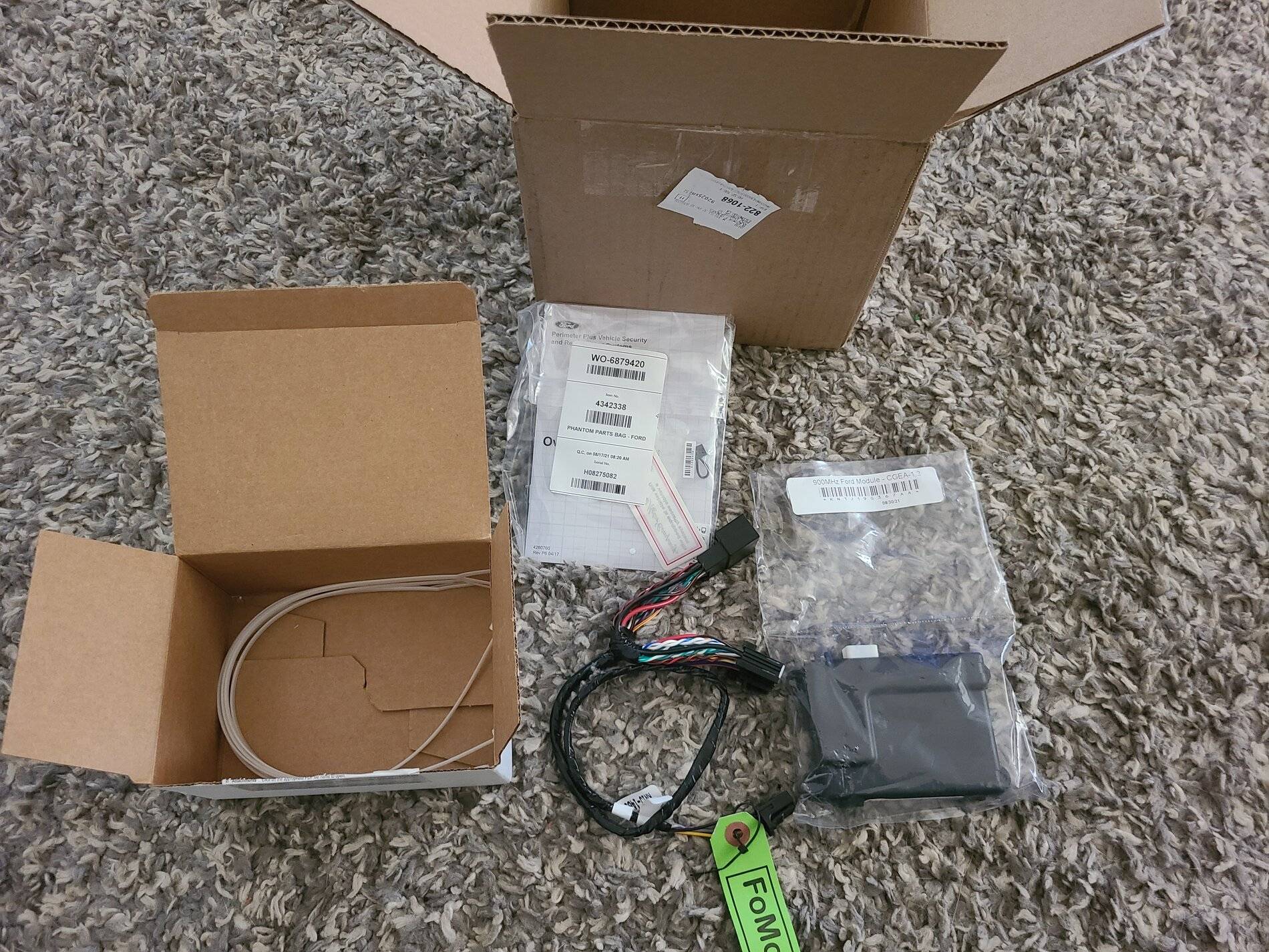

This is what I got from Levitown Ford bought it later on and I didn't need forscan to activate it. It was an easy install. There is a thread here that I think other folks had to do something on forscan.
