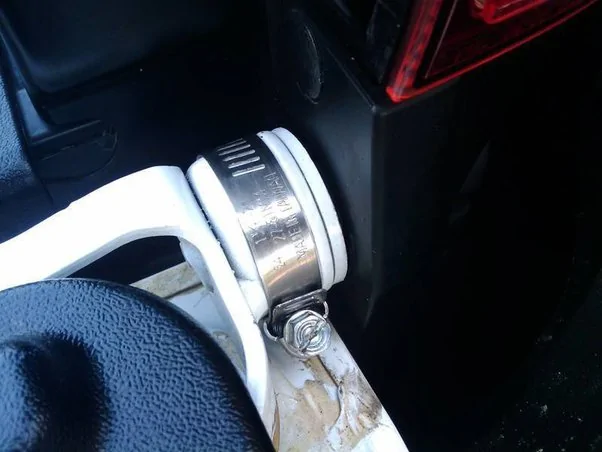

hose clamp method - you should be able to face the screw down and tighten it from under the truck, making it a pia to remove ...

I like the hose clamp idea, never even thought of it. I've inadvertently lifted 1 end or the other of the gate out of the hinge a few times. Any idea what size it is?

LOL, now that I have it locked, I can't measure it. But looking online, it looks like Tacos use an SAE #20 clamp (clamp for diameters of 3/4" to 1 3/4").
But, to be safe, maybe pop yours out (I used a sawhorse with a tarp or towel to rest my tailgate on without needing to disconnect the harness) and measure it. I'm pretty certain you should be able to reach the worm screw from under the bumper with a long screwdriver. I was able to fit a 3/8" ratchet under the tailgate but above the bumper when the gate was like half opened, so maybe a small ratcheting flathead like this could work too.
I also saw that some people smear JB Weld onto the worm screw making it a pretty difficult thing to defeat (or remove if you ever wanted to).
The JB Weld idea was also brought up by someone here saying to fill in your taillight screw heads too. So change to tamper-resistant Torx and cover with JB Weld.

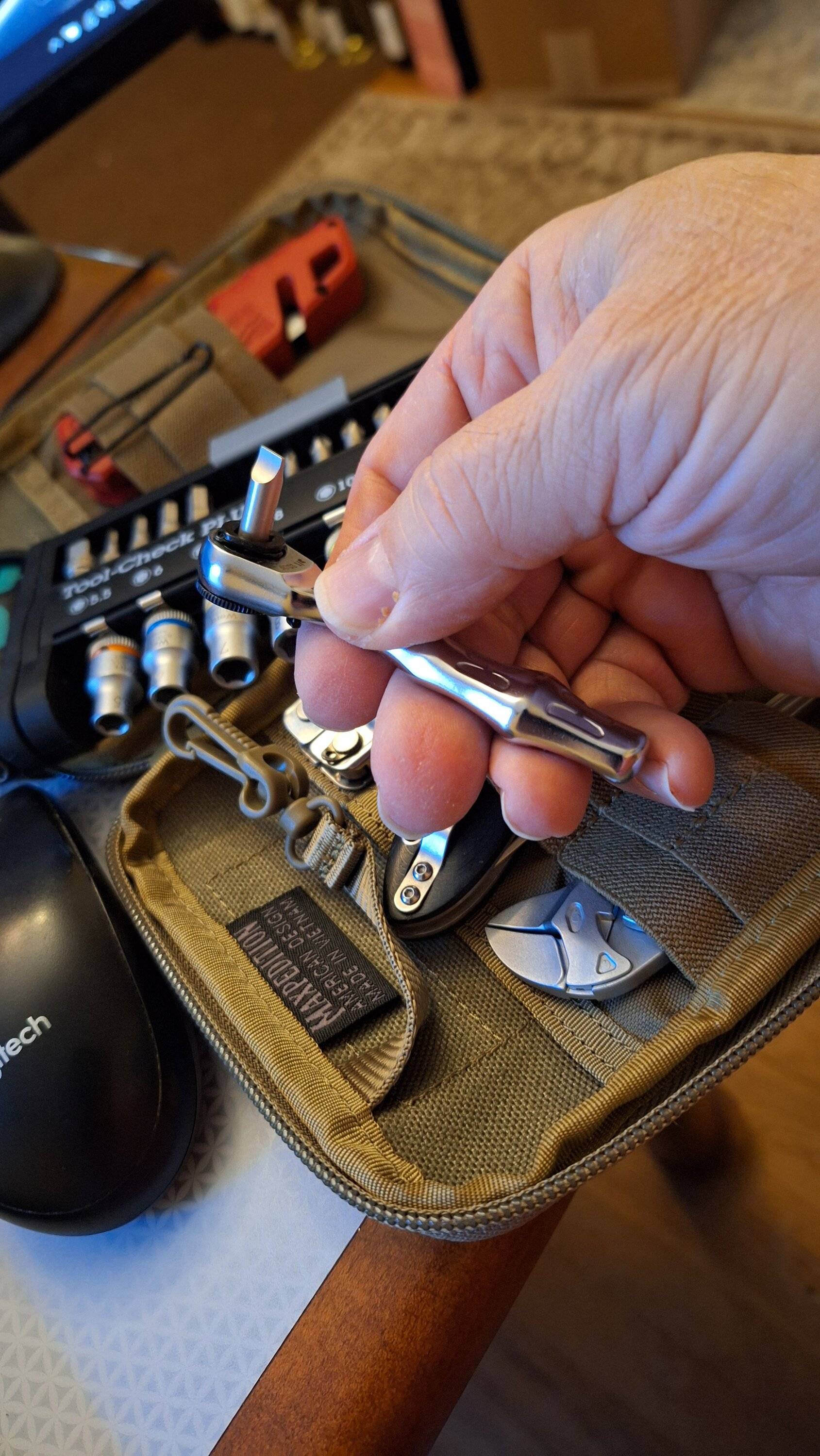

That screwdriver is a Christmas gift and it's called a Wera Tool Check. I think Lowes may carry it or something similar (Wiha?).
It's German and seems pretty nice so far, certainly small but it has a 10mm socket and some Torx ($83). If it wasn't a gift, I probably wouldn't have gotten it - it's a bit of a luxury thing for me but it'll live in the Ranger's center console. =)
