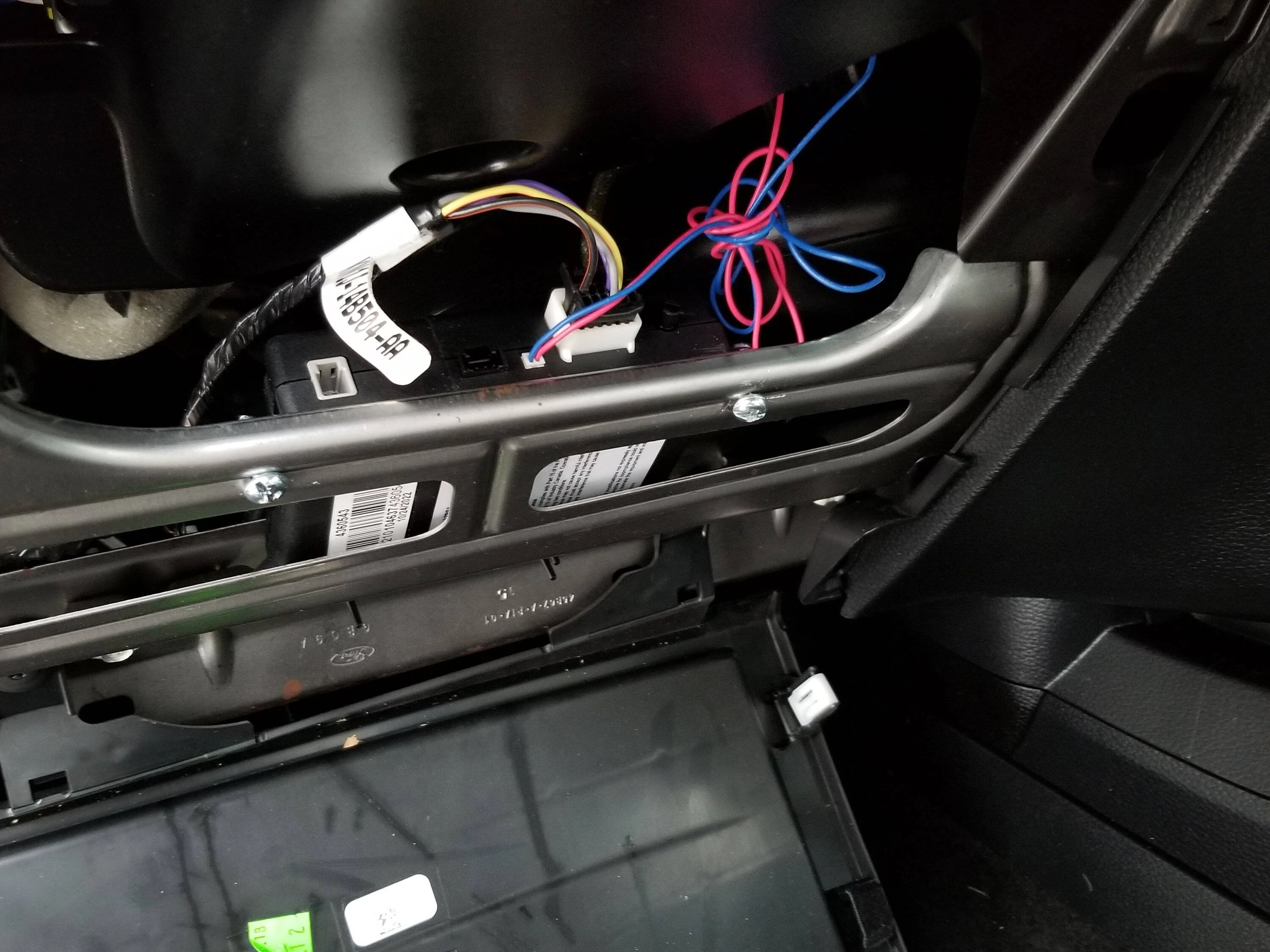

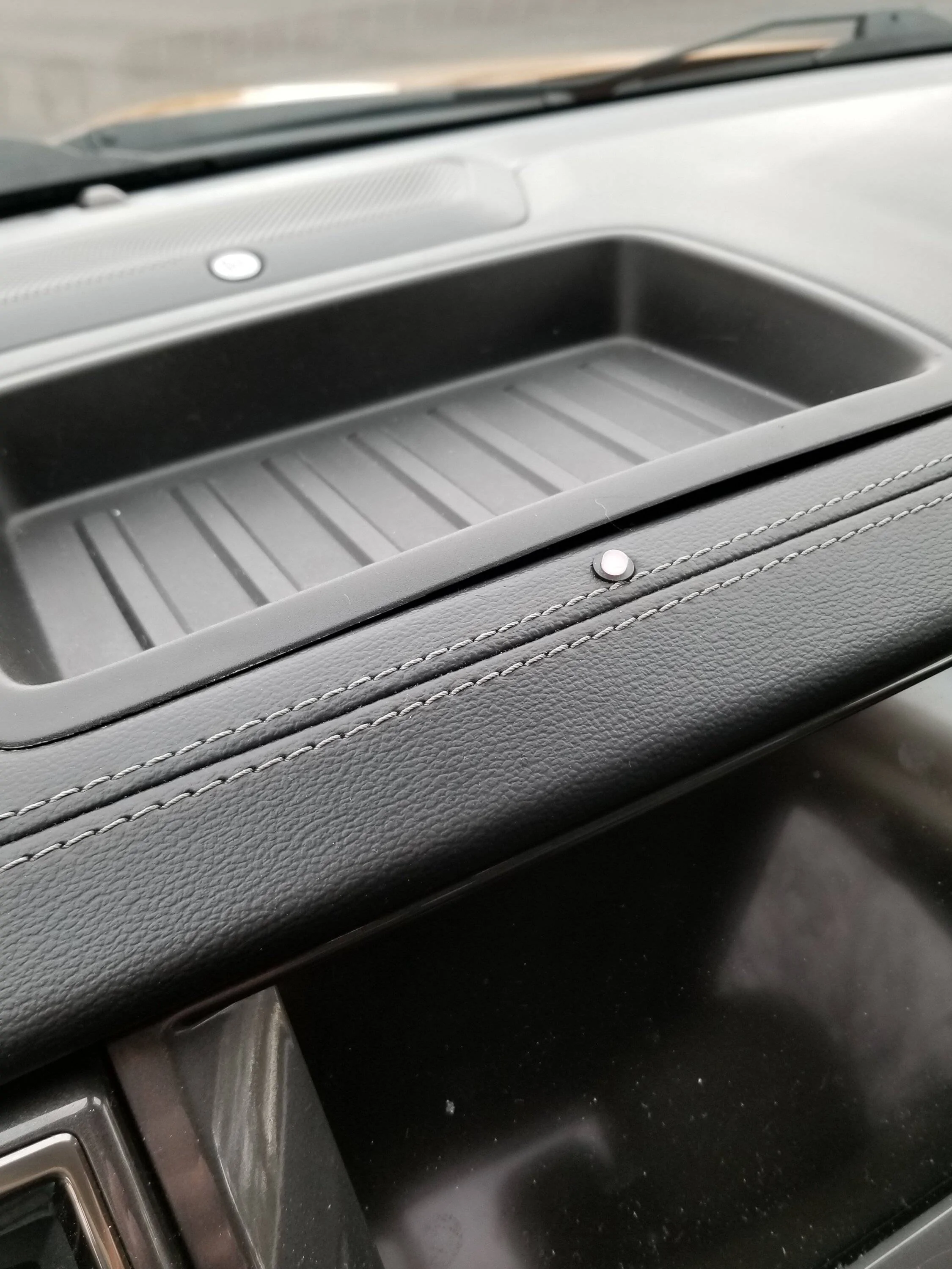

Installed mine today, put the led in the center of the dash for best visibility. Mounted the control unit under the dash panel for ease of sensitivity adjustment. Simple install, works great.
