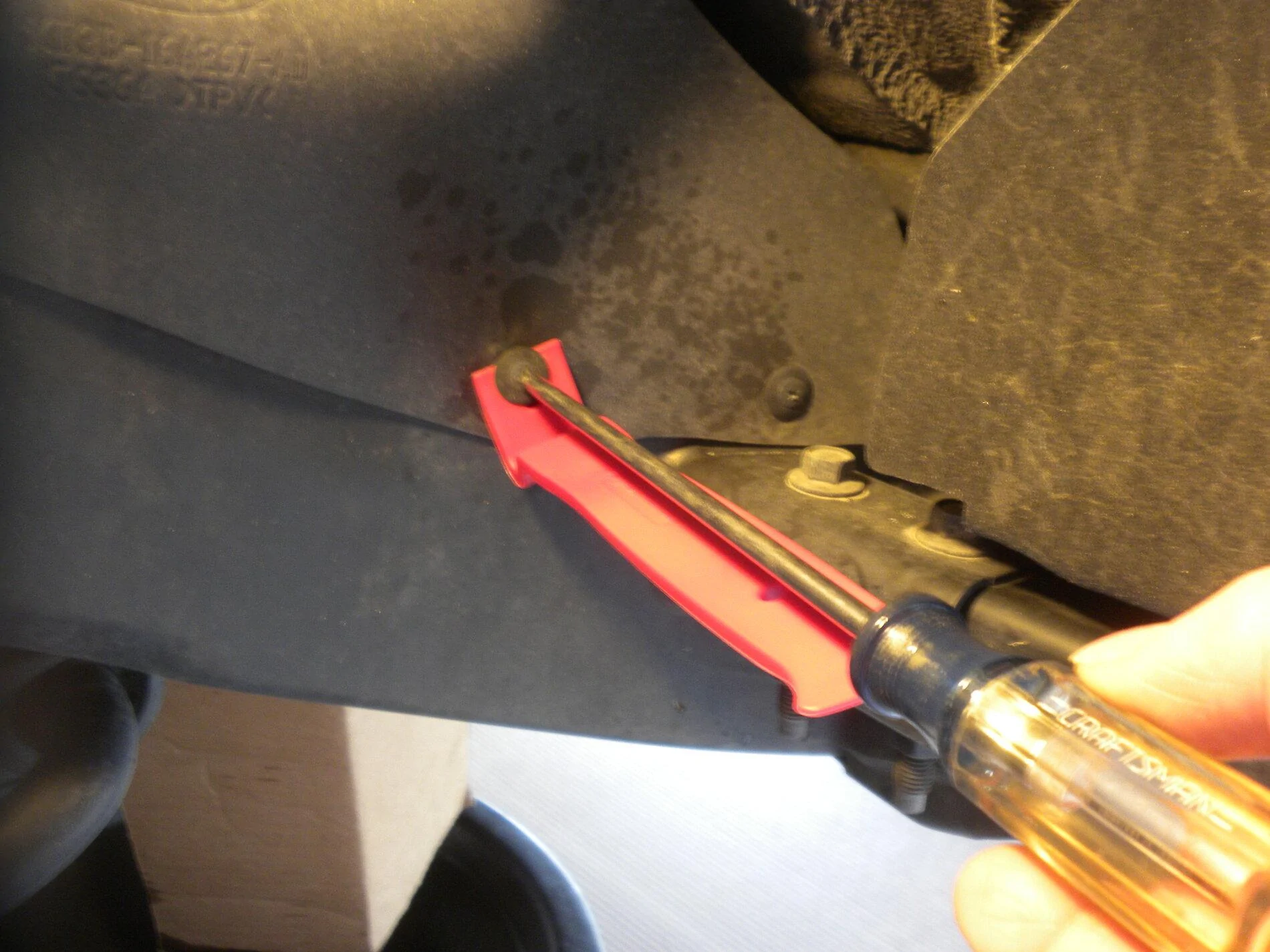

I installed a funmoto oil drain valve on with the nipple so I can attach a hose. Now I just pull the hose down from the skid plate an slide my hand in an open the valve. I want to figure out something to replace the pushpins on the oil filter cover. https://www.fumotooildrainvalve.com/f137n.html

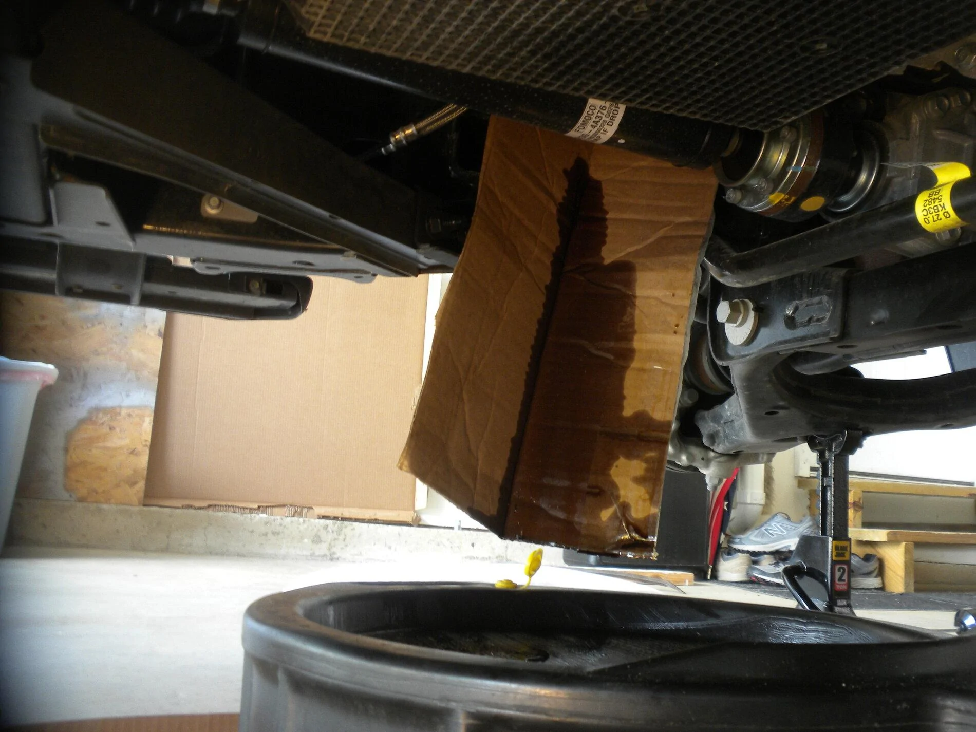

Just use my handy dandy oil diverters. Never dripped a drop, and after 5 oil changes have not yet to replace any push pins with proper removal.
Thats a great idea...
You can mass produce and market this oil diverter. Sell a million for $15.99 and be able to pay someone to do it for you.

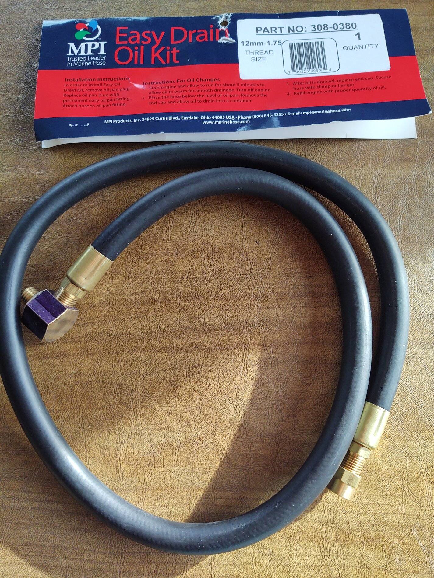

I posted elsewhere asking about the oil pan thread size. M12x1.75 was the answer.
I ordered a marine engine oil drain kit shown below and in the pic. DIY boaters push the hose through the bilge drain in the transom
MPI Easy Drain Oil Kit p/n 308-380. My Ranger is yapping at me about an oil change, and I wanted to install this at the same time. ...the hose is a bit too long at 42", so I'll have the local hyd hose shop shorten it to a reasonable length.
