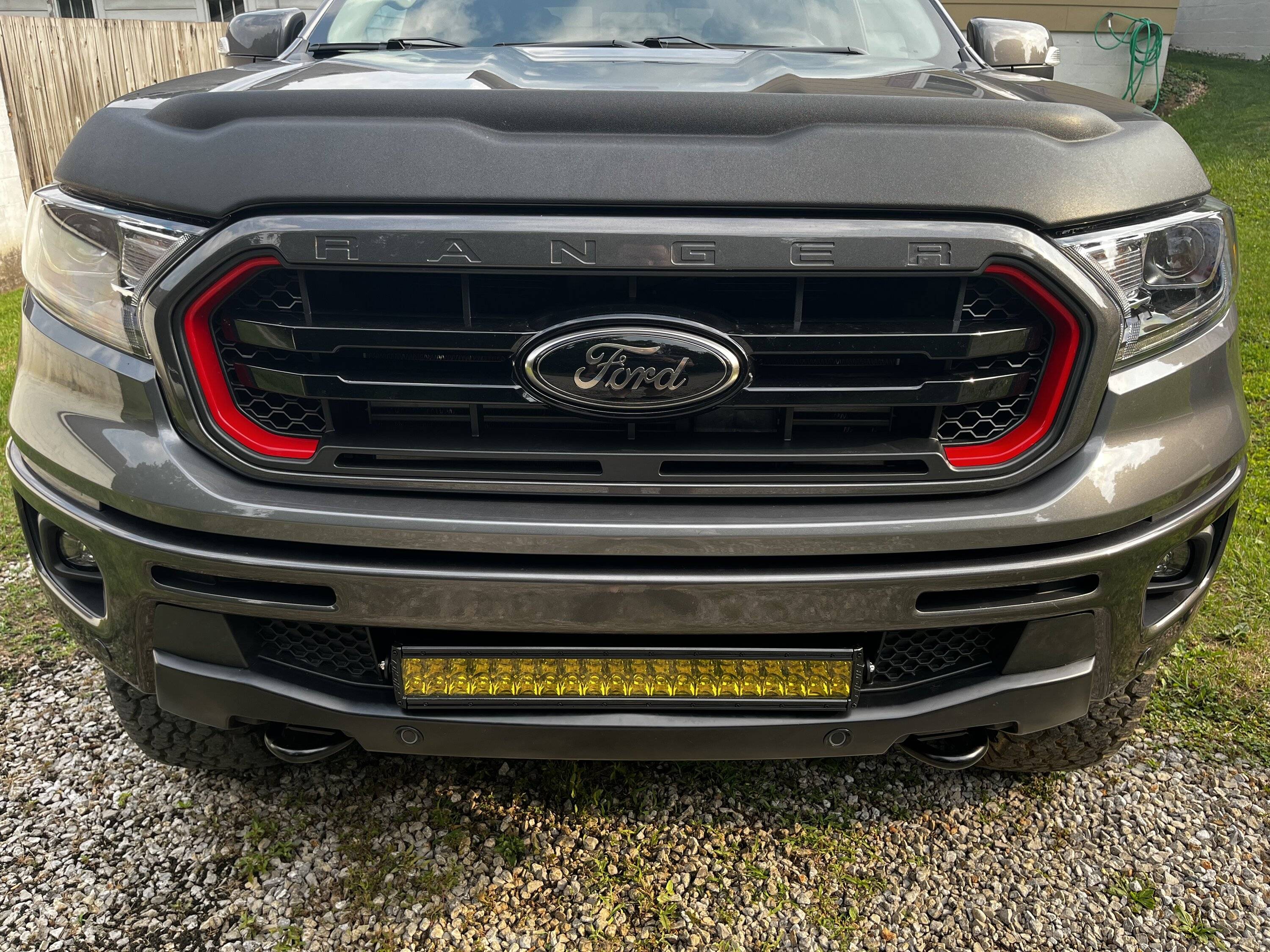

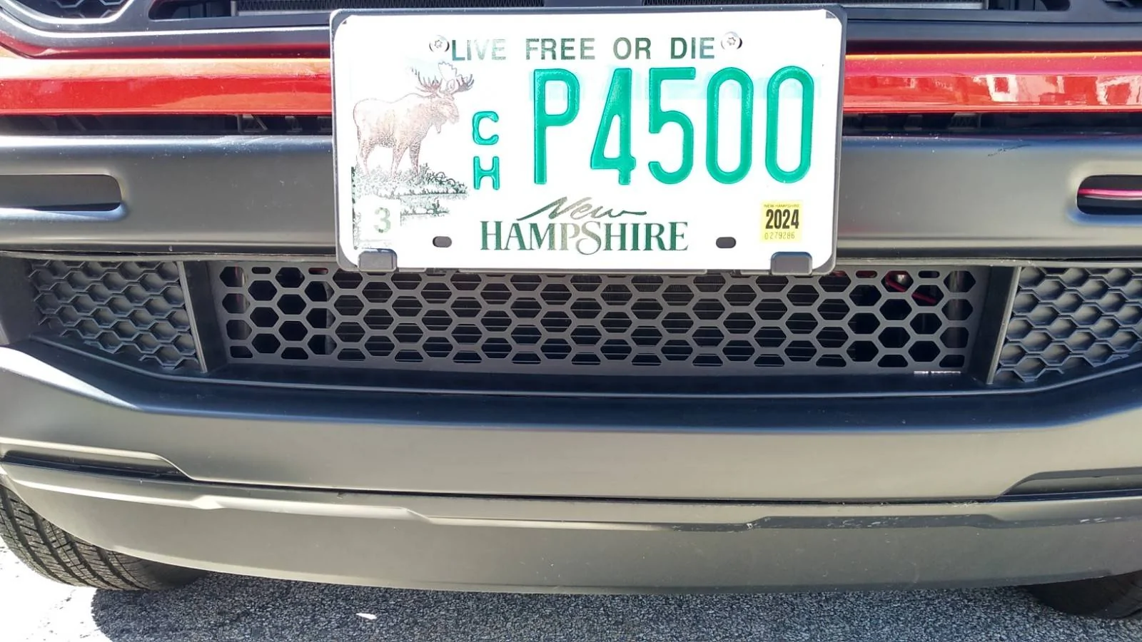

Putco makes a lower grill insert. I bought it for looks but it should block debris too. It catches a lot of bugs.
Here's that Putco grill that MountainGoat mentions.
https://www.putco.com/product/bumper-grille-inserts/v/Ford/Ranger/2022/
There's another brand too (MakeMyMountains or something similar). =D
The holes are big but it slows down the air making it more turbulent and should help reduce bent fins. They also have a model for you peeps with that fancy pants radar dealio. =p

Not exactly, on the lower part which is shown the intercooler is not shown. That is because the intercooler is not that low. Only the radiator and condenser go that low
I stand corrected. You are probably right about that. I didn't go out to the truck and look.

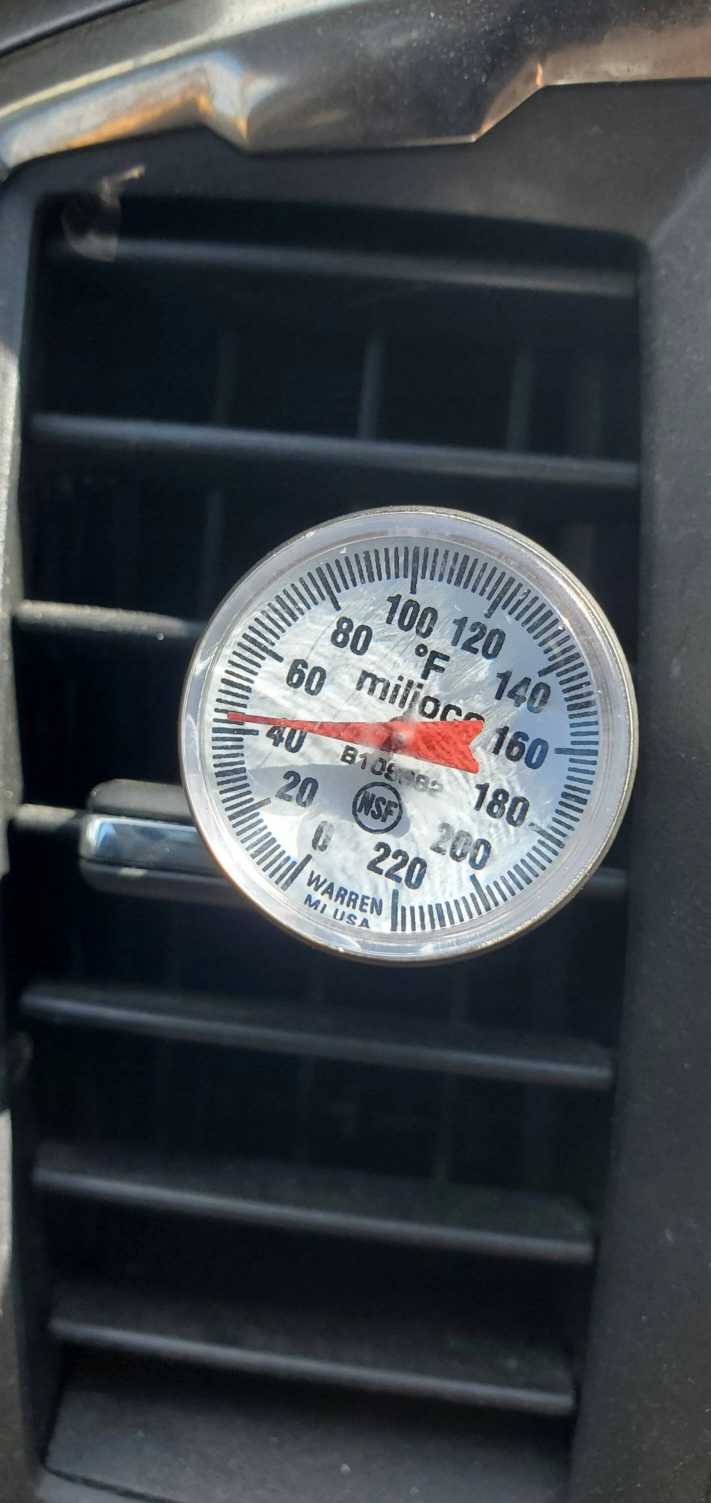

I have a 2021 the air coming from the vent is colder than my icebox...
there is only 20k on my truck?

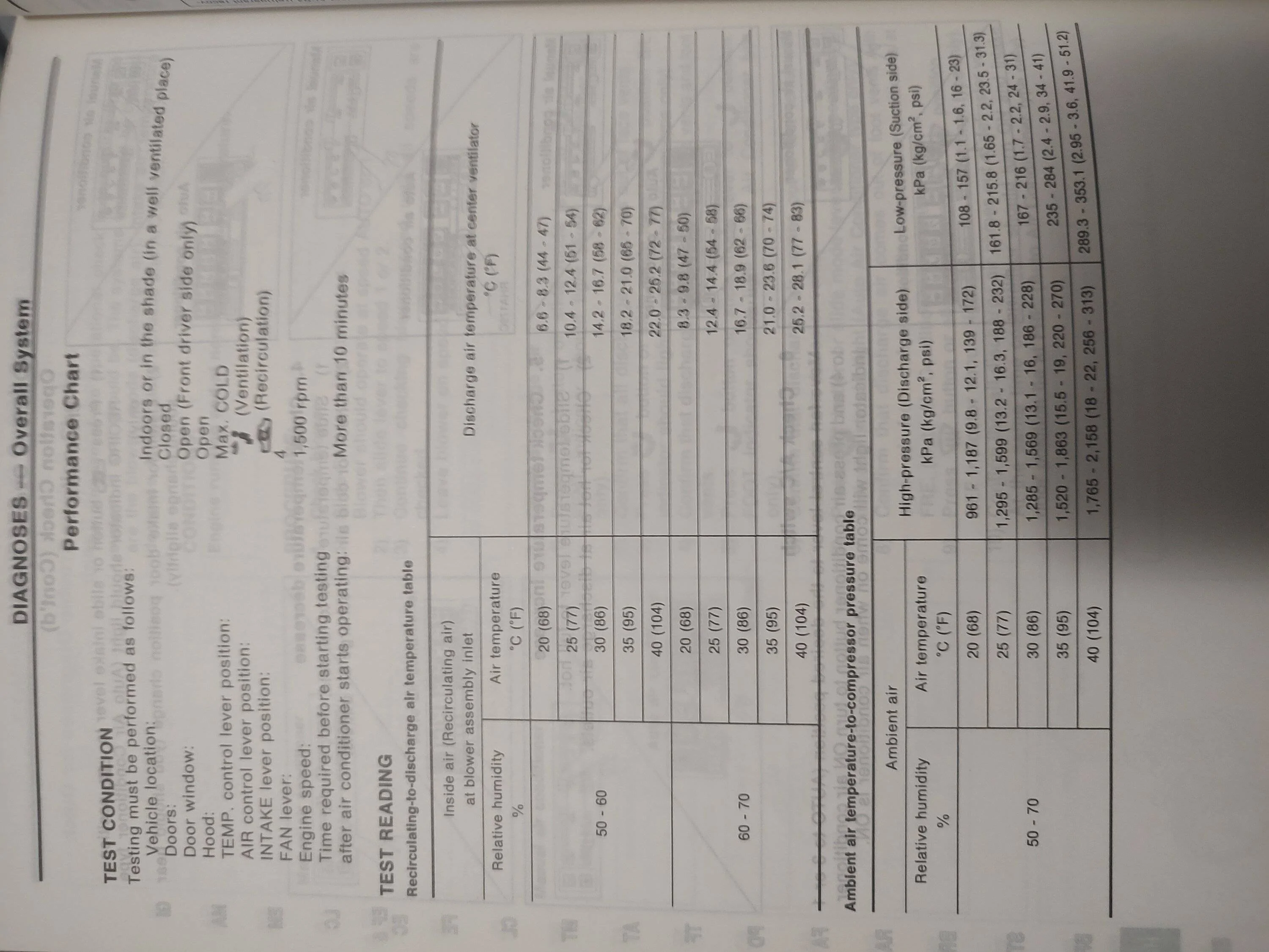

This is definitely one of the preferred methods I like to use to check the AC performance. To go with it Nissan has a simple test guide for AC performance and most vehicles pass it with flying colors!!
The test guide I speak of

I didnt know what it was supposed to be I just wanted to see, I thought it was pretty good and left it there so when I get in the truck I see hot hot it is and how long it takes to get to 40F
I am in Upstate New York and not sure how humid it is and right now its only 64F outside anyway LOL

That's the intercooler, not the AC condenser.
THe AC condenser is sandwiched between the Radiator and the intercooler.
My first thought was this as well but when I saw some intercooler upgrades, most of them showed the part being installed behind the grill which is why I am thinking the condenser is low to the ground with a nice opening for debris to come through. Will probably get an aftermarket insert to prevent more damage in the future.
I’ve got a thermometer similar to that kicking around somewhere, I’ll try to locate it and see what temps it shows for my drive to work tomorrow night.

The AC condenser is the lowest, just above the skid plate. First time I took the truck to a UTV course I hit the skid plate pretty good. Saved my AC condenser. Radiator and intercooler are above it behind the grill.
