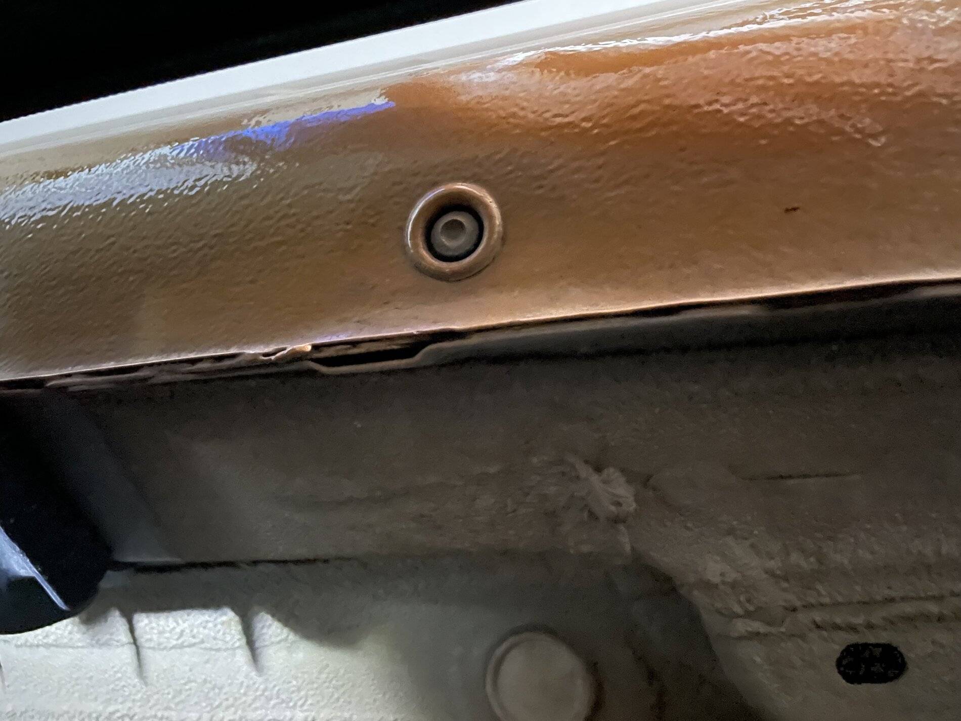

I was reading on some forums of different makes of vehicles. So it seems other makes/modesl also come with holes in the rocker panels. Some said their vehicle came with holes plugged, others (saw mention of some newer Fords F150 trucks) and Dodge Ram came with duct tape covering the holes! It was suggested to spray through the open holes with Fluid Film and put plugs in the holes. Read Fluid Film will penetrate sand, dust and even salt to get to the frame and suggested to apply annually. I think that's what I'm going to do.
I sprayed fluid film all up in the holes before plugging. As said there are still drain holes but on inner side. That Phil guy on here that is a Ford tech or whatever said the holes are for the robotics when assembling vehicle. There are many items left off the 2021’s.

How about a photo or two of what you guys are talking about....both plugged and unplugged ? Thanks

Just bend down (or kneel) and look below the doors. You will see several round holes or plugs along the lower outside panel, you can't miss them.

If you look at how the body is put together you will see drains build into where the rocker panel and floor are spot welded together. I put plugs in my holes, then realized you can see them standing near the sides of the truck so I took them out and painted them white, and reinstalled.
I do think the holes are used by the fixture that lifts the cab in the assembly line as my cab rockers are bent a little right at some of these holes where I guess the fixture lifted the cab.

Oh good idea on the paint. I have some Cactus Grey touch up paint. Since the plugs were so cheap, I ended up ordering the rubber ones and also the plastic ones. I figured the rubber ones would be easier for me to put in, but I would bet the plastic ones would take the paint better.
