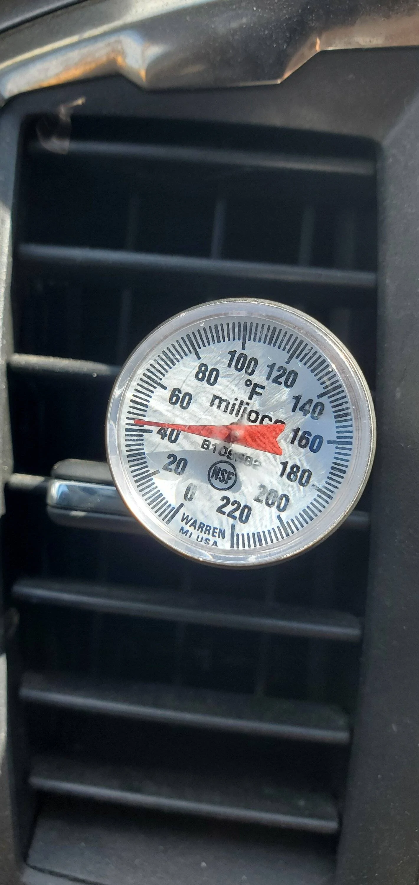

you could buy a cheap HVAC temperature thermometer and test each vent, I leave on just stuck in a vent until I need it LOL
end of Sept now going into Fall season you can test if the heat is different from vent to vent, here in N.Y it was 49F here last night LOL
