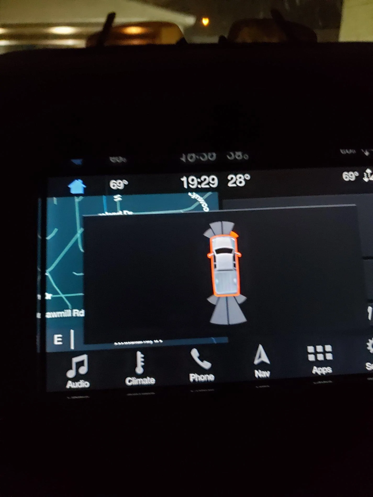

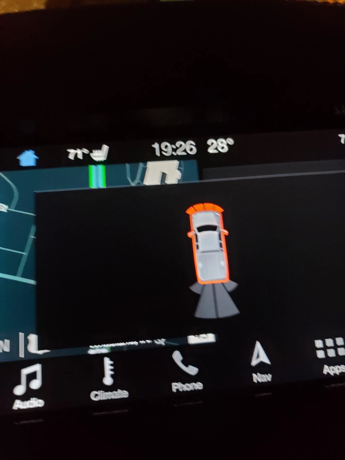

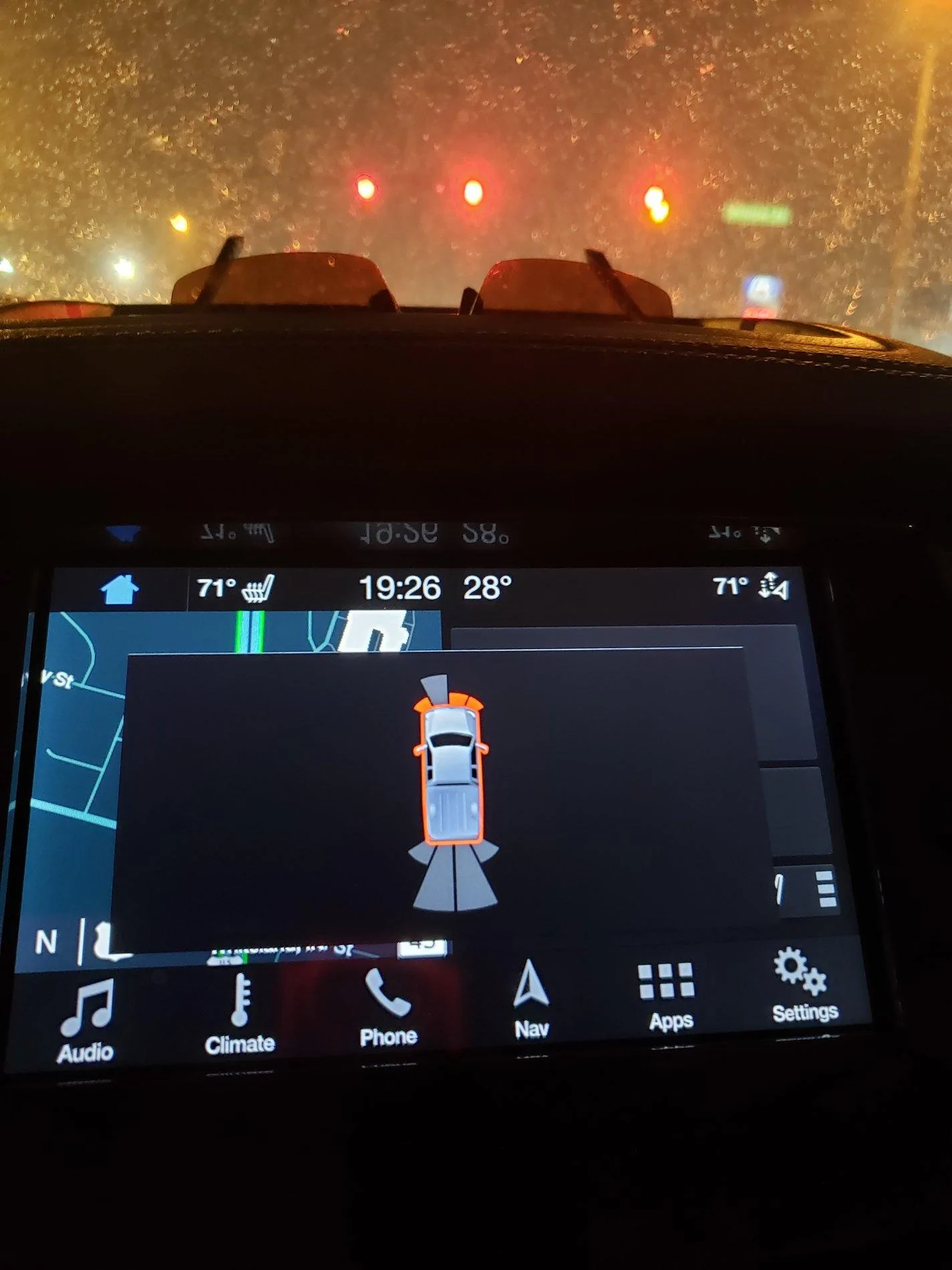

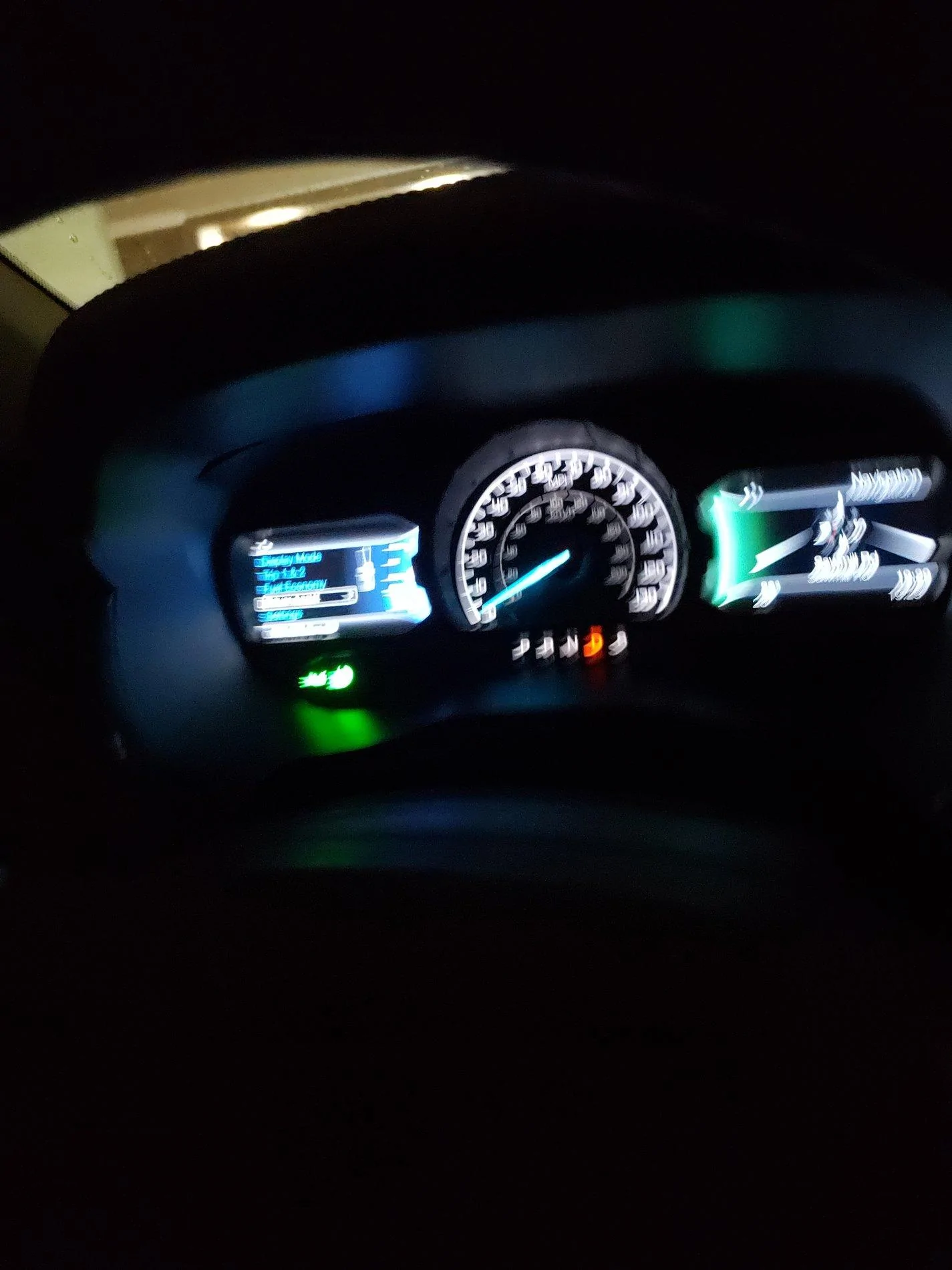

So tonight it's snowing. Not bad just a bit slick. I shifted to 4H as I left home, problem solved. As I pulled in to a store to park, no other vehicle within 2 parking spots and the right front sensor alert goes off then the whole front end of sensors go off then quit when I put it in park. (Earlier today the collision sensor alert goes off saying the camera was obscured but no snow or fog over it.) I shifted back to 2H go buy an item and when I leave the front sensors go off again. Doesn't matter if I was going straight or turning. Happens all the way home at stop lights with no one in front of me. Took pics. Did it again in the driveway. When I pulled into the garage to park up against my tennis ball the normal sensor goes off as usual as I get close to the back wall of the garage. Took pics of dash in the driveway also.
1st two pics at a stop light the last two in my driveway. Got home and got out and looked, front sensors aren't covered in snow and I've not been hit by anything.

There is a button to turn off the front bumper sensors... May have to use this in snowy conditions with ice buildup...

The other thing I can think of - are they dirty? On our C-Max they will go off if they are dirty - and sometimes they don't look dirty but will go off and we wipe them down and they work fine.

Mine will do that even if there is just a bit of ice on the sensors. At least it will only do it at slow speeds and not all the time. I didn’t try the button to shut the sensors off but I’m sure that would do it!

How funny! I had this occur this morning when we had freezing rain.
When I got him I was able to confirm it was ice buildup on the front sensors; I cleared the ice and the proximity alert disappeared.

Went through the carwash last night here in Lincoln, NE and apparently some water froze on the aforementioned parking sensors. Drove all over damn town with the same beeping and screen flashing as the OP mentioned. I thought maybe the carwash had damaged one of the sensors until I saw this post last night. Anyhoo, after a night in the warm garage all is fine again. It's a little troubling that a trip through the carwash / minor ice buildup caused this issue.
See the above post from Phil. You can quickly and easily turn the sensors off. I live in snow country and have had parking sensors on my last three vehicles. I find the convenience of the sensors far outweigh the minor annoyance of the sensors going off from snow and ice accumulations. Just this morning the sensors reminded me I had put out the garbage cans the night before. :whew:
