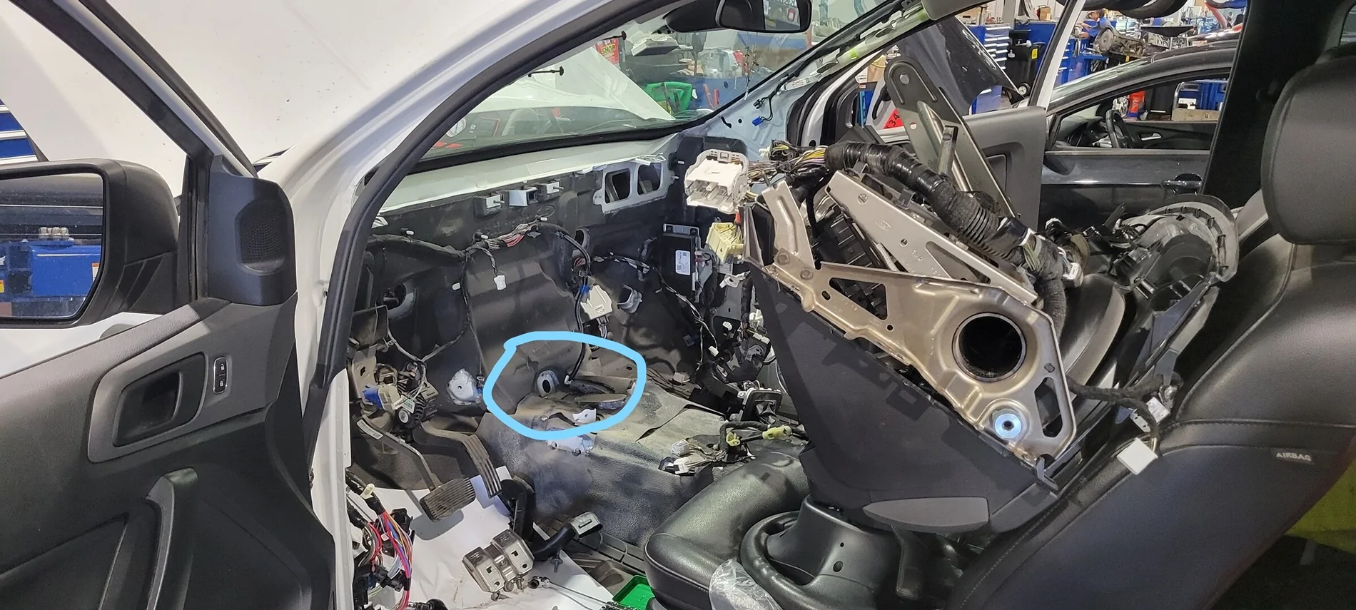

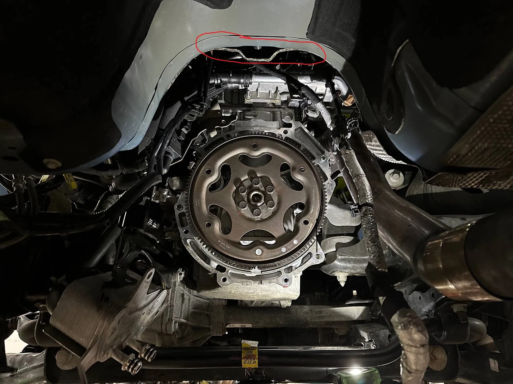

For Ref: Here is where it is located - buried

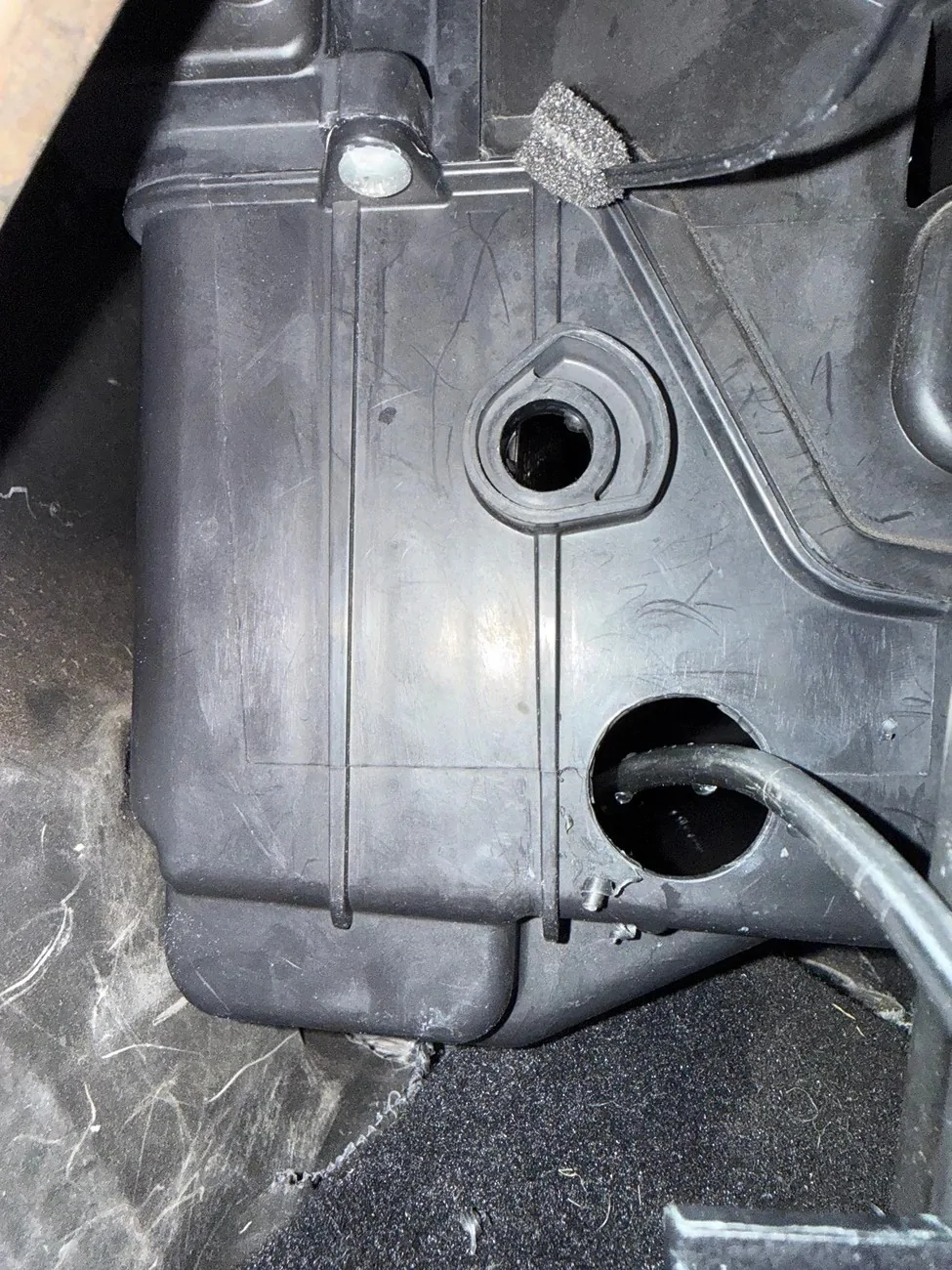

and another members solution to clear the drain hole was plugged with chair leg rubber foot,and sealed with RTV I do not recall the thread its in but there was no (Detailed) data

Just went through this a few months ago. To access the drain and poke something through it requires effort, patience, and lots of swearing. There’s two ways I found to access the drain tube when mine was clogged. It’s located directly above the transmission and behind the engine.
1) Through the engine compartment. You’ll need to cut through the firewall with a razor knife to expose the end of the drain. Even then, it’s difficult to reach and see what you’re doing. I ended up using a snake camera and was able to push a fish tape into the drain and clear it that way. Wire coat hanger would work also.
2) Through the condensate box under the dash and behind the center console. This requires drilling a hole in the side of the box, bottom right corner if you’re looking at it from the driver side of the truck. From there, I still needed a snake camera to locate the drain and get a coat hanger through it. You could try using a small hose and compressed air but that didn’t work for me. Mine was REALLY clogged. I had better luck through the engine compartment.
It’s a pain either way but doing it yourself saves you a decent chunk of change. A dealership will charge you anywhere from $1500-2000 to either drop the transmission or remove the entire dashboard to access the drain. It’s located in the worst possible spot… My honest opinion is don’t do it unless you need to.
