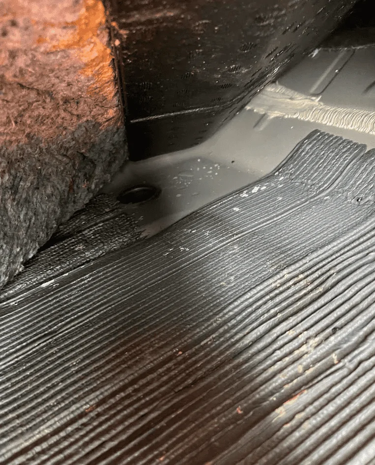

I have a blocked drain. Water drips/pours into the passenger side floor from the centerline of the truck when I turn left. Some it pours over a hot pipe and steams away. I've tried to find the drainage pipe to no avail. Has anyone taken a picture of what the pipe looks like, and if it's hidden underneath something? It seems like an easy enough fix once the pipe is located. From all the posts about this problem, it would be great to have a youtube video fully showing where things are and the fix.

When I bought the truck (used-16k miles) I bought a service contract. So I had the Ford Dealer fix it. It took them 3+ hours and removal of serveral parts to fix it. No problems since.

I think I may have this same issue...
I noticed that my truck smelled a little damp this morning, and I lifted my passenger floor mat and saw a nice white layer of mold. Upon seeing that, I lifted up the carpet on the passenger side and it was very damp. I park underneath a roof all the time so I am doubtful it is a leak unless someone is pouring water into my truck in the middle of the night without me knowing... Driver side is dry, and so is the carpet under the rear seats.
I haven't been able to locate the a/c drain - has anyone been able to snap a picture of what this looks like?
Is it possible that this is just condensation from the hot temperature of the flood board with the a/c vent underneath the passenger seat? I noticed that it was most wet around that area.
I've got a dehumidifier running in the truck right now and I am drying everything so that I can further troubleshoot and crank up the A/C to see if I can find the source (so far this seems to be the most likely culprit).
(the drops you see are located at the top left area of the carpet area on the passenger side - closest to the transmission - no clue where they are coming from thus far)
