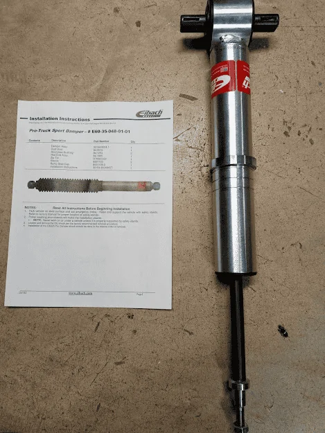

Well somebody at Eibach screwed the pooch. This is what I received today. But I called and got great customer service and they are sending out the right ones ASAP. I was so hoping to get the new ones on tonight.
