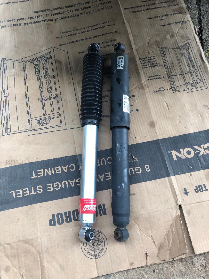

I just changed my rear shocks to Eibach's an did a test run an to me it's night an day better. Rear feels solid, firm an controlled. No more busy bouncy feel. For $200 this is the best mod I've done.
Langwilliams
Langley
Dec 31, 2019
2,955
6,725
Lorain, Ohio
the Eibach shocks feel heavier an more solid than the stock ones
