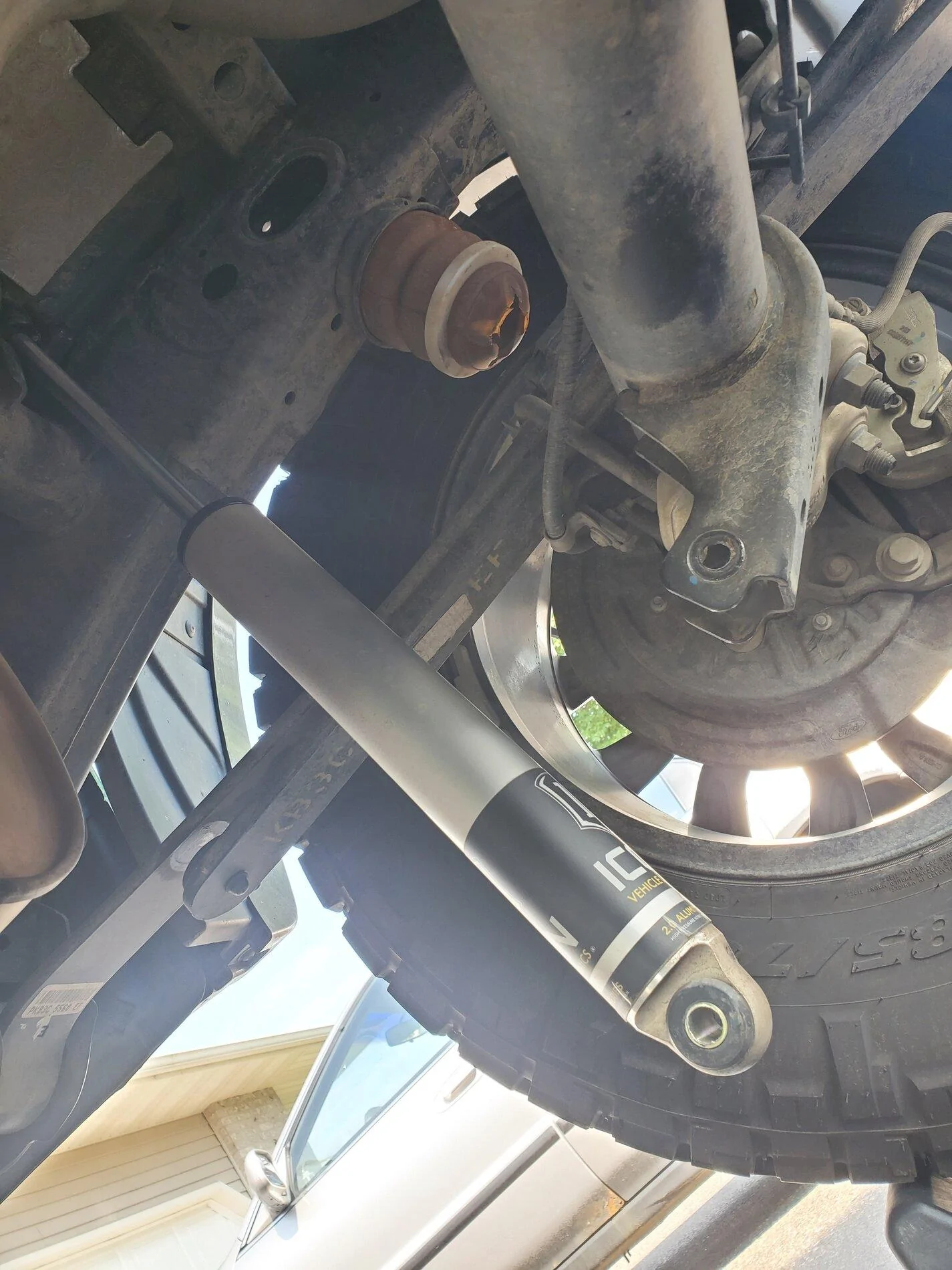

Installed Fox 2.0‘s on the rear today. I would describe it as firm but compliant. Way more composed. Stays put on stops now. Feels like the back of the truck is connected to the front now. It feels way safer to me.
Had two guys in new F150 on my bumper on the turn to the entrance ramp during my test drive. Between the shocks on the turn and the tune on the ramp - bye bye F150.
