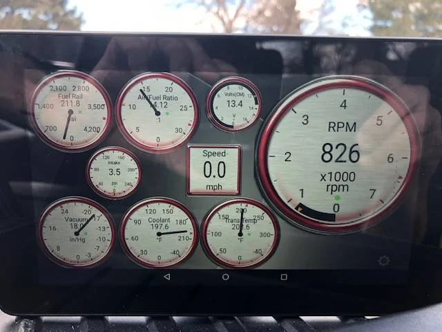

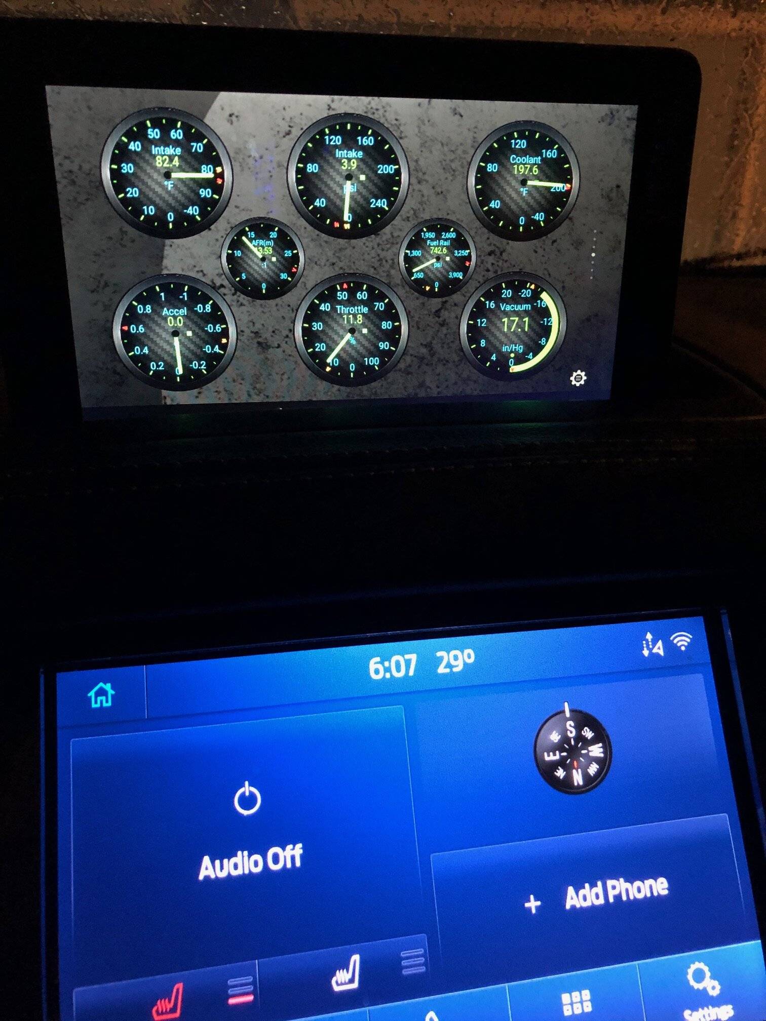

You can easily add a wireless boost gauge to your Ranger a number of ways. With my setup, all you need is an old android tablet or phone (I use a Fire 7 tablet), a wireless OBDII dongle ($20 on Amazon, this plugs into your OBDII port to access engine sensor data wirelessly, and the torque pro app ($4.95 on the google store). You can pick up on many sensors in our 2.3 Engines with a wireless gauge setup like this. If you do some searching in here you will find other methods/ways to get the info to your cab. I believe there is a way to project this information to your sync display....
BTW...when observing these pictures of my gauge display, these are old pics when I first was experimenting. I only run a gauge for Boost/Vacuum, Coolant Temp, Trans Temp and RPM. Those are really the only sensors we have that give you any meaningful info...IMO.
Also, if you don't already know this....if your turbo is not in Boost mode from acceleration, then its pulling a vacuum so your gauge will go back and forth between Boost and Vacuum.....
That should sufficiently open a can of worms for those that are looking for more information while operating their Rangers..... ;)

I have been using TorquePro for over 8 years and have used OBD2AA to project the TorquePro data into the Sync3 screen.
I have also been driving turbo vehicles continuously since 1985 and the Ranger is the first one without a boost gauge.
To rectify this situation I have purchased a 3 gauge pod that I am mounting into the tray on top of the dash. The pod will contain a vacuum/boost gauge, oil pressure and volt gauge. Got all the parts but haven't found the time to get it done.
