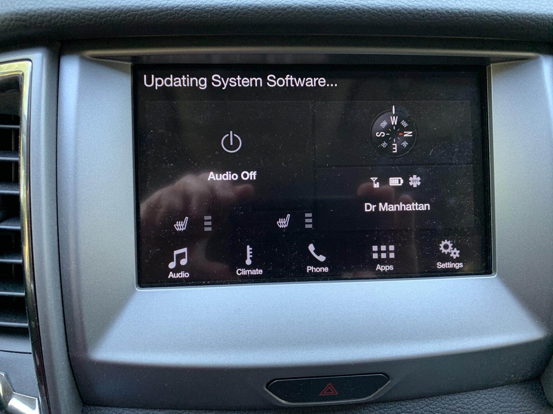

Just updated to Sync 3.4 on my Ranger 2019

Updating mine now. Also an XLT SCrew 4x4. I’ll let you know how it turns out.

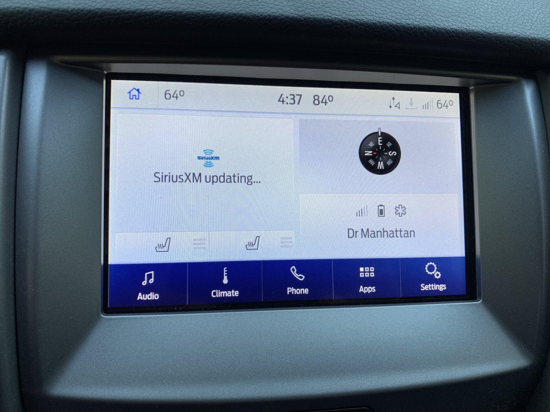

Yup. Just confirmed. Climate controls are now missing after the update, and they were there prior. This is even after a master reset.
Any thoughts @UofMEngineer ?
Edit: it even shows the temp setting, but all controls are gone.
What all is the forscan fix for this again? Anyone have before and after configuration values? Only thing I can think of is there was some change made to handling of the config values for climate domain in 3.4 to cause it. I've never seen it happen myself to look into. You can report a bug using the bug reporter utility in 3.4 (in Settings under the Analytics & Diagnostics).

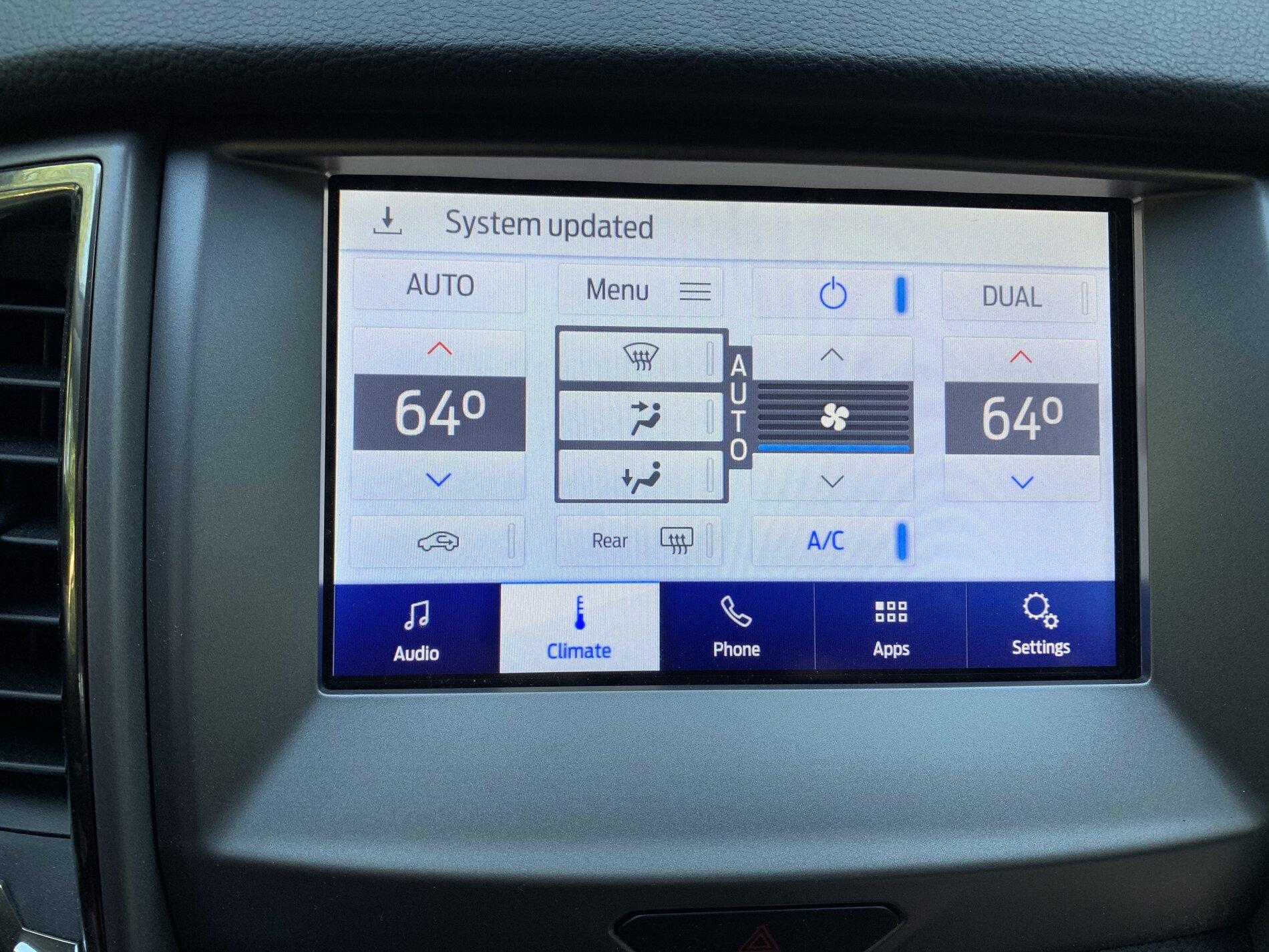

Just got done in my XLT SCrew 4x4. I’ve got climate.
Maybe it is something else? Do you have heated seats and if so do they show in the main screen? (I do and the controls for them show up)

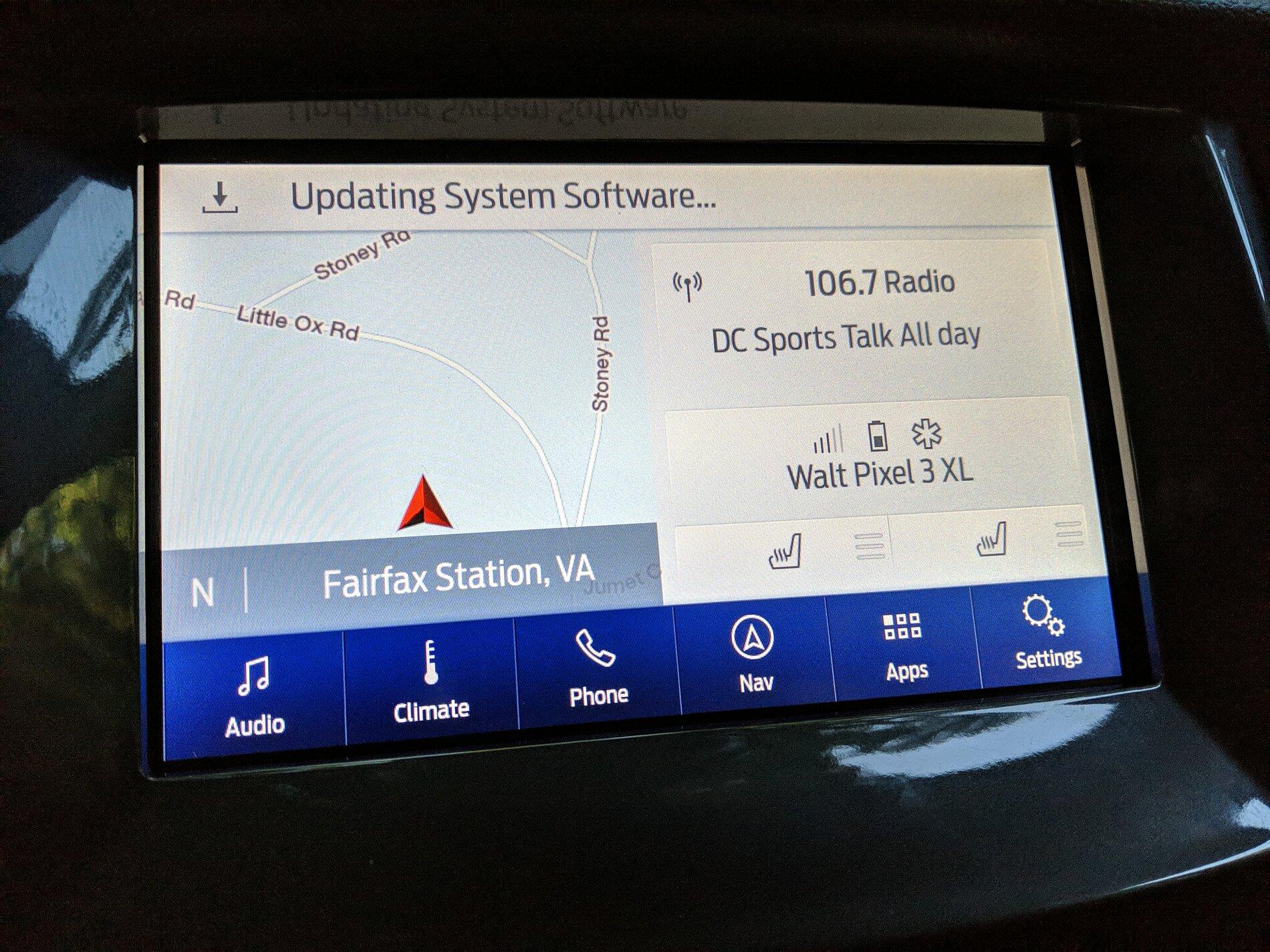

That is the scene while updating maps.

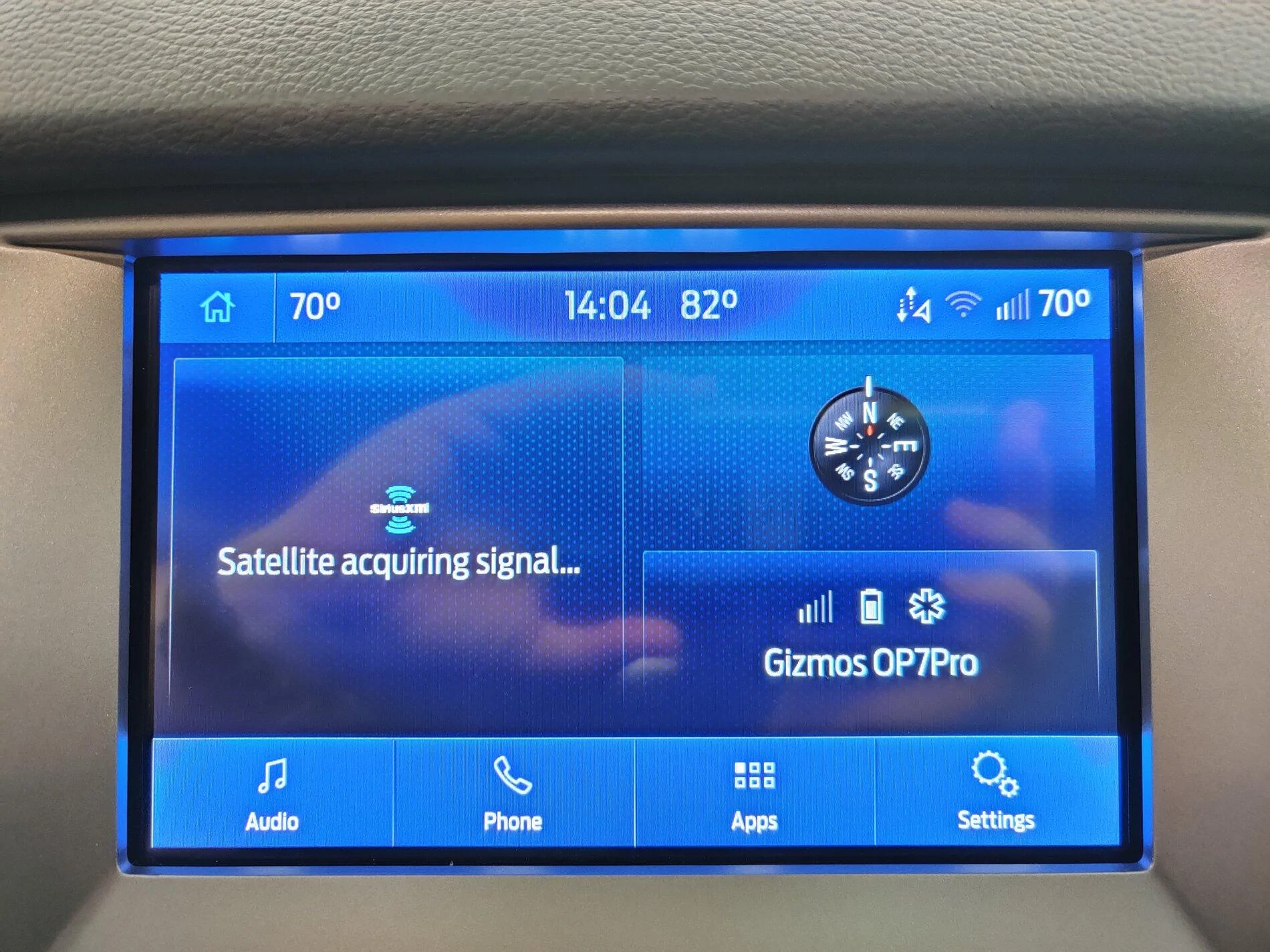

19 XLT with non heated seats lost my climate controls too, going to 3.4 it rebooted alot of times and the funny thing was after the 2nd reboot the climate icon was there but disappeared. Update was not ready for prime time

I do not have heated seats either. I wonder if it's the higher-level trim and/or specific climate options that are triggering this.
I did sent in an "other" report for climate in the diags as I was going through things checking for any setting I may have missed.
I can try the update again and see if it does anything any different, but I wouldn't suspect it would?
I have noticed that since the update, sync takes *noticeably* longer to start up now when it first boots.
I don't recall ever seeing climate on mine, but I only saw one reboot.
