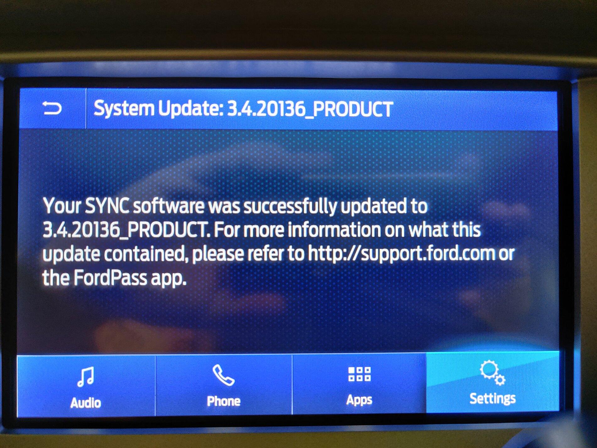

Just updated to Sync 3.4 on my Ranger 2019

So the upgrade went off without a hitch. I had an issue with Android Auto. It would connect, recognize the phone, then immediately disconnect. Bluetooth was fine. I did a matter reset (probably didn't need to), but ultimately had to remove my truck from Android auto on my phone and allow new connections in the Android Auto app on my phone and added it back without issue. All is well again and it definitely feels smoother.
I notice you're missing climate controls as well...
