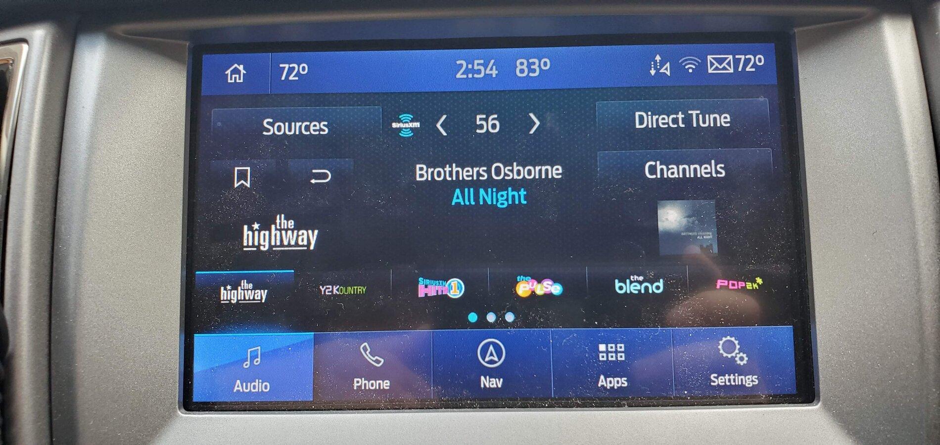

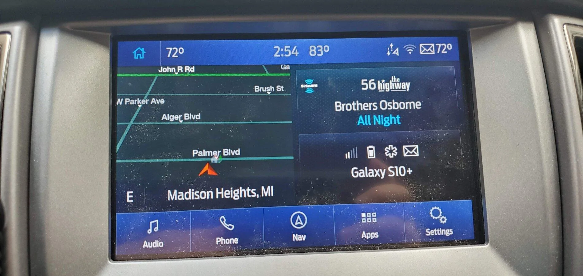

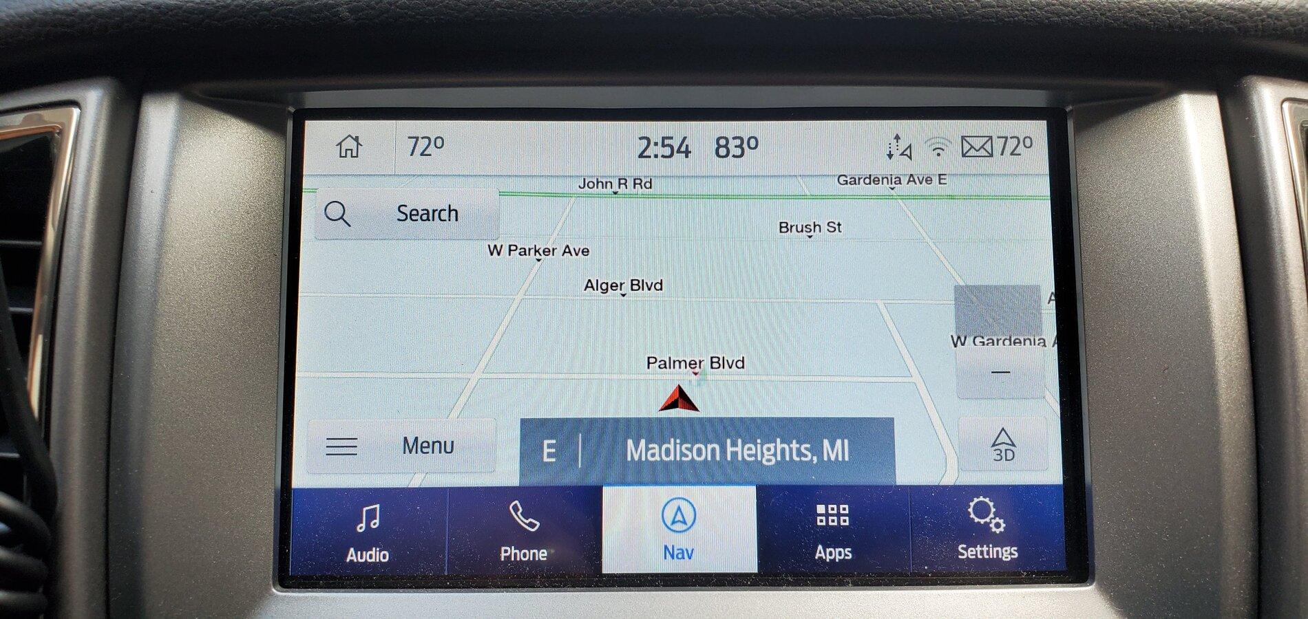

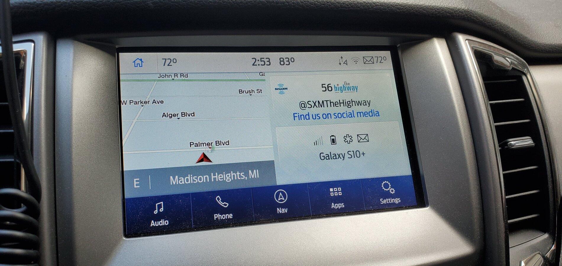

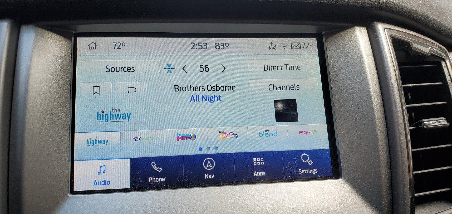

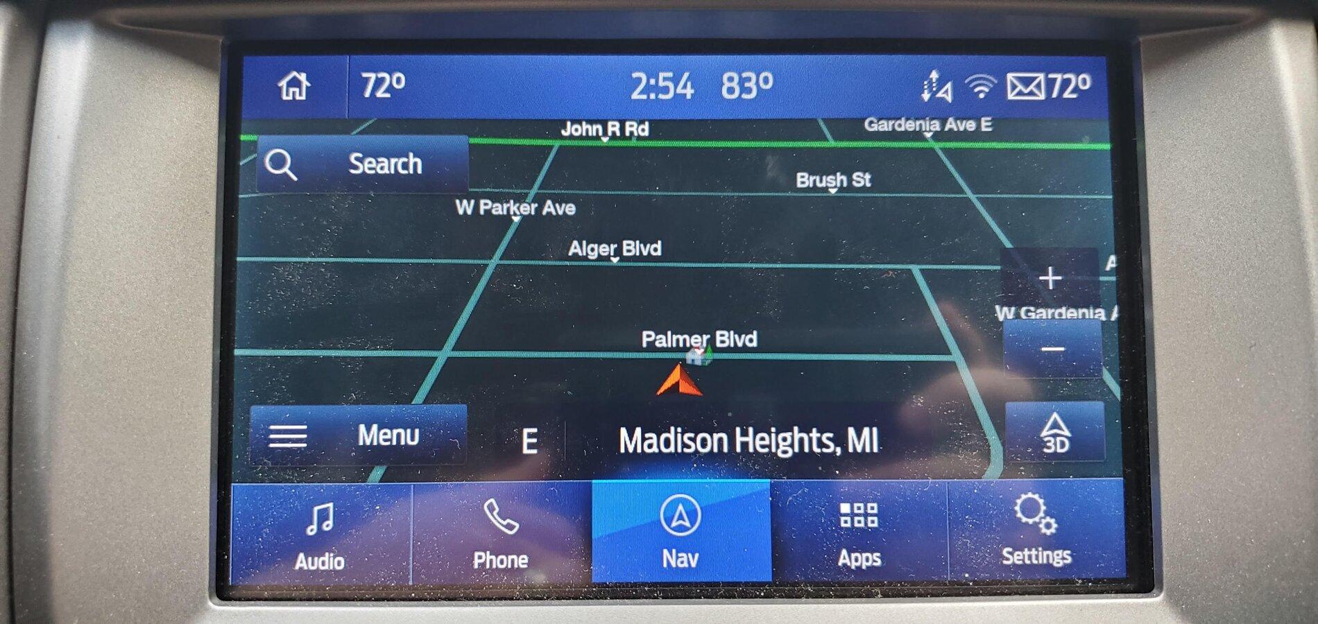

Got mine updated! Might end up leaving it in night mode all the time as I really like the all blue look, but I will give some things a try!
Sync 3.3 Build 19052 --> Sync 3.4 Build 20136
As for ease of update, my installation by USB hung about about 30 minutes and would not allow any radio information to display on the radio screen. I could not turn the radio on and the Ford loading logo would not display either. However the climate and backup camera still worked. Quick trip to the dealer and they refreshed the installation and it finished running with no issues. Dealer informed me that they see the issue I had a lot, so not sure exactly what caused it to hang, but happy with the end result now! And luckily my dealer is only 3 miles away to swing by real quick!
