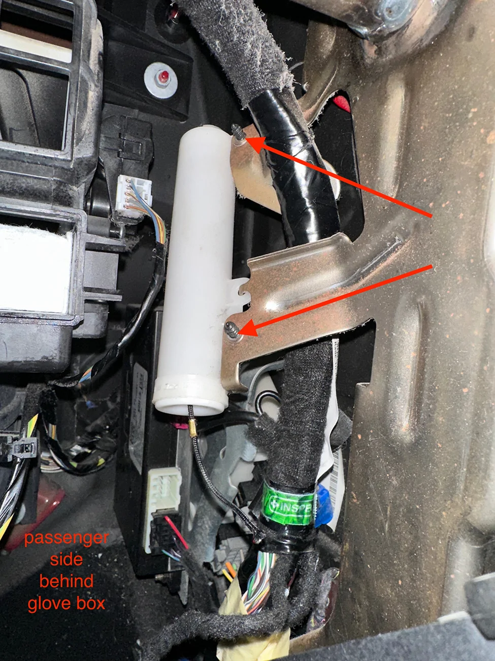

I need to replace the Glove Box "check" damper (KB3Z-2106200-A) because the nylon thread holding on to the glove box broke. There are only two Torx screws that hold the Check Cannister in (check screw - W502670-S303), but I can't figure how to get anything on the screws to loosen them- the heads faces the firewall, and there isn't any room between the frame brace and the firewall to get anything in there. Is there a special tool needed to fit in there to remove the screws?

Can you see up in there with a mirror?
I failed at getting my iphone up behind it to take a picture of what kind of screws are on the heads- I had no luck. I had a friend come over with a scope on a tube and that is how I got to see it was a Torx. My iphone has a thick case (Otterbox Defender) and that barely squeezed into that small space..
