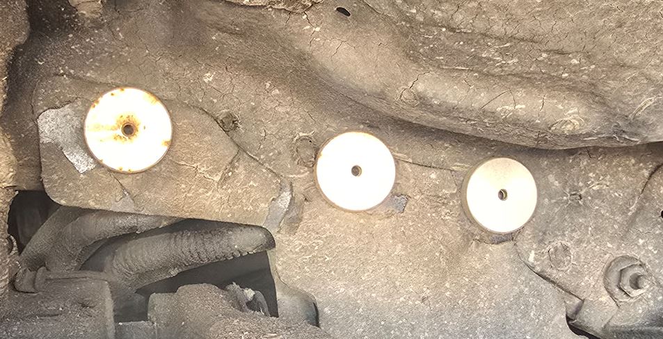

Magnets are mounted on the shield and I doubt with the strength of magnetism anything will move. Pretty happy with this solution.Will make changing my oil soon a little easier, perfect, thx all.

Impossible not to remember as they are attached to the liner. There is nothing to install. I simply line up the hole and the magnet does the rest, guided my the hose threaded on the screw. See the picture.
The hose (stud) correctly positions the liner and then inhibits lateral movement. The top is the beveled washer and screw, The underside is the magnet facing outward towards the frame, the screw is tightened onto the hose which holds everything together, and the hose fits perfectly in the frame hole.
Pretty innovative solution! Out of curiosity, why not leave the factory fasteners along the bottom edge, and only put your magnet/screw/small hose solution on the top 5 holes? I usually only ever have to pull the top 3 or 4 when I change the oil. I've never had to remove the lower fasteners at all.
Do you pull the whole splash guard completely out of the wheel well when you change the oil?
