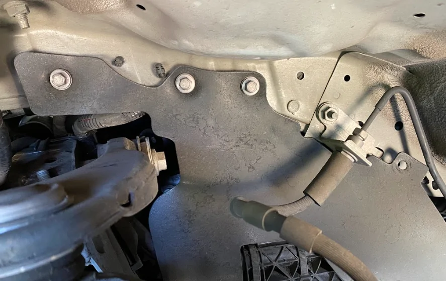

Yep, 2022 XLT Tremor, I just went outside and took a picture of the driver side, and I am missing a bolt............................

airline tech
Aug 24, 2022
4,508
8,603
Midwest - KS
Aircraft Tech
Yes my 2022 has the 10mm bolts as well, so yes Ford modified the way it attaches.
I think it’s been noted somewhere that the change occurred mid 2021 or so.

Odd. My '23 (bought new by me) has the stupid plastic clips and I need to change that out for my next oil change for sure! So if they changed to bolts, it looks like they changed back...
